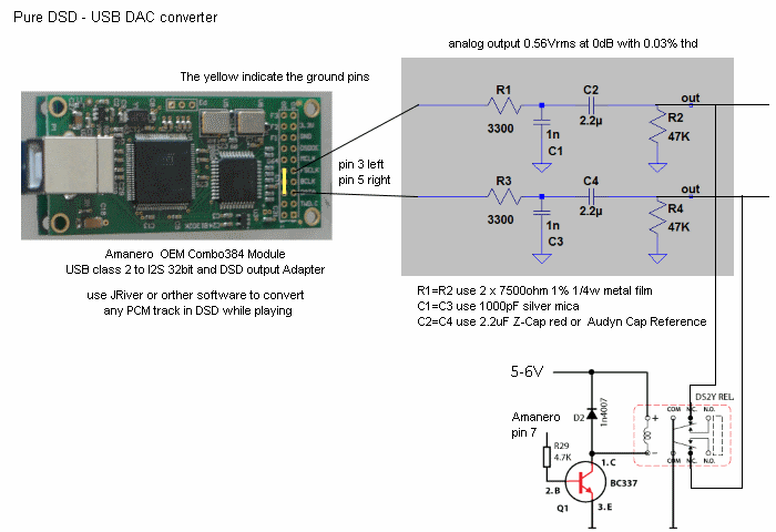

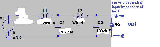

Attached the LPF I use first pic left.
I expected minimum the same output 0.56Vrms at 0dBfs as audiodesign web http://www.audiodesignguide.com/PureDSD/ 2nd pic right

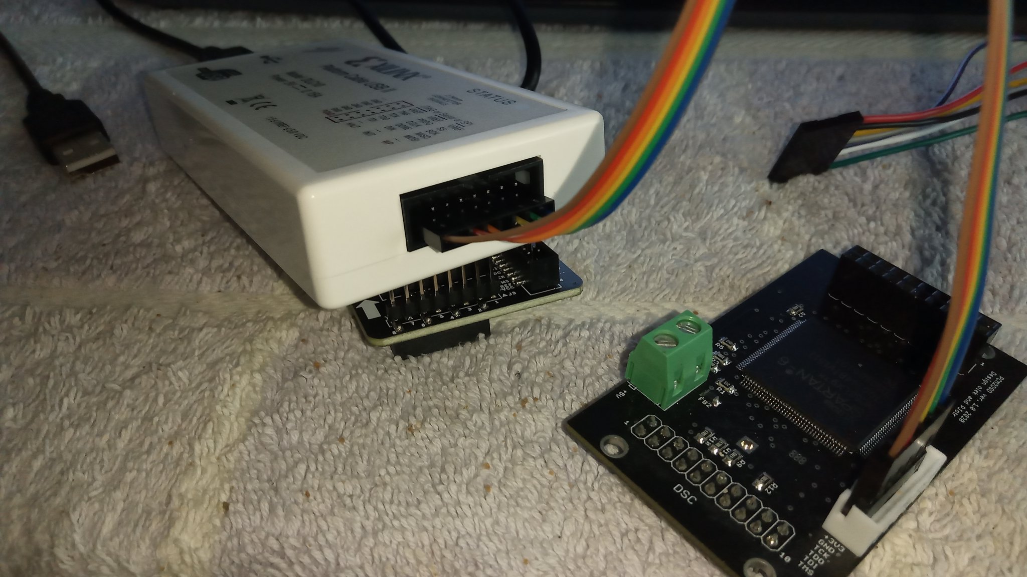

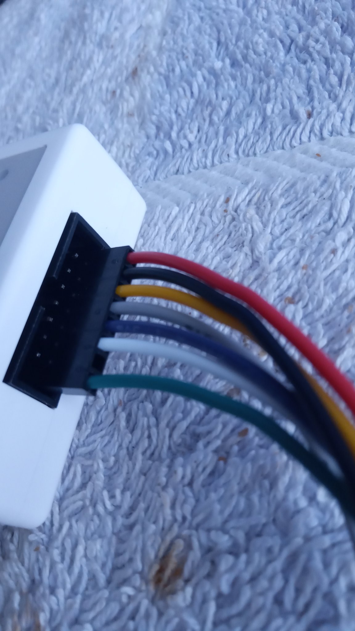

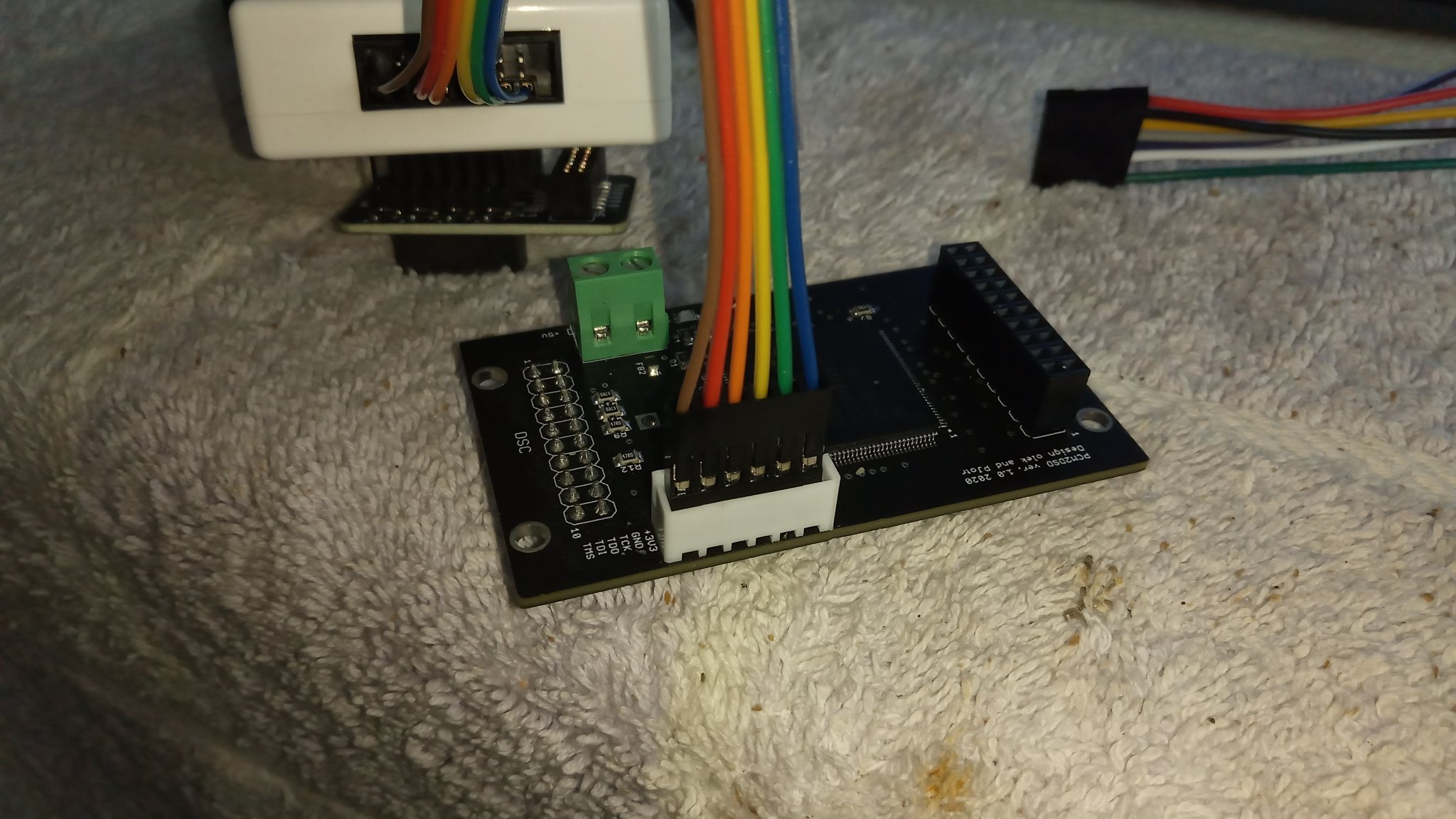

It's well connected?
Where is the Xilinxd license file & Lm license file?
I guess don't need to power the pcm2dsd because is powered by the USB port right?

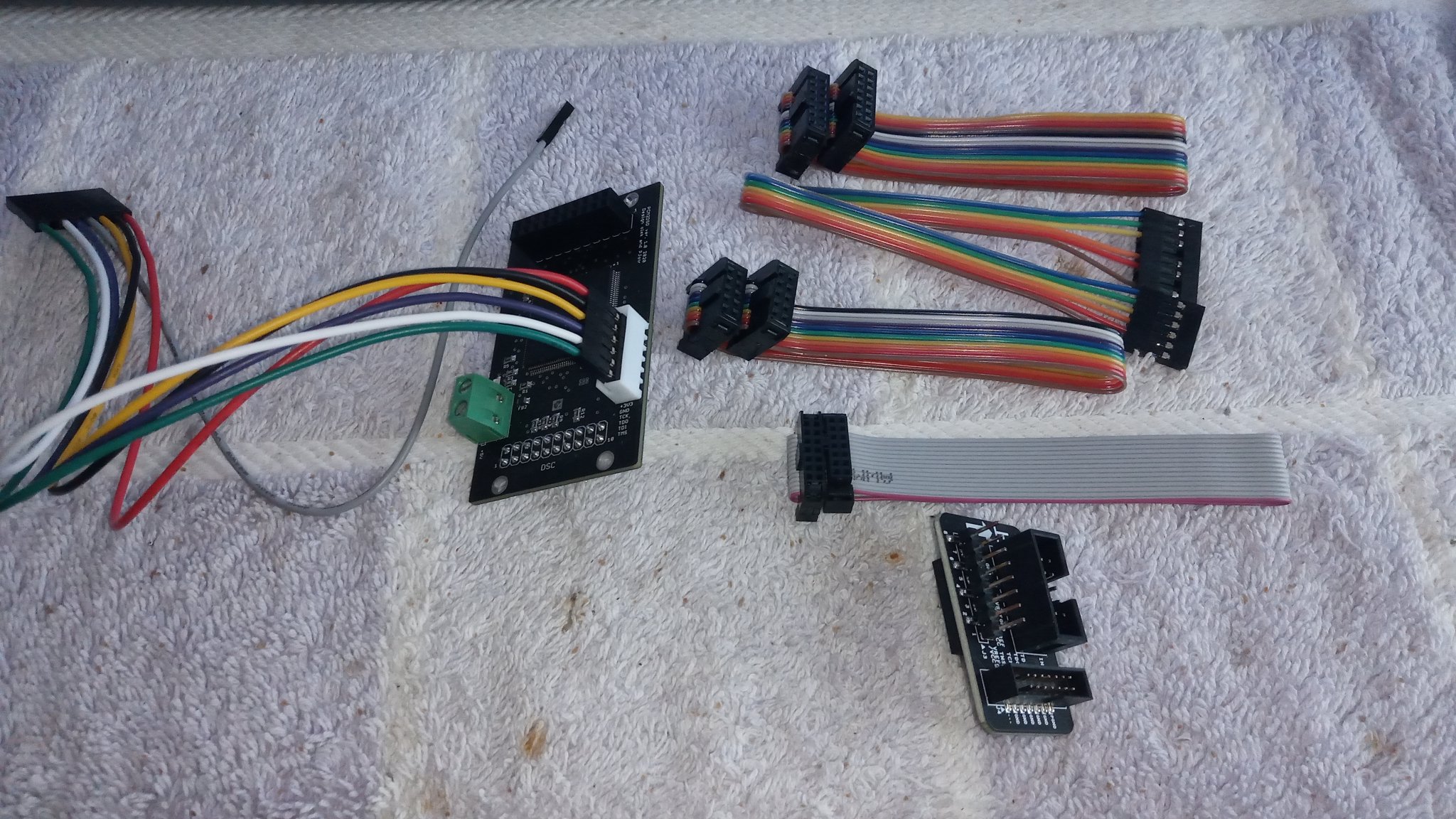

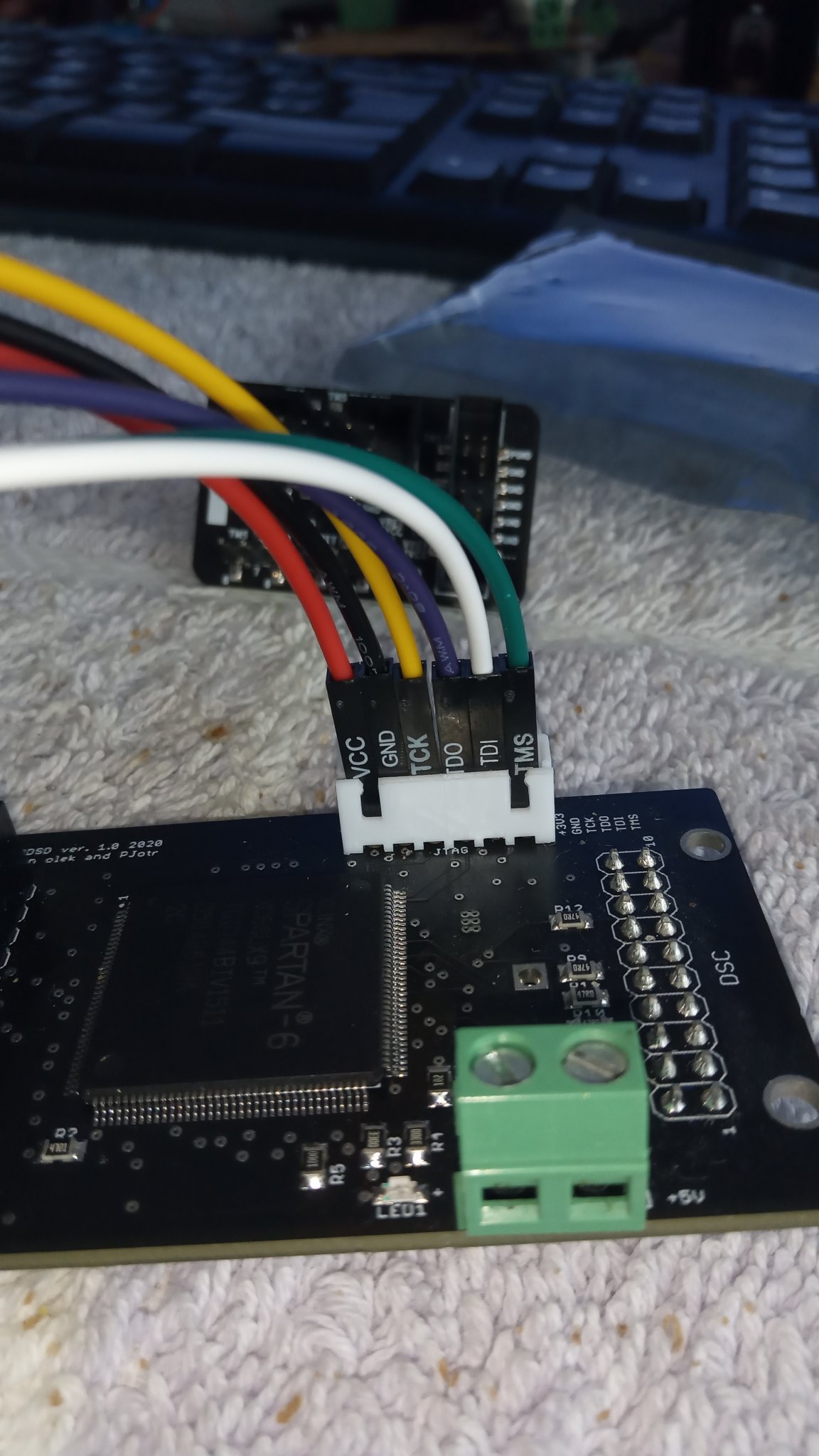

Simple DSD Converter needs +5v from somewhere into its power connector. If the LED is not on then it is not powered.
Also, that is not a proper I2S cable. It should have one ground wire for each signal wire. The ground and signal pairs can be loosely twisted together, or ribbon cable can be used with every other wire a ground. What you have there in the pic would be inappropriate even if it were only 1" long. Maybe helpful to remember this is RF, not 20Hz - 20kHz audio going through those wires. They wiring needs to be designed for RF use up to above 100MHz (if we allow for clock edge harmonics, which we should).
The Xilinx programmer uses a single row of wires, if that's what we were looking at in your pic. When you are programming the FPGA, you still need to supply +5v to the DSD Converter board so that the LED comes on. When the JTAG programmer is connected and talking to the FPGA and also connected to the PC, then its LED light should turn green, at least mine does.
Also IIRC if using the latest version of ISE, you don't need a license to run the Impact program. Are you trying to make it work in Windows or in Linux?

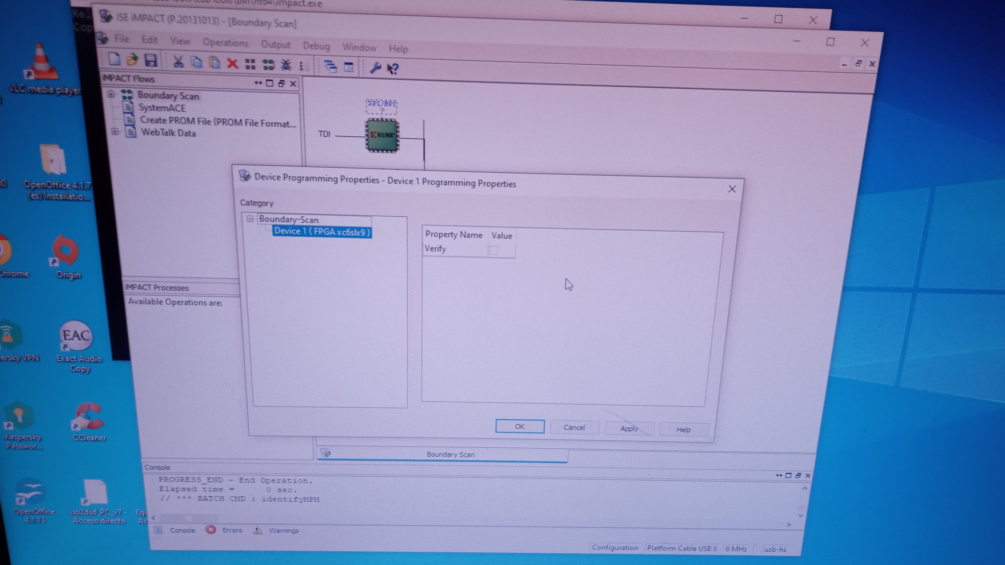

Once you get the right version of Oracle Virtual Box installed, and then install ISE and Impact in Virtual Box, then you will need to have on hand the .bit file you want to use to program the FPGA. First you need to use Impact to make an .mcs file from the .bit file so that the eeprom can be programmed using the .mcs file. The .bit file is used to program the FPGA. To get Impact to create the .mcs file you have to tell it the type of eeprom and its memory size. The eeprom chips specified for this project are I believe all 8MB capacity. In any case the eeprom part number will tell you the size.

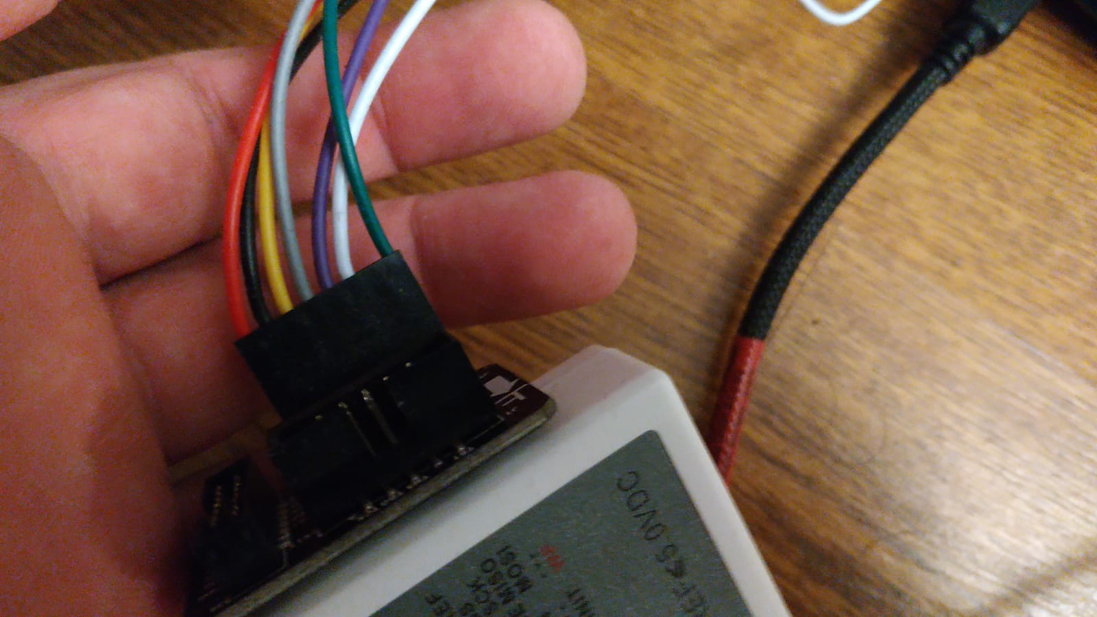

I would recommend you to use the adapter PCB because this is most secure connection, so connect it to Xilinx programmer, there is a single way to fit it there.
You can see on the adapter a single row of 8 pins, and you also have a cable which has 8 female single (monoblock) connector at one end with 7 wires only - this is for adapter side, take care about its orientation - and 7 individual connectors at the other end everyone having a name printed - these are for modulator side.
You have to power the modulator with 5 VCC and of course you should conect the programmer to PC via provided USB cable.

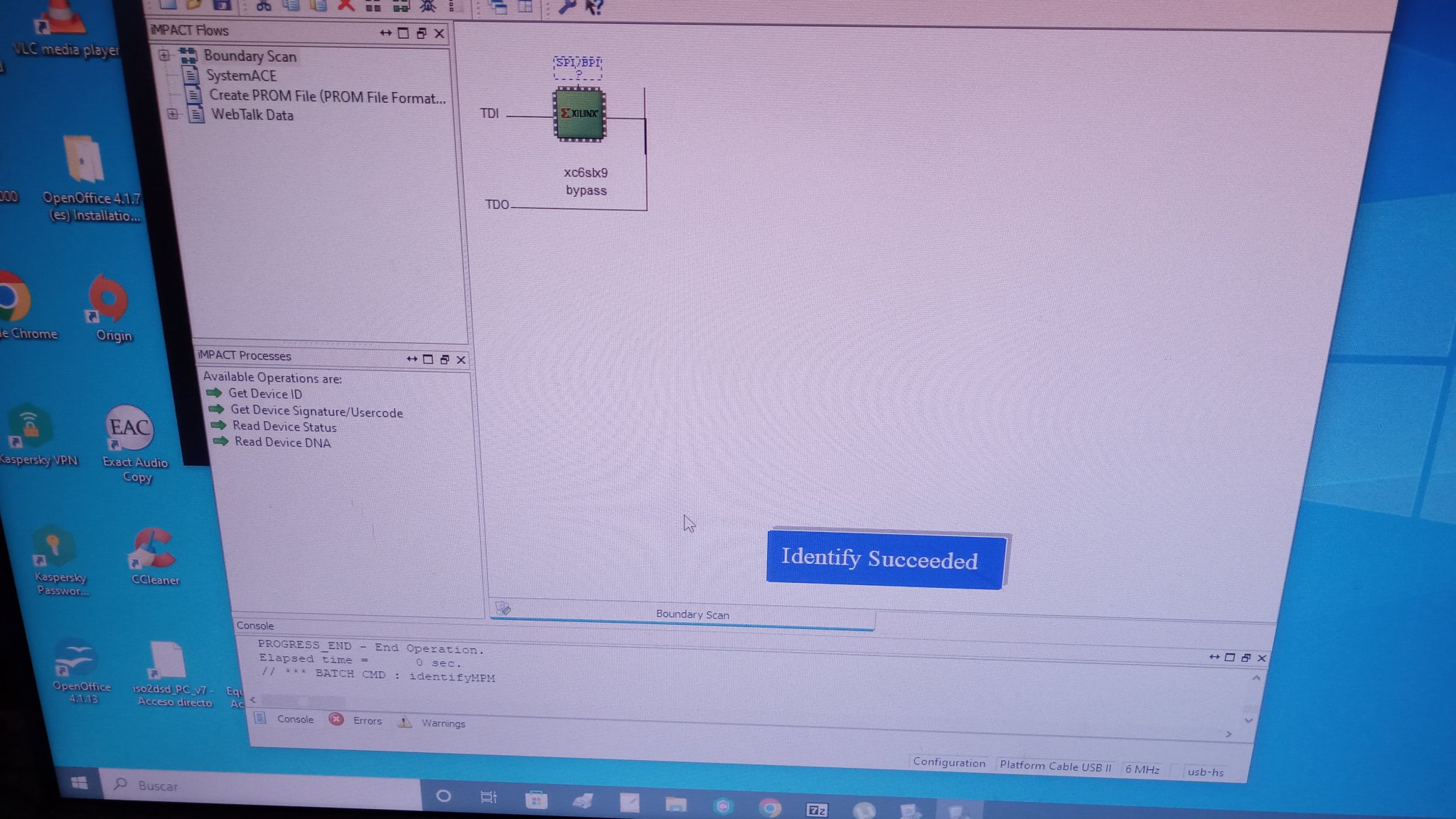

Run Impact software, then "Boundary Scan", then right click and "Initialize chain". You should see your XC6SLX9 chip.
If you are at this point, I can tell you how to write SPI flash chip. (I supose it is still M25P80, if not, tell me).
Checked, thanks.Looks okay for that use. Just check to make sure the pins have the same names at each end of the wires.
Okay, and you have the .bit file available for Impact to use?
If so, then you need to choose the option to create a PROM file (which it will do from the .bit file).
BTW once you have both files there is a Wizard that will take you though loading both devices, the FPGA, and the eeprom. Although you could probably go ahead and load the .bit file into the FPGA at this point. If you don't have the .bit file maybe you could burn it onto a CD that can be read from within Virtual Box?
