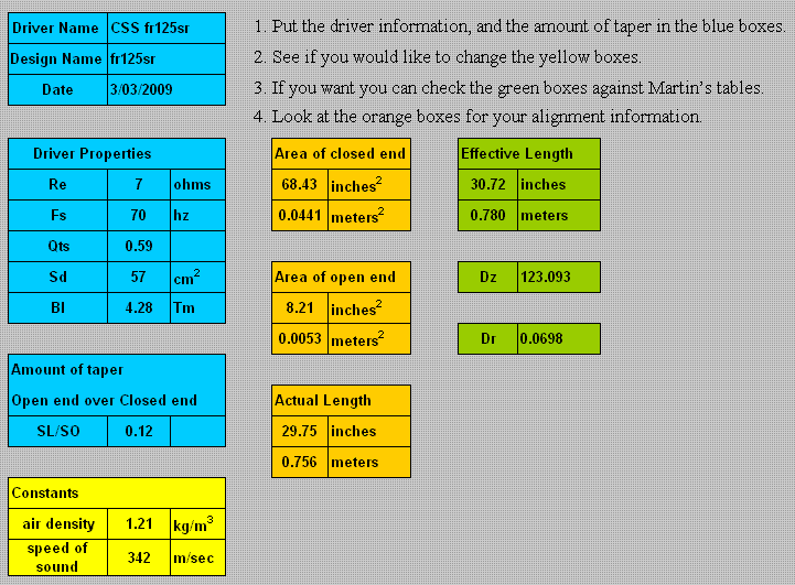

Hi Lon, check out the alignment tables here: http://www.quarter-wave.com/TLs/TL_Theory.html
They are for classic TL's (straight, expanding, tapered) with one end open, as opposed to MLTL's (with the port).

I had a successful load of the TL spreadsheet in Open Office Spreadsheet. Compatibility with free software is a big plus.

I put the values into the tables from Martin's site: (For the fr125)

Solve,
I hope you get your problem solved. For me it was just download the .xls file,
load, open and run the spreadsheet module and seek the file in XP. The color highlights and everything came up fine.
