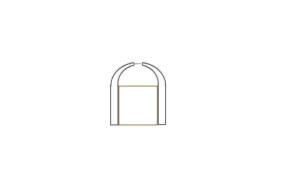

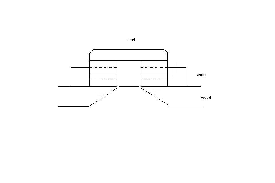

My present projects are a 15mm x 200mm and 8mm x 100mm, more or less
Still thinking about how to do the iron work...but I may have the wrong magnets fore some options
Man, there are some real heavy neos, and perfect fore small ribbon with very high sensitivity...but man, those are very strong and literally dangerous to handle
Be aware that magnetising orientation is very important, and determines to some degree how the iron is placed 😉
