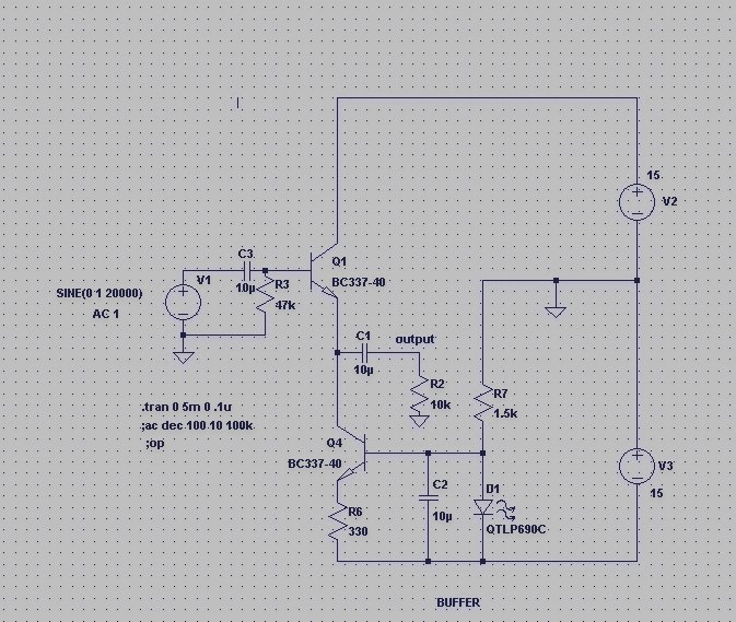

My friend Angshu designed this buffer for me, when I wanted a very simple unity-gain discrete buffer. His simulation runs show THD at -107dB with a load impedance of 10K. And PSRR seems to be -49.5dB on the positive rail and -53dB on the negative.
What do you guys think of this circuit? Angshu is quite a veteran of transistor based circuits, so I believe this will work pretty much as the sims show; neither of us has breadboarded it yet. I'll probably be using something like a BC550 instead of the BC337 he's used. I guess any high-gain low noise transistor will do just fine. C3 and C1 are for DC blocking. The output will have a DC offset of about -0.7V without C1. This is not a problem for me, because I always put input caps in the signal paths of my power amps anyway. And yes, I'll put a decent regulated PSU for this buffer; just bridge plus caps may not do, since PSRR is way worse than opamps.
Quite often, line-level preamps don't need any gain. Putting a volume control pot before this buffer should be enough to build an active preamp which can drive fairly long interconnects (10 feet?). Many of us need simple buffer-based preamps for many projects. And I need longish interconnects because I am building active loudspeakers, where each speaker has an active xo plus a set of power amps, in a chassis placed adjacent to each speaker. Thus, my interconnects need to go from my preamp (in a central rack) to each speaker. I am not sure passive preamps are a good idea with such long interconnects.
What do you guys think of this buffer instead of an opamp-based buffer? What should I be careful about?

Looks good to me.
Perhaps a 470R resistor between the base of the current sink and the LED, increase the cap to 100uF, but nothing more.
Purists might comment adversely on two coupling caps; you could run it without the input cap if the source was safe, but good caps will see you right.
Should easily produce 25Vpp with a Zout around 26/Ic; not clear what current you are running as the LED voltage is not clear. I would assume around 4-6mA.
Current delivery to load will be high on positive half cycle, but limited by the CCS on negative half cycle. There will be highish H2 at high loading.

I agree with Hugh; since you are running two power supplies, the input coupling cap is superfluous and can be left out. On the other hand, if you think you need it because you may have sources with DC, then you could leave out one of the power supplies without adverse effects.
Beware: simulation THD results very seldom have any relationship to real-world results, they are a trend indicator at best. Noting that this really is an emitter follower, how does the sim results change with say 1000 to 3000pF parallel to the load to take care of the cable cap?

Will do. Noted.AKSA said:Perhaps a 470R resistor between the base of the current sink and the LED, increase the cap to 100uF, but nothing more.
Yes, I'll leave it out, almost certainly. I just kept it in the schematic because that's how my friend had simulated it.Purists might comment adversely on two coupling caps; you could run it without the input cap if the source was safe, but good caps will see you right.
I'm stuck on this question; Angshu is out of town. Once he's back, I'll ask him to fill in the blanks. But I think the current will probably be around the range you quoted.Should easily produce 25Vpp with a Zout around 26/Ic; not clear what current you are running as the LED voltage is not clear. I would assume around 4-6mA.
What I'm really curious to know is how it'll behave with a load impedance made up of, say, 20K resistive plus the impedance of the 10-feet-long interconnects. I will probably be using RG58 or RG59 coax cable used for Arcnet or 10base5 Ethernet as the interconnect. What will that load be like? Does this qualify as "high loading"?Current delivery to load will be high on positive half cycle, but limited by the CCS on negative half cycle. There will be highish H2 at high loading.

You could also consider a diamond buffer of some kind. We have discussed it here quite much lately. A diamond buffer is real easy to get going and you wont need a output cap.

Oh yes, DC offset will be MUCH smaller (you can leave out the output coupling cap), the PSRR will be between 100-1000 times better, also the output impedance of the opamp buffer will be between 1000 and 10.000 times smaller, the distortion will be 10 - 100 times smaller. The opamp will also be more flat in freq response and a some other things. Still, if your buffer sounds OK to you, go for it.
I think it is somewhat misleading to call your circuit a buffer. It is not untrue, but it is better characterised as an emitter follower.

Thanks! Very interesting. I didn't know there would be such a huge difference in Zout, or the distortion. I thought most opamps (other than the top-end newer ones) have distortion figures worse than the 107dB that Angshu's simulation of this circuit had reported. So the distortion bit too is a surprise to me.janneman said:Oh yes, DC offset will be MUCH smaller (you can leave out the output coupling cap), the PSRR will be between 100-1000 times better, also the output impedance of the opamp buffer will be between 1000 and 10.000 times smaller, the distortion will be 10 - 100 times smaller. The opamp will also be more flat in freq response and a some other things.
And come to think of it, if the primary purpose of my simple buffer is to drive long interconnects with low Zout, and an opamp will have much lower Zout than this circuit, I guess I may as well revert to an NE5532-based inverting buffer. 🙂
I'm not trolling for flames here, but if this circuit indeed is beaten so thoroughly by any decent opamp, why don't people simply use opamps to make preamps? Why do people bother to make discrete preamps at all these days? I was under the impression that simple discrete circuits can have inaudible levels of distortion, hence the continuing romance with discrete circuits. Now I'm confused. Am I then to understand that discrete preamps is a "taste" thing, like valve amps with their 2% distortion?

Well, I don't want to start any war either but you yourself said you wanted a simple buffer. That's what you got. You didn't ask for a high precision, wideband, low distortion buffer.
And you asked for the measurable differences, which is what I gave you.
As I said, I don't know the audible differences, if there are any. Your circuit may well have inaudible distortion, depending on the rest of the system. Unfortunately, there seems to be no agreement on what is "unaudible distortion". Some people report that the simple circuits sound "more musical". Again, I haven't seen any definition as to what that is. You really are on your own here, and that is good, because you are the one who has to listen to it. If you like what you hear, why bother with those 1000 times lower THD of the opamp?
But, you asked the question! Don't ask it if there is a chance that you don't like the answer!

Why do you think that is, and how might you verify it? Given that audio is based so strongly on subjectives, and there's a lot of folklore, what are your options?
Given that you have made a seminal comment about Randy Slone's two decades of experience, and likely ignorance about a few issues, it should be obvious.
You must build it. Then you must listen to it, preferably AB against your beloved 5534 preamp. Then you should invite in friends, and perform the same test on them.
After a couple of heavy listening tests, confirmed by others who understand roughly what to listen for, your hunches will be confirmed one way or the other. You will KNOW!! And you may find that the vanishingly small distortion figures and high specs of opamps are ambivalent; they don't really complete the picture, and in some ways are inconclusive.
If you do all this, you will be assessing your 'product' as the market does; 'How does it sound?'. It is the answer to this question which sells high end. People mostly insist on an audition, so in their heart of hearts they don't much care for the specs.
Hmmm. Wonder why that is?
Hugh
I have tried different kinds of follower circuits, measured and tested sonically. The simple follower shown hereabove is only simple, that's all. Good as a starting project for newbies, but do not expect any miracles. Peranders is right, better give a try to some kind of diamond buffer in case that you want to achieve excellent results.
