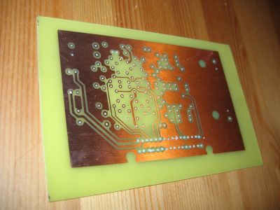

I ditched the idea of doing a quick and dirty prototype with all BC550. I will have to do listening tests and "fine tuning" with the final transistors anyway, and I'm pretty sure the topology works.
Having made good experiences with an all Toshiba transistor set in my last power amplifier, I setteled on the following devices:
2SC3329 / 2SA1316 for the "diamond buffer" part
2SC2705 / 2SA1145 for the rest
2SC4793 / 2SA1837 for the "output stages"
Toshiba Datasheet Search
The Europeans do the '92 package the other way round, so I'll have to rework the PCB...
Prototype PCB finished today:
