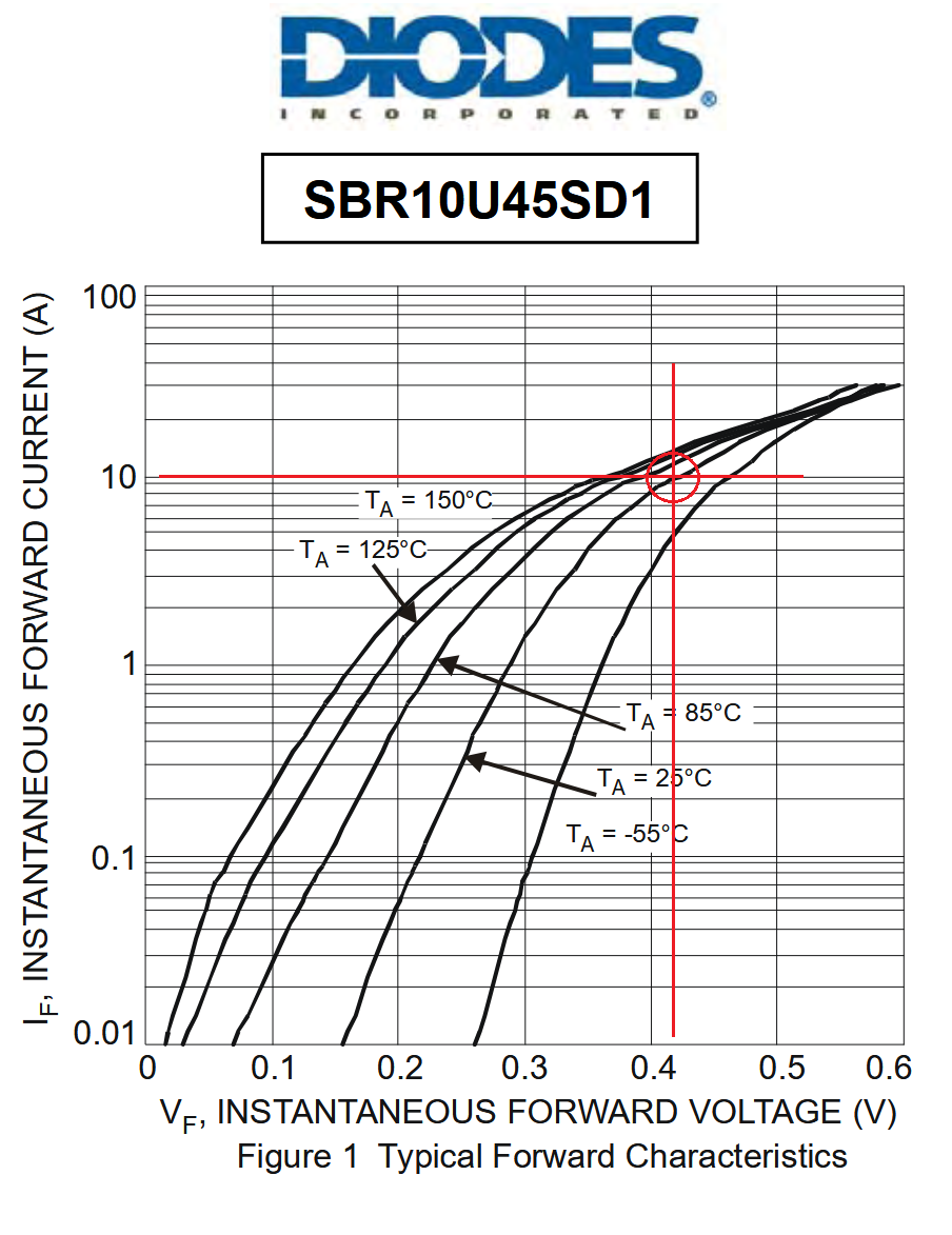

I simulated your circuit using a similar Schottky diode (10A) since I didn't find the 1N5828 model.
I had to consider transformer VAC=12V (17.2peak) to get 10V at the load - not sure why it doesn't match your simulation.
If you can measure the transformer primary and secondary resistances, we can try to get a better approximation.
We also need the nominal primary and secondary voltages to calculate the winding ratio so as to reflect both resistances in just one.
These are the results supposing the circuit described below using 50Hz.
Diode individual average power dissipation (each one): 1.82W
Diode peak current steady state: 12A
Diode average current steady state: 1.6A
R1 power dissipation: 9.1W
