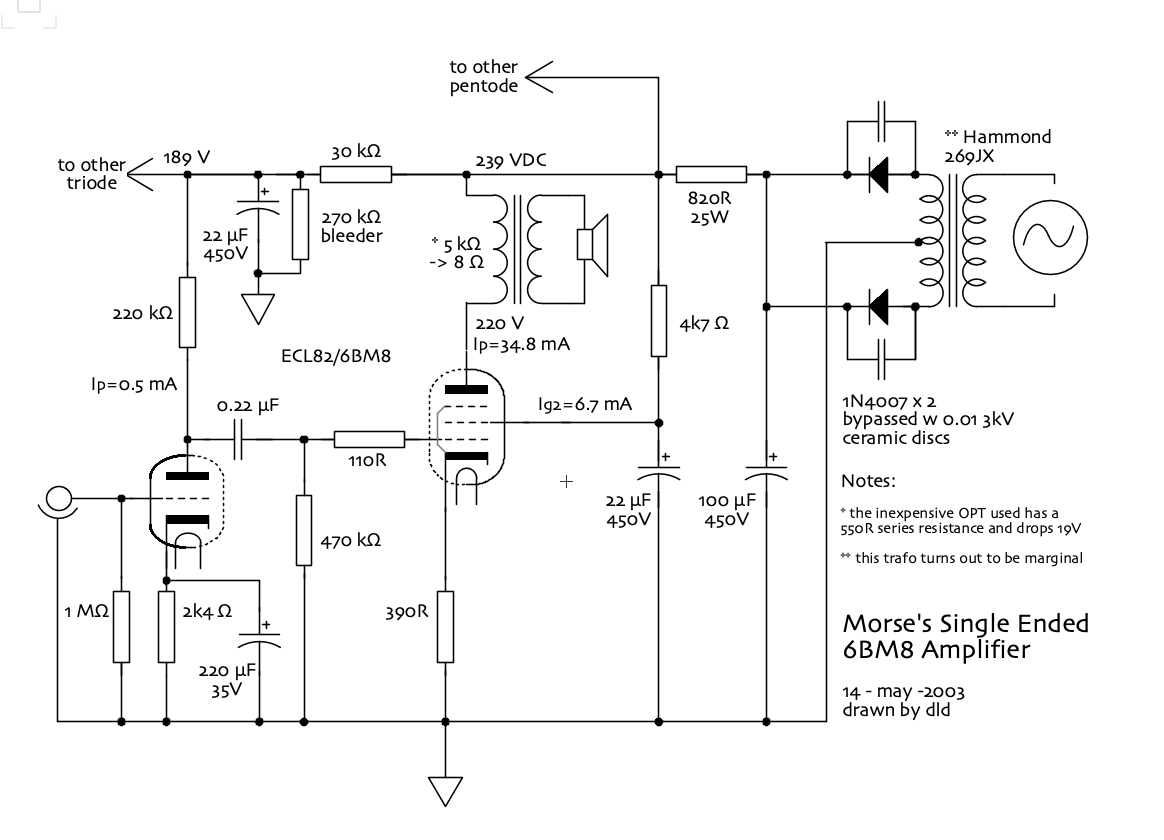

create the simplest EL34 Single Ended circuit I can
Likely already been done here.
An SE EL34 will need a driver tube, the PS will likely be the most complex bit.
I haven’t designed a lot of amps, but i have drawn the circuits of many. Ignore the labels, a simple SE amp will look much like this one.
You might be able to lose some parts, the tube gurus can suggest potential simplifications.
