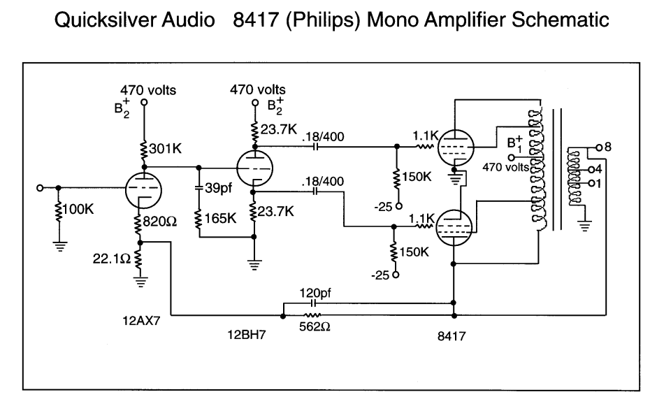

Looks pretty simple to me. I like the beefy plate 'BH7. The draftsman should check his thumbs!so, yes, I’m going to start with a simple, simple, circuit design, and go from there…

yea, I’ve looked at that design, many times over…. I plan on designing a single ended EL34 amp.

Can you tell us what's wrong with that design in post # 12? The catasthrophic error ;-)yea, I’ve looked at that design, many times over…. I plan on designing a single ended EL34 amp.
