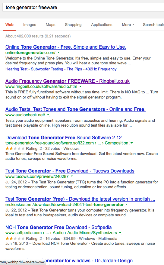

I wanted to quickly test some drivers just for basic working condition. I dont have a method of simply generating a particular or restricted frequency/range. perhaps that is the direction I need to go.

There are a variety of free tone generators available.I dont have a method of simply generating a particular or restricted frequency/range. perhaps that is the direction I need to go.
I like this one best for simple things (except when it doesn't work with your soundcard): NaTCH Engineering - SigJenny an Audio Signal Generator for Free

For a tone generator you might go for Audacity that also has recording and playback functions, or perhaps you already have such recording software. If it's half as featureful as Audacity, it probably has tone generation functions. I mainly mention this because I'd rather have a few bigger apps that have all the features I want rather than having many small single-feature apps.
