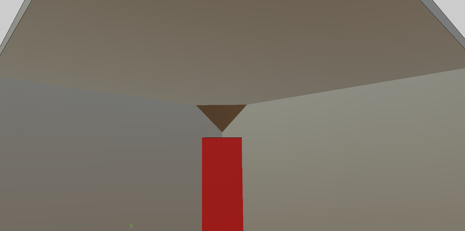

thank you for your sketch, very clear. I was thinking about something like in the sketch below:
Each speaker is composed by four straight panels:
  • the front rectangular baffle (that is partially used for the smaller part of the horn, partially for the bigger one;
  • two triangular baffle that have at the same time the purpose of creating a "pyramid-like" small horn with the front baffle, a dual bigger horn with the vertical walls of the corner, and bracing the front baffle;
  • one triangular deflector on the corner of the ceiling.
This way I will use the room as part of the horn because:
  • the floor is part of the speaker as it reflects the sound to the "split" second part of the horn;
  • vertical walls are part of the sound as they are part of the "split" second part of the horn;
  • ceiling thanks to the deflector is part of the third part of the horn together with side walls.
Is my explanation clear? Has anyone tried anything like this? I though about something easy to be built.
So you say the sound goes down to the floor then up to the ceiling and out into the room, also the driver at the start is a little offset from the start of the horn? If so then I think I can see it.
Yes, it is exactly as you described. From what I read, the benefit is that there are no parallel surfaces for resonant waves, it seems quite simple to build because there are only four panels, the hard part for me is design it!

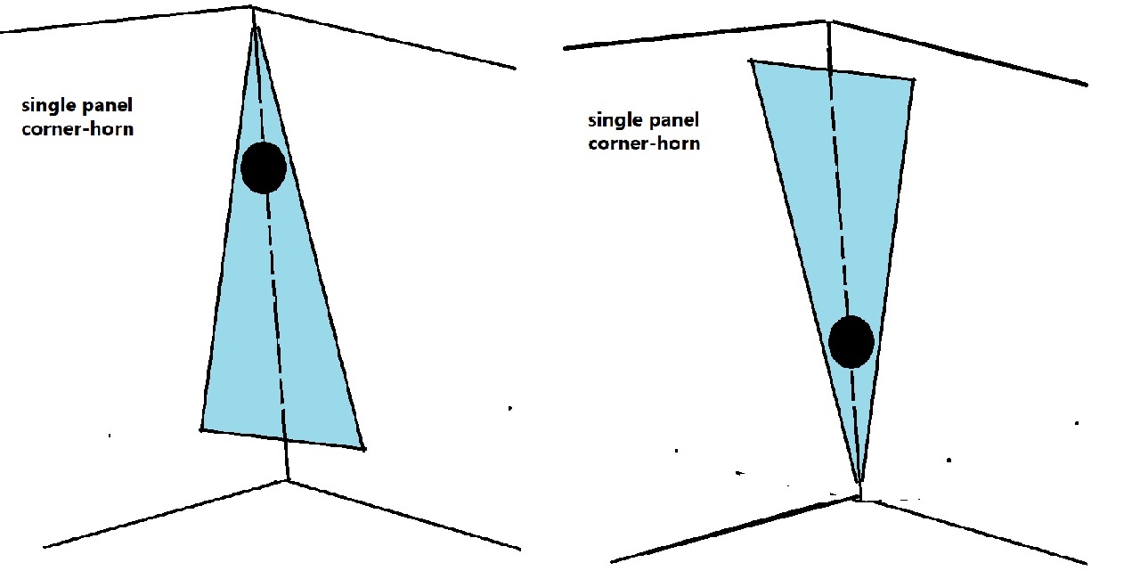

Such as ? I mean your plan was to close a corner with a panel at 45 deg and we've posted some of our 'adventures' in corner [TL/horn] loading, but to date you've only asked more questions, so till you have another plan there's nothing to potentially 'improve'.
Hi GM, not really. I've never proposed to close a corner with a panel at 45 deg:
On post #41 I've proposed a folded horn (ceiling-floor-ceiling) with the speaker offset at 1/3rd of its lenght.
On post #45 I've explained how I've imaginated it.
On post #47 I've attached a basilary hornresp file of what the horn should be.

I used CAD to make a cross section of the expansion of the room corner (EDIT: equivalent to if it were round for hornresp), and shown this here in blue.
I chose a mouth size that is a portion of a wavelength below the vocal range.. although as you continue to model this you'll find it isn't the only significant point in fitting the horn.. the shape of the room expansion does a bit of the talking. The room is not necessarily the correct termination for each horn type, so I have set hornresp for eighth space loading which should approximate the difference as you continue to model.
The first red line is meant to approximate the distance down to the floor and back toward the corner, and the next red line would be where the ceiling part of the horn cuts in.
I didn't necessarily expect the length to be the best option and was going to try one less fold (or one more)... but this seemed an OK place to start. I also didn't see much in changing the compression ratio from 1:1 to 2:1, you may have a preference there.
