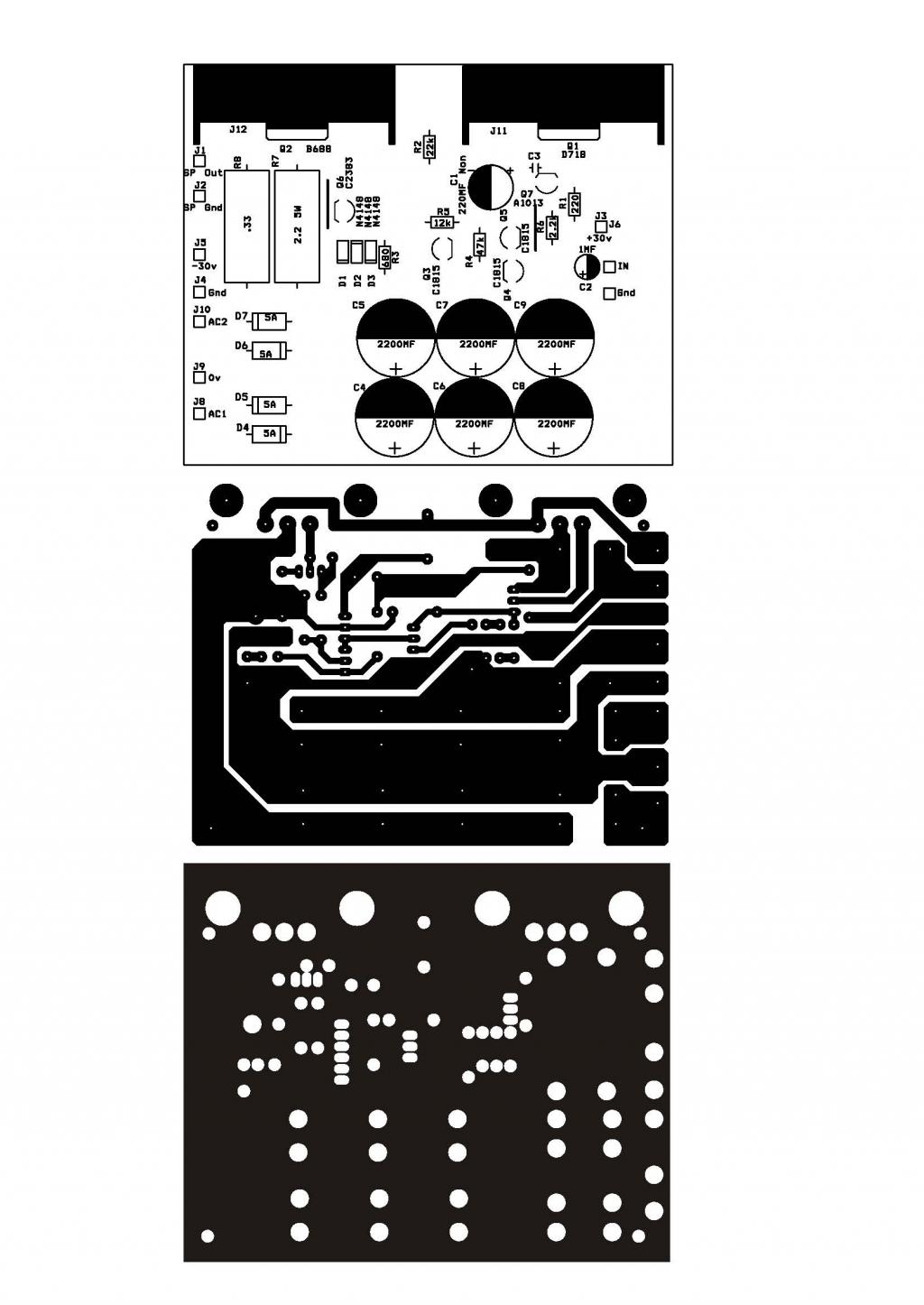

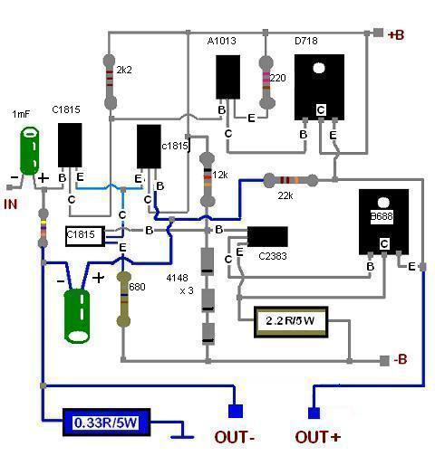

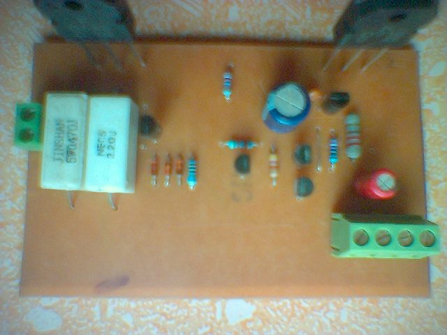

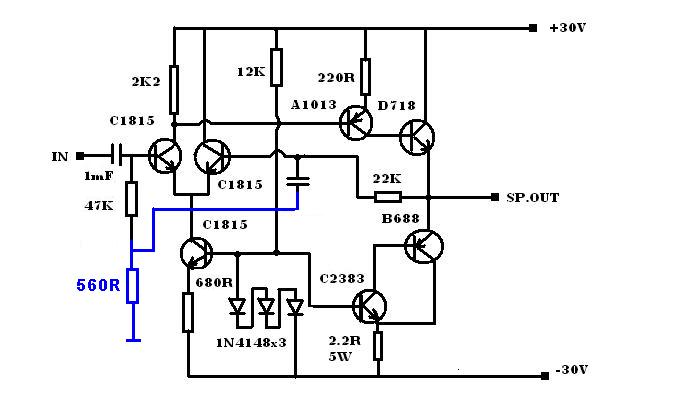

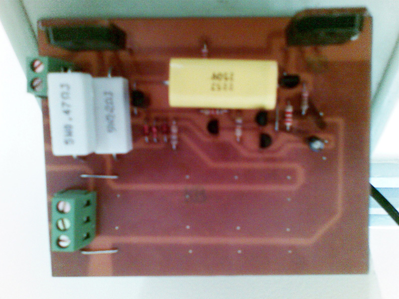

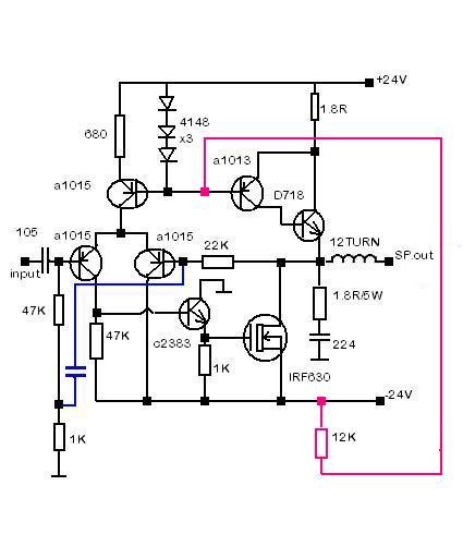

Last year I was design two classA power amplifier circuits, the sound so good and easy to make them.
I am come from Vietnam and speak English very bad.
There are my schematics:
