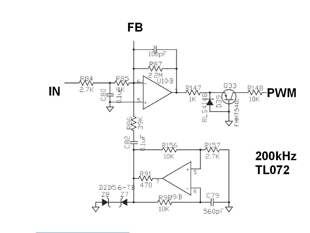

I did, and it was a mix between a triangular wave and a sine wave.
You can try triangle oscillator from JBL 200kHz with single OP (1/2 TL072).
My plan was to use a 50A 600V IGBT module for the output stage, i alrready tried this an d on 2x38VDC and 500kHz, the module with no heatsing only got slightly warm, the audio part dident worth though as i tried it with transformer coupled gate drive.
I'll resume the work on this this weekend, and i will socket the IR2110 so it can be easily replaced when needed.
