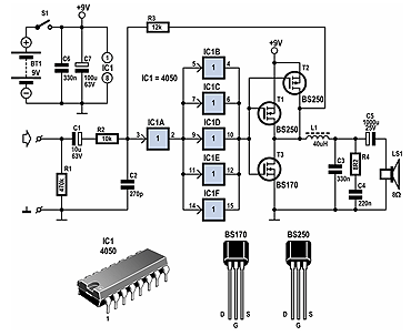

Heres one i made earlier, it has been built and tested and works with some tweaking and the correct components. I suggest using a voltage comp for the switching sections.
This circuit gives a power output of
(15 / sqrt 2)²/8 = 14W into 8ohms
:. 28W into 4 ohms.

Class D amplifers have two sub-catorgories; Carrier based and self oscillating. Carrier based usally use a triangle waveform to pulse width modulate the audio signal. Feedback can be added with degrees of success. Self-oscillating amps rely on some sort of positive feedback to achieve modulation. The UCD or SODFA amps are examples of this.
If you want something simple in concept try a PWM amp without feedback. Later if you wanted feedback could be added. More challenging would be a DIY UCD. The topology is almost unparalleled in terms of its component count simplicity but is more diffcult to understand.

Here's a DIY UCD that should get you up and running with some minor tweaking.
http://www.diyaudio.com/forums/showthread.php?s=&threadid=55385

Corvus, don't even think of looking at the dreadful X10 circuit! It's very simple to make a UCD-style amp using simple components. Look at the UCD reference circuit in the Philips/NXP application note. This circuit doesn't have the performance of the Hypex designs, but it is still likely good enough for you to be impressed by what such simple circuitry can do.
Thank you for the tech tip about the Philips UcD Amp ... but thats really nothing for me (Layout absolut critical around the MosFets and so on i read in some threats). I am not able to do that PCB and SMD work in my small kitchen.
I am just looking for a small class D amp circuit in the 5-10W class like the Sinclair Z-12 - only with discrete components made. It is NOT for HiFi purpose - only to understand how the basic princip class D can work ... or not ;-).
This small 1.5W 9V class D amp i tried is too complex for me - i constructed it twice in "ugly design technique" and it will not work.
Plz help me with the Z-12 circuit or so ... (that piece would be commercially sold, i think it will work on a fair level)
