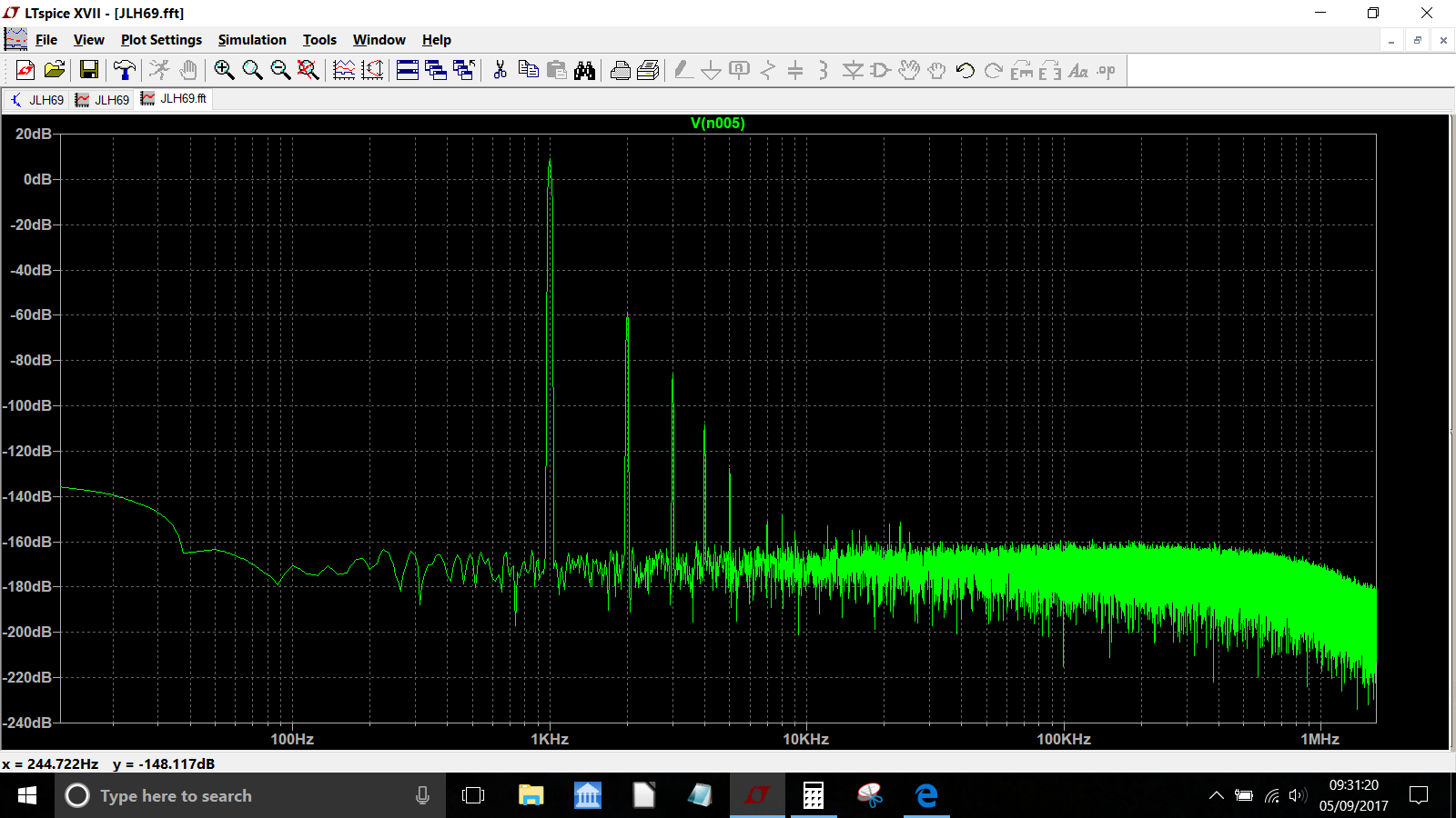

JLH 1996 Class A
Originally I simulated this with the transistors that Linsley-Hood employed using manufacturers .models. I have since changed the transistor complement to fit the .models by Cordell whose tutorials I followed for THD testing at 1kHz and 20kHz. I still have 2N3055's in my amplifier.
I have left the electrolytic capacitor values at or close to the values used by JLH and taken the liberty of changing the input capacitor value to 10uF.
In this I departed from the dc simulations in Cordell's tutorial and made no attempt to get close to dc response by increasing the values to the extremes necessary.
I found it easy to fit the two simulations in the one file by leaving the relevant commands on screen with those de-selected by changing the status to comment. The distortion figures I noted in comment blue are those not in brackets in the SPICE error log.
Distortion results are one thing however the relationship between the harmonics is what interests me in the FFT results.
The input signal levels are to match those I used in the JLH1970 original AB circuit and my simulation of a modified version with some changed/added circuit elements.
I will post the other simulations after seeing what comments are made either on the results or validity of my test method.

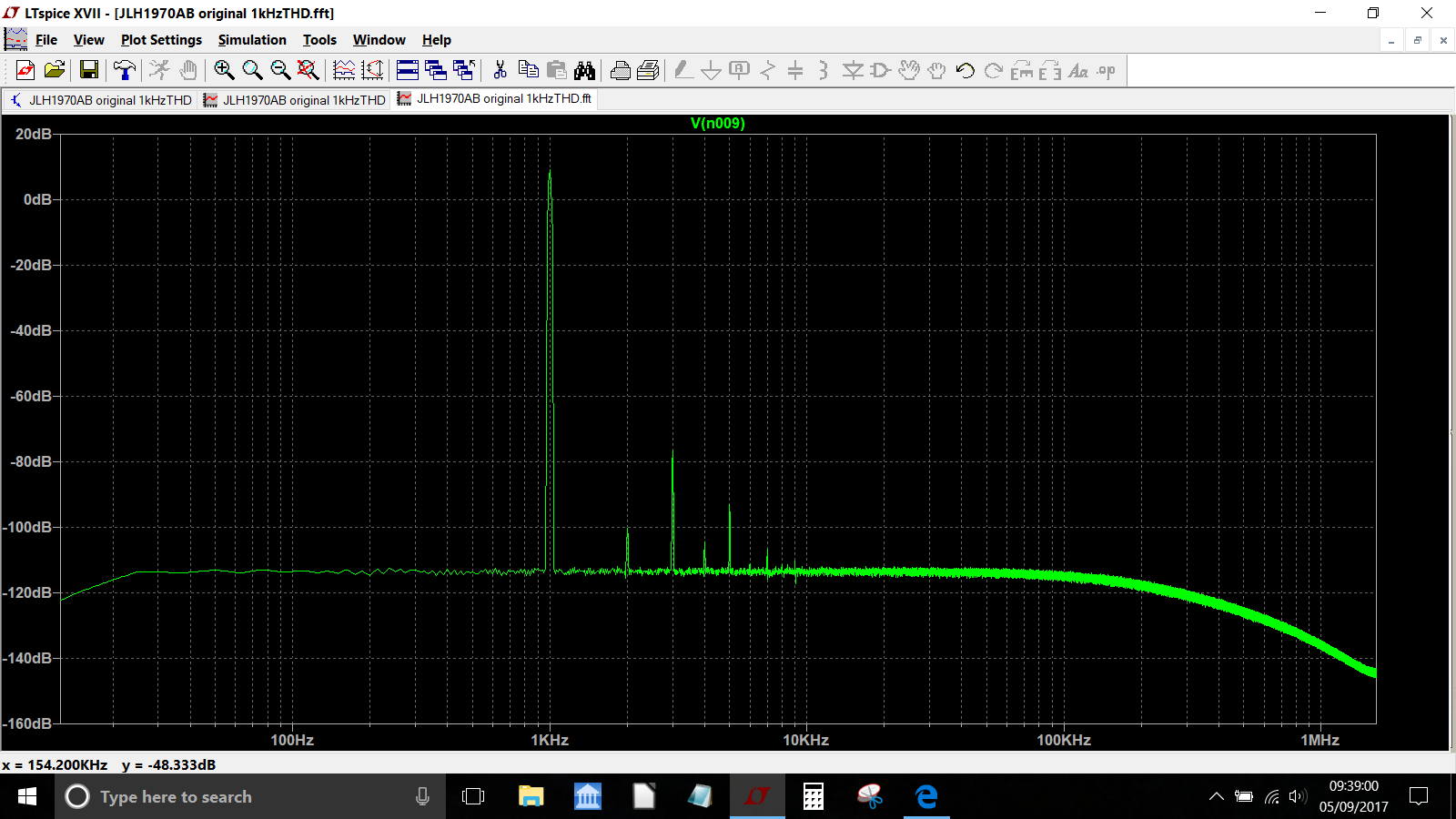

No feedback comment yet, but some views, so hopefully I have not strayed too far off the beaten track - I did this on my hour's bush-walk this afternoon and having travelled half way down from the top of the hill to find my perceived short cut came to a dead end I had to scale back up to the top again to find my way back home.
Anyway I am posting the simulations for the original JLH Class AB with some more modern transistors in the complement. I doubled the value of some electrolytic caps in these simulations. In some FFT results the magnitude of the third harmonic dominates with the level of standing current recommended by Linsley-Hood.
This posed the question of is this as good as it gets or is there a sweet spot with some other level of output stage standing current. There are one or two things that could be changed in this circuit towards that end. I'll save these for my next post.
  • JLH1970AB original 1kHzTHD.asc
  • JLH1970AB original 20kHzTHD.asc
Administrator
Joined 2007
Interesting. The JLH1970 looks to good :) but the 3rd harmonic does dominate as you would expect. The JLH69 is pretty much as expected with relative high distortion by modern standards (but we all know how good it sounds). The JLH69 was from my own sim and running 1.2 amp bias with a 27 volt rail.

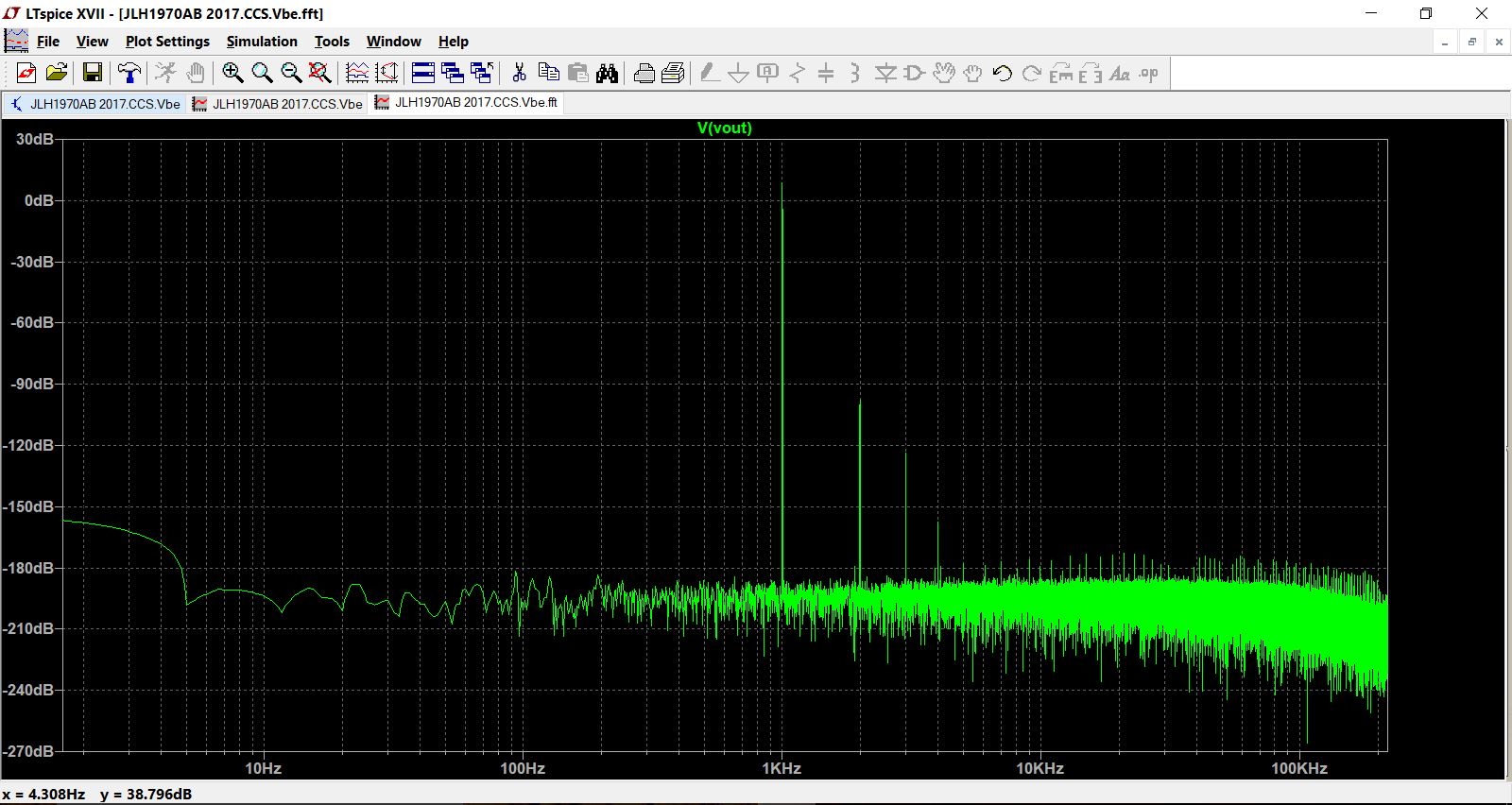

2017 Revamp
I changed the original circuit to run from split supplies of +/- 24 volts in a similar way to the 1996 Class A amplifier and substituted a Constant Current Source for Q3 Bootstrap Collector load.
Simulations indicated the 47R resistor collector load for Q4 was not necessary.
In the first instance the CCS current was roughly 6 m.A. but more is better so I gave that a boost.
I tried various biasing methods for the output stage - wire wound pots are a bit expensive so I tried resistors, diode resistor combinations which would be cheaper but less flexible.
This led me to consider using a Vbe multiplier which resulted in an unexpected improvement over all other bias arrangements. In this the second harmonic dominates in the FFT plots.
According to Linsley-Hood in 1996 contemporary thinking was all harmonics should be less than 0.02% although 2nd harmonic is probably undetectable below 0.05% so I feel satisfied with what I see from these simulations - indicative only as these may be.
The transistor complement apart from the output devices is humble and these should be readily available off the shelf from retail electronics stores. I have tested at other models in Cordell's library and these are my choice.
R4 and R15 will need to be made up from a combination of a resistor and trimpot.
There is a little more complexity with this circuit than the original which should still be good and safe enough for first time builders. An output capacitor obviates the need for a dc protection circuit which will increase the costs.
There is some room to modify the original JLH circuit to include the Vbe multiplier circuit for a better result and to change some resistor values in the bootstrap collector load of the Vas - albeit that the inclusion of the 47R collector load resistor of the driver transistor in series with the bootstrap is a complicating factor.
The current drawn by the bootstrap/Vas is low (2-3 m.A.). While adequate to drive the high gain MJ481/MJ491pair the MJL pair has a lower current gain so the best is not being made of their capabilities - I had expected a better result in my simulations.
Others may wish to explore this - my inclination would be to recast my direct coupled circuit for single supply use.
  • JLH1970AB 2017.CCS.Vbe.asc
Hmmm :)
Just tried like for like to compare with the other FFT above.
Oops! I don't know how but somehow the 8R load went missing in this simulation. That changes the picture of the FFT which is not quite so rosy - my face is red.
There is no real difference now if the output standing current bias is set by a vbe transistor or a resistor.
