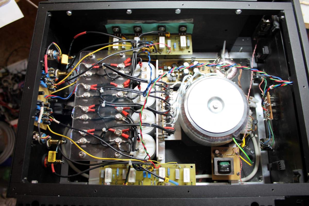

Finally I decided to make this Juma circlotron and I can say that this sounds really great. At first it was a little problem with the layout of the wiring and unstable DC offset and the current through the output MOSFET. Now everything is stable and is a great pleasure to hear the presentation of the sound of this amplifier.
I am very pleased and grateful to the constructor on the project.
PS. Cubie will wait a while to build.

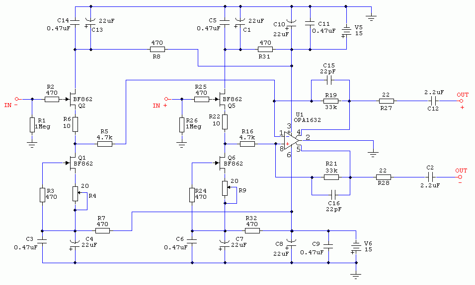

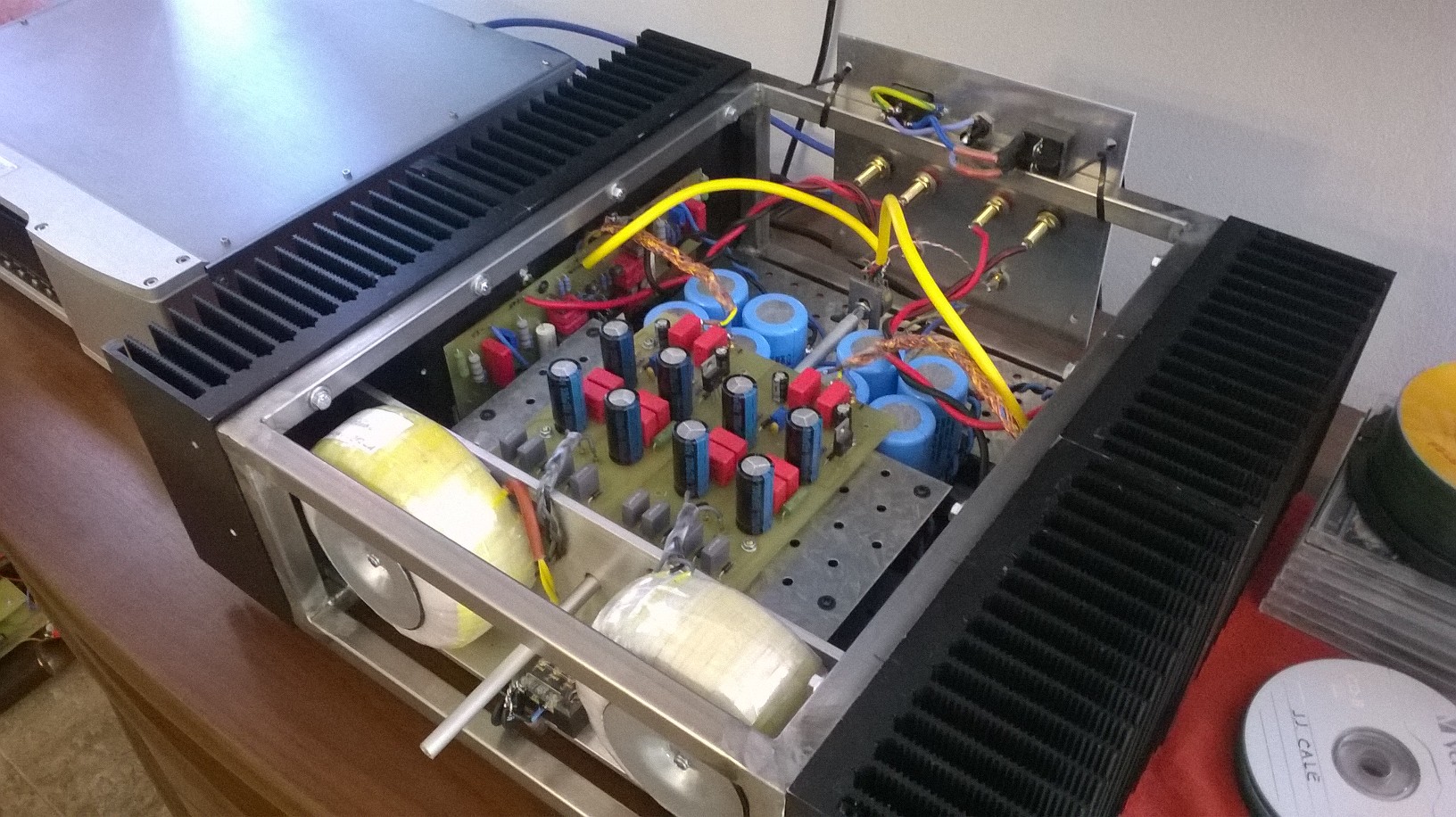

I'd like to add a small contribution here. Built one of these but as a completely different beast with E88CC in gain stage instead (with a lot of help from Juma and Zen, to be noted) and later needed to figure out is there any difference in sound between the original and the hybrid version, so, built one more, this one, but as I didn't want SE on input, tried a bit different approach. It works fine (huge understatement) but I usually say "fine" when I can't find anything that would bother me. On the attached images the fulldiff sch. of the gain stage, one messy image of the amp and where it's used. This amp is the black one at bottom with the big VU meters...

It should work with P-channel JFET (J271 with inverted polarity for buffer cell) but I'm not sure if it's worth the effort - lower gm, wildly varying Idss, different transfer curve....
You'll have to test and experiment a bit...
