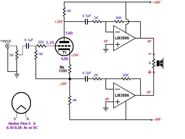

that bridged circuit may destroy your 3886 amps.
I see +-40Vdc (+-variations due to mains supply) and an 8r0 load.
Each 3886 is effectively driving a 4ohm speaker load from the +-40Vdc supply. This will overheat the chips.
Look at the page 14 graph. The heatsink data is off the top of the graph/table for both 4r0 and 6r0 loading.
Depending on how stiff the 40V supply rails are the power graph predicts between 70W and 82W into 8r0.
I would expect a 4r0 load to attempt to draw something approaching 140W before the chips cut off.
The bridged output will try to approach 280W into 8r0 if the input voltage is set appropriately.

Andrew,
I noticed that myself when I looked at the National Paper on bridging. The Supply would need to be lowered to like +/- 20V for 4 ohms.
I am not sure I need all that power or heat.

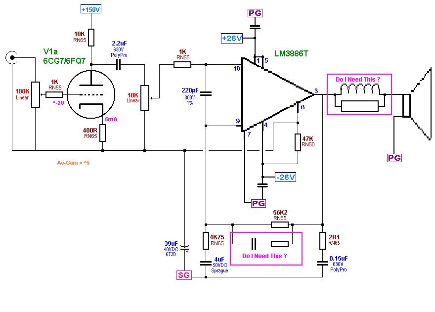

The data sheetfor the LM3886 has a convoluted equation for the roll off frequency created by Rf2 and Cf. It has a variable of "s" I can't find the definition of that variable?
Questions
1: Do I need this circuit assuming the input is only Low frequencies?
2: If I do need it then how to calculate values.
Rf1 will be 56K

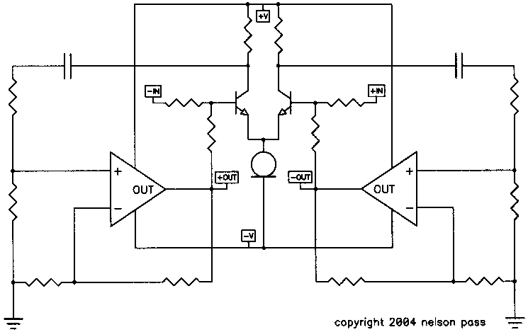

BTW, IF...big if... you give more thought to the push pull idea Nelson Pass has some posts scattered around somewhere about a super-symmetric chip amp. I have a feeling that a SuSy LM3875 with a JFET front end may sound quite...zenful 🙂

Good news! I've found 5 of LM3886 available for live test.
I'd like to do a gain 10 inverting LM3886 to start out with. Any clues on resistor values? Or, shall I simply guess five times and pick the one that works best?
Heres what I have come up with.
Questions in Pink Boxes . . .
Woah!! far too much load at the output. Please specify the zobel cap as polyester (not polypro).
Yes, we do need the output inductor//resistor. Its necessary for stability.
Your DC voltage is approximately 30+30 although it may be 29+29.
The RC parallel to the feedback resistor is probably unnecessary if the feedback resistor is metal film.
It may be tough to source 39uF caps--can we use common values?
