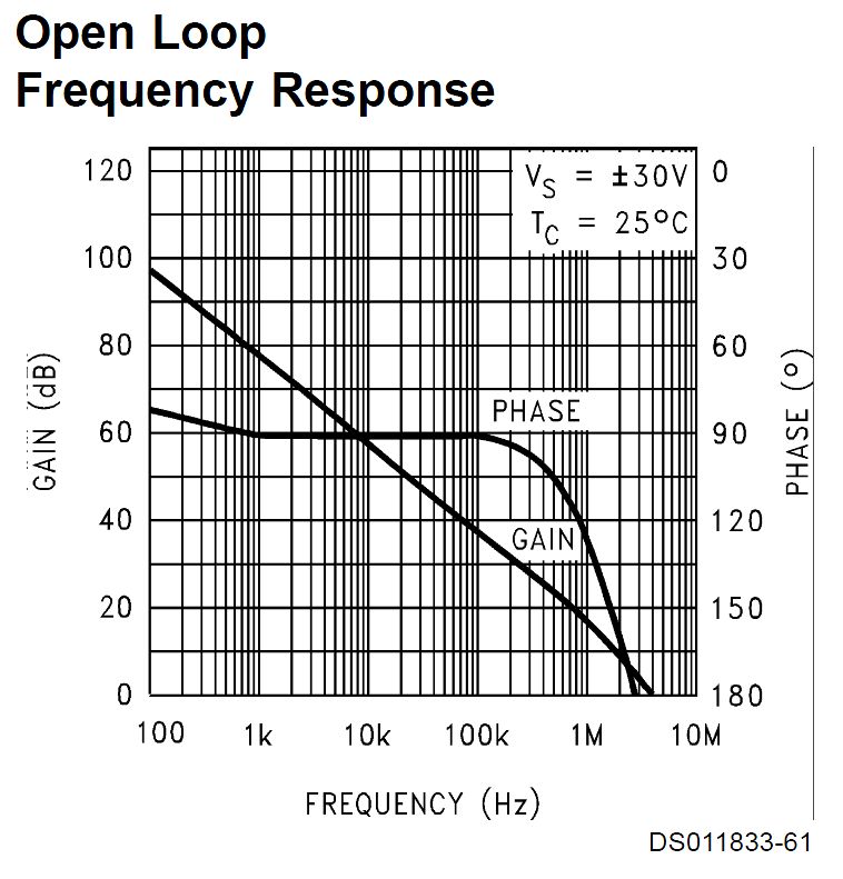

No time like the present: I changed the gain in one of my LM3886 amp boards to nearly 5 first with no signs of instability and then to 4 with the same result: no sign of instability.
I used the recommended schematic from National and there is a Zobel and output inductor in place.
Hope this helps.
The spec sheet shows that the internal compensation results in 180 degree phase shift at a gain of about 5. Anything less and you are sure to have oscillation (180 degrees results in positive feedback). Any higher gain and you increase the phase margin and get improved stability for capacitive loads and you will also have improved step response. A good design point is where there is a phase margin of 60 degrees--this occurs at a gain of about 20, which is what National recommends. Obviously, some chips may have characterics different from the spec sheet that will allow them to operate at lower gains, but it isn't good practice to count on deviations from spec in your design.

Ok, scratch that. My previous test was with a sine wave input into my 8 ohm dummy. I just connected my scope and that looks good but when I switch to a squarewave it turns ugly - heavy oscillation.
So gain below 10 is not really a viable option.
