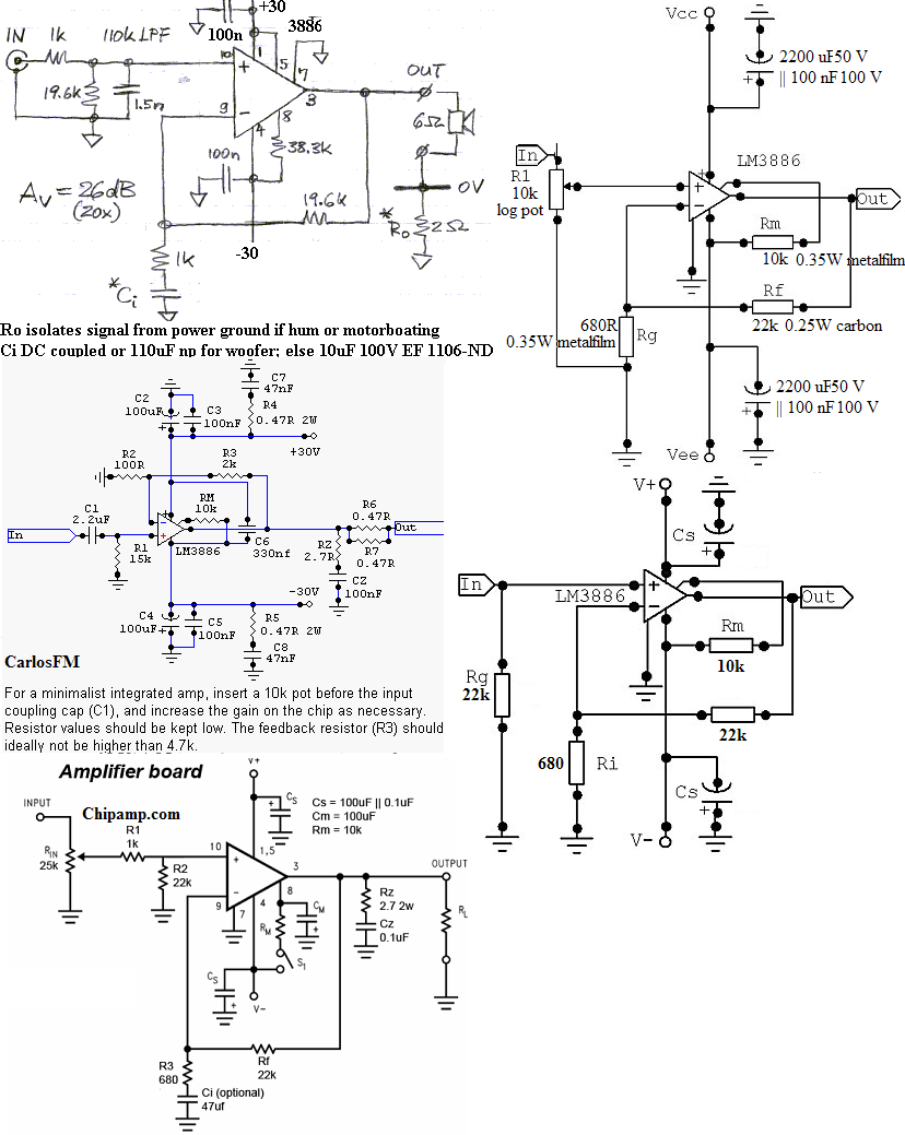

I am looking for about 60WPC with a simple gain control nothing else. I would like to wire it Point to Point in keeping with the theme of the rest of the system.
So what I am looking for is a simple chip amp schematic that would lend itself to P to P wiring and with cost as the major concern.

Hi coldcathode, I did a P2P LM3886 using the schematic in BrianGT's Chipamps.com kit. Though you will only get 60W if you are driving a 4 ohm load.. if you are driving 8 Ohms you can safely get 50W.

For instance, would 100VA trannys be enough? example 25V @ 4 amp? Bridge rectified I am looking at about 35 Volts?
How can I calculate the power requirements assuming a 4ohm load? I can design tube amps all day long but I need some basics on these amps.
In the schematic for the copperamp I have a couple questions, if you can answer them for me it would be great. (I am willing to assist SS guys looking to get into tubes)
R1 (pot) is used only for volume and sets input inpedance to the source correct? Does it have any effect other than attentuating the signal?
Rg what is Rg use for? some sort of input bias?
Rf gives feedback? how is that value calculated in relation to load power etc.
Rm is a muting resistor and is switch in and out I suppose?
Cs The caps are for smoothing the supply and "headroom" I suppose, doe their value have any significance? ie can I raise the value for more "headroom" considering relatively small trannies?

Use 18-0-18 toroid with at least 160 VA rating. 25 volt AC gives too high DC for 4 ohm speakers and will make too much heat on the 3886. I am looking for link for Antek toroids but it seems to have changed. They were one of the best toroid suppliers.

I'd highly recommend reading at least pages 18-21 of the LM3886 datasheet 🙂 Page 17 might also be helpfull if you are planning on using the smallest heatsink you can get away with.
Rg I'm unsure, I'm even unsure as to whether I had one of these on mine. I mostly used BrianGT's schematic but also took queues off the typical application in the datasheet (which doesn't have this resistor).
The datasheet has the info on calculating the feedback resistors (It is the ratio between rf and ri that sets the gain).
rm provides the necessary current to turn off the muting fuction (ie it will be muted if left out). If you don't want a mute function simply hard wire the resistor in 🙂
Cs is a supply bypassing cap. I will quote the following from the datasheet:
You can use bigger caps in the power-supply which I would say would be a good idea if you are using this for bass duty. A lot of people claim that the LM3886 is better with smaller capacitance in the powersuply, but I think usually the reason is because of perceived differences in the midrange and higher freqs, so for bass duty I think would be worth it. Also I would not recommend using ceramics as per the app note quote above, but instead some good quality film capacitors. I used polyester in mine, but I would consider using polypropylene or pps types now.

Hi coldcathode, I think the answer to your question on rg is in this thread
Note I assume the rg you are referring to is the one in the second link in Ted's post, as the first one has ri incorrectly labeled as rg (well incorrect from the standpoint of the datasheet 😉 )
At this point I'm thinking it would have been really smart to have made some notes about what I did 😉 I suspect I went with Brians schematic and used 22K for both rf and rg, I also suspect that I decided to just go with his gain calcs and used the 680 ohm for ri.
The datasheet has a pot on the input for the "typical application" so without it I guess rg is necessary, or you will get the problem Oliphant had 🙂

Daniel,
What I have are 25VCT @ 2Amps I do have about 7 or 8 of them. My plan was to use one transformer for the positive and one for the negative supply.
What is confusing to me is this.
In TUBE design we primarily figure output as the power (watts) thru the Primary of an output transformer (OPT) = (the LOAD). This LOAD is based upon the impedance of the speaker reflected to the primary via the ratio of the windings squared.
Example an 8Ohm speaker attached to the secondarys of an OPT with 20:1 turns ratio imposes a load of 3200 ohms. A swing Peak to Peak of 300 Volts and a Current Swing of 50mA would yield a Pout of 15Watts into the load Divide by 8 for RMS and you get about 2 watts.
That is for class A operation where current is flowing all the time in the Primary.
The chip amps I guess operate in Class D this is where I get all confused.
