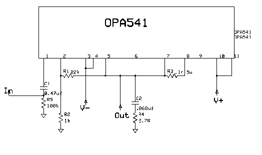

helo i am new to diy.
i have just built an amp with opa541 the circuit is below.
thing is i am using it to power a 12ohm sub. with a power supply of 26-0-26 5amp. i have added a 22k resistance in series with input. and connected a 50ohm resistance from pin1 to ground.
should i make any modifications?
and also is there something more powerful than opa541. yet as simple as opa541.
and which can run on maybe +/- 30 or 40 volts and 2-3amps.
if know it then please post schematics and if possible pcb layout (i am an amateur)

well, the lm3886 does boast a litle more power than the opa541, but it's really not a lot to speak of. 10W to the max rating i belive. not a lot when speaking of db..
since this is a subamp, i belive the the place to gain the most from improvements are power suply capasitans. more is better offcource. no less than 20.000uf. (according to me)
-Marius

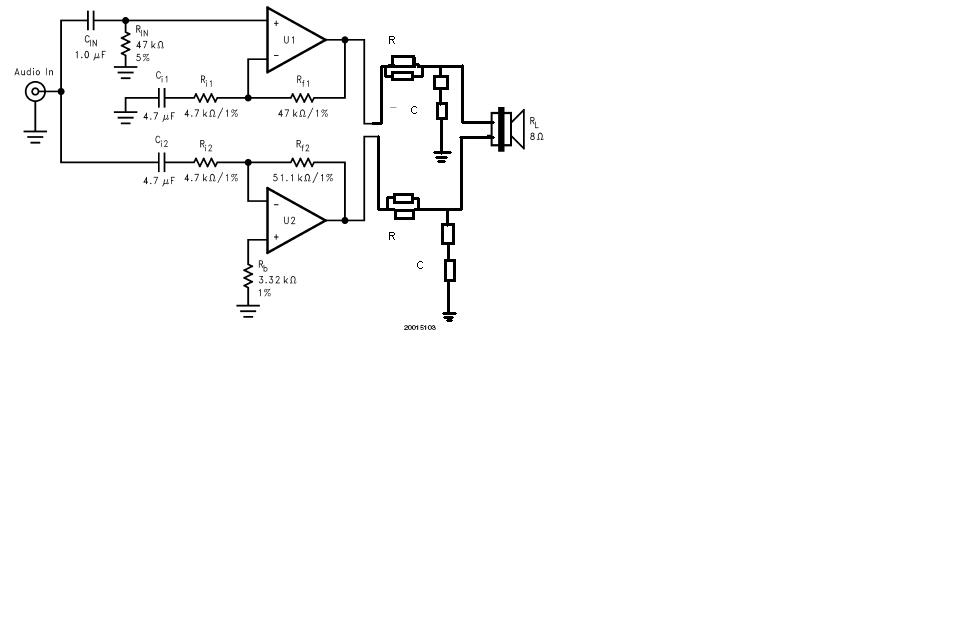

and about the zobel network, i chose the one that carlos has sent.
http://www.diyaudio.com/forums/showthread.php?s=&threadid=39039&highlight=zobel+bridge
so i will need one zobel per chip right so 2 on one bridge ?
i'll send u a pic of wut i mean.
and thats it right no more mods ?

sr2002, the 5amp 30V trafo will be fine, though if it's 30VAC, your pushing the limits of chip safe suply voltage. i know first hand they blow if being pushed higher than what's on the datasheet.
now, a 5A trafo is probably too low for a subamp. have you considered using two frafo's in paralell if thats cheaper than a 10amp one?
the amp looks fine, thogh the zoble i see drawn looks like two resistors in series to ground, wich is offcource wrong. i presume you mean the zoble as a R-C link?
Now, as for regulation, for a subamp, this is not only unneeded, but indeed introduces it's own new set of problems. so just trouble and more cast will be the resoult in this case i would say.
a simple regulation design can be found on another of carlosfm's threads.

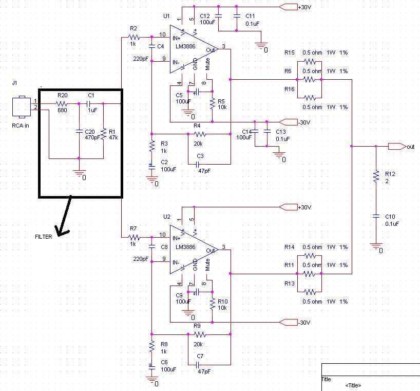

hey thanks alot again,
as i told u i am not using this amp to power a sub!!!!!!!!!!!
i am using it to power regular bookshelf speakers.so will i need and noise filters? i was planin to use the filter given in the attached file. what do u think?
i am building a 2-channel amp based on the br100. that is to boards in parallel with the power supply
thats why i asked u whether 5 amp is sufficient? so a total of 4 lm3886 are there in the circuit.
and the power supply that u sent me is looks really complex. do u have anything much simple than that. wut if i use two trafos in series?
and that calosfm has written somethin below "add caps to chips psu pins" what does that mean?

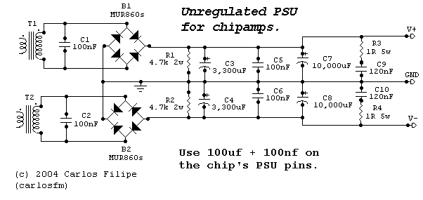

hey ,
wut do u think of this power supply? and i think i'll use 20v trafos to be on the safer side
hey and wut if i connect the 2 trafos. as u said instead of one, and wut if one trafo. is like is 22v and other is 20v or something like.
i mean wut if the 2 trafos are not exactly of the same voltage and amps.
will that blow up the power supply
ok, correction taken.
noise filters?
what do u think?
i dont use any, and if the amp is buildt good enough, then it's not needed i would say. mine makes no noise.
This is the first of carlo's snubbed psu's, use the one he links to here instead.
http://www.diyaudio.com/forums/showthread.php?postid=534018#post534018
I havn't tried, but i think the resoult would be spectacular.
(so try to use two identical)
hope this helps you out.
