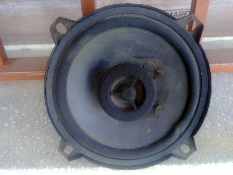

I need to make some fast and dirt speakers for using as stage monitors (children/church theater, popular dance, etc).
I would like to use some 5" car drivers (2 ways, 4 Ohm, 60 W peak, plastic cones with coaxial tweeter) that I have around. Brand could be i.e. Sonavox S605 (Fiat Uno stuff!) or similar cheap stuff .They will be driven by some 50W SS ampli.Sound quality is not really important, since they will not be heard by the public , covered by the PA system. Any rough idea of recommendend size (at least the volume) of the box?
I think to use 15 mm plywood for robustness. I would like to make them ported, for more efficiency. In such case also the size of the port/length of pipe would be needed. Again, I do not need precision stuff, only to a rough idea, since I do not have any.

Ciao Effebì
Where are these monitors going to be positioned ? On the floor ( like prismatic /triangular ones ) ?!
I would choose something more robust ,as I'm experiencing the benefits of high efficiency speakers >>94 dB . They might be much $$$ more than cheap car speakers ,but if you decide to turn up loud ,they'll follow you .
What about a B&C DE-5 or DE-7 with a horn , and a Beyma studio 8" ??
Crossed at 2-2.5 K

Yes, basically they will be THROWN on the floor (and sometimses even kicked, believe me). Stage is about 8 x 4 m.Ciao Effebì
I won't go loud, never.They must be dirt cheap and robust , that's all. So no $$$ drivers...
What about a 9 L box of about 16x28 (front panel) x 20 (deep) cm? Port about 30mm dia (common for plastic pipes).

If you could get 4 of those ( and put in a prismatic /triangular box ,with woofers tilted ...) and strip off the [tw]s , so put a couple of them in series + a tweeter (with a waveguide ) ,and go for 1 st order filter ...

Good stage monitors are not so simple thing, because of microphones on stage. They must be directional, low distortions, and extremely flat. When I designed prototypes I ended up with 31-band EQs inside of each monitor box (I bought that EQs cheap on epay for the prototype).
