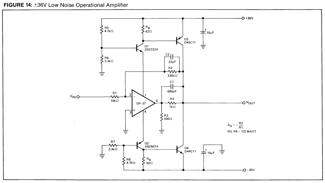

An Analog Devices application note shows a high-voltage amplifier which seemed promising for this application, using an op-amp with supply current sensing and a potential divider on the op-amp output to provide both a current boost and allow the high voltage rails:

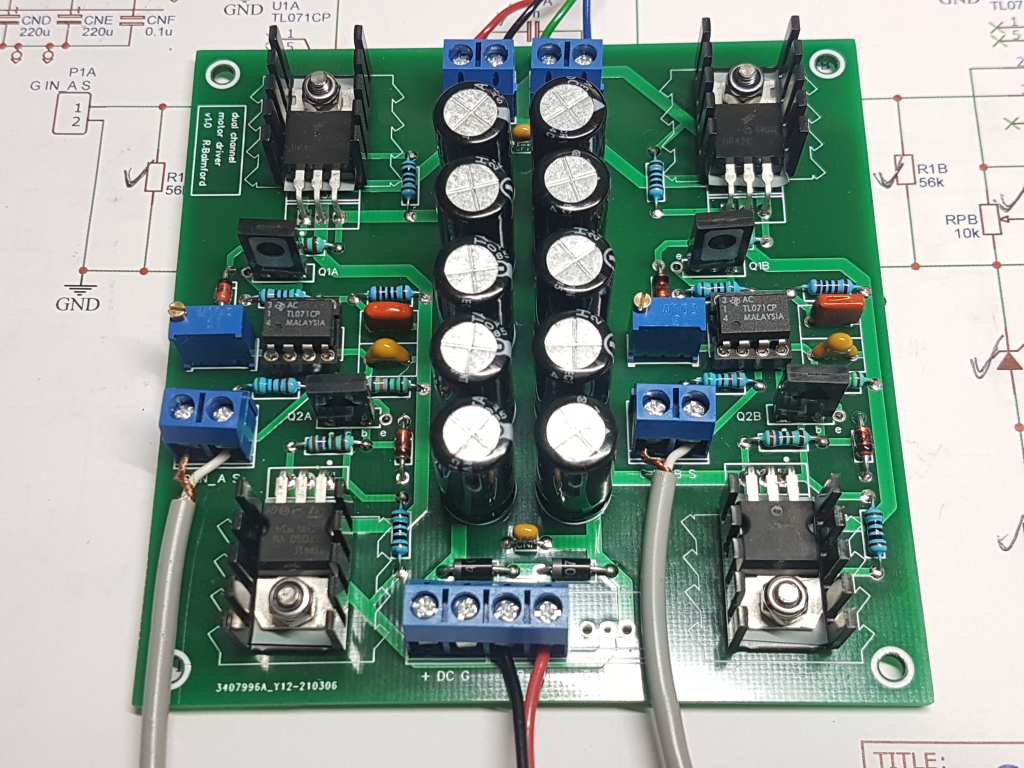

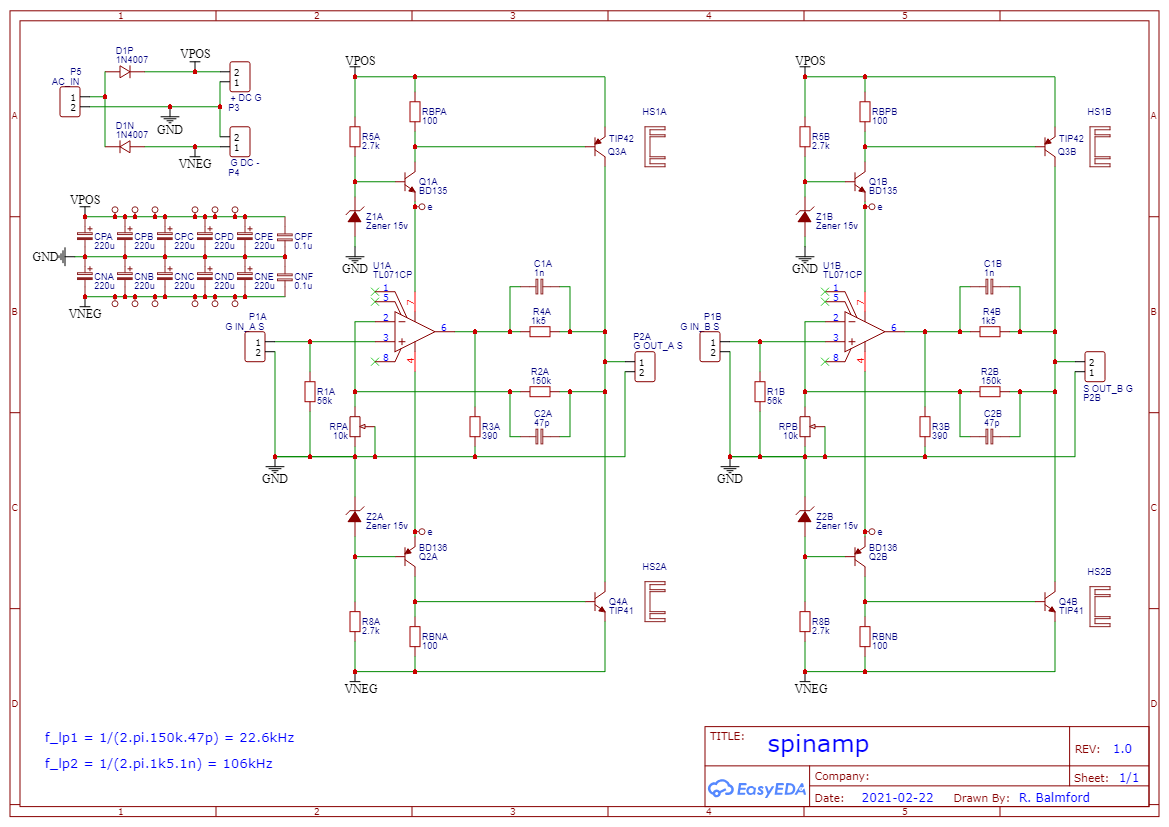

A 2-channel amplifier suitable for a low-power synchronous motor based on this concept has been produced (non-inverting, zener references), using mostly non-critical parts. The TL071 op-amp proved suitable, with the only critical component being C1 for the stability of the current feedback loop:

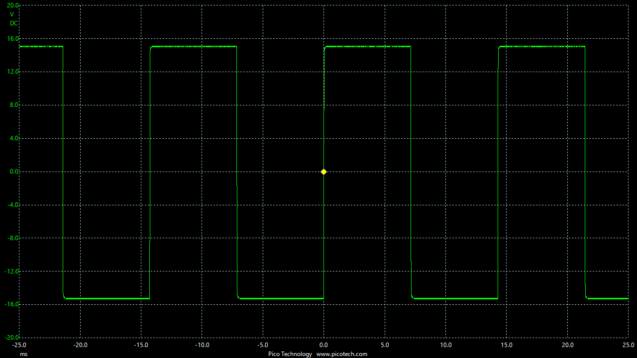

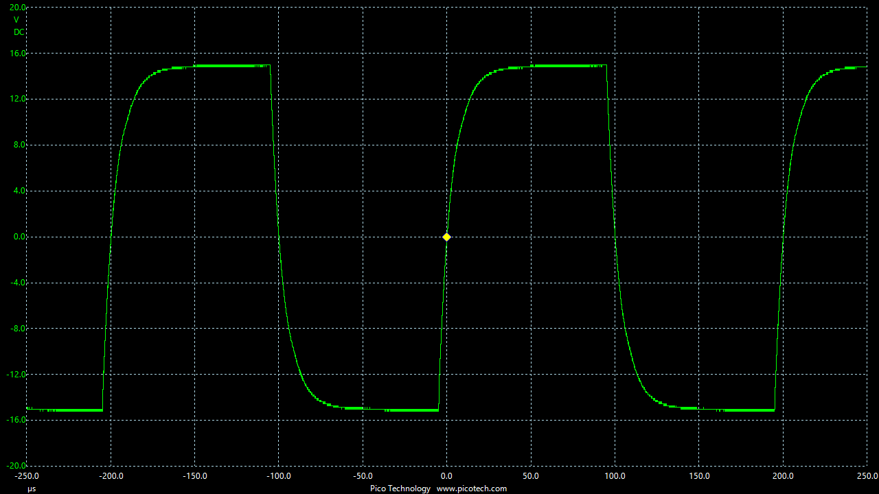

With C1 of 1nF, step responses at 70Hz (left) and 5kHz (right) are good:
A PCB is available, Gerbers and build guide are attached to this post.

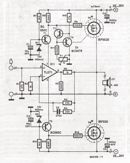

FWIW, Elektor published a few versions of audio output stages driven from the rails of an opamp - dating from the 1980s, I think. The attached schematic is the simplest Mosfet version but BJT and better versions turned up in their circuit pages occasionally too. Google will find them without much effort.

Hi richb,
This looks to be just what I'm looking for. On the other hand, there are some things I do not understand. Especially when I was reading you can supply it with a single 24V AC transformer. I do not understand how, without a middle tap and I think voltage is low too if you create a virtual ground. From 24V AC you may get about 33V DC, lets say +15V and -15V. From that, we could get about 10V eff I think.
I guess I'm wrong somewhere, but I just do not understand how it works, please help. Would you be willing to share design files? I would put a full wave rectifier on and tapped transformer connection.
Also, I do not understand the HV board. I use transformert to drive 110V motors after LM3886 modules, but what are the additional circuits are doing on the board I could not find out. Can you please explain that?
Thanks a lot!!!!
JG
Hi JG, the circuitry in the top left of the schematic, shown below, is a pair of half-wave rectifiers, which will give approx. +-Vpeak of the input AC on VPOS and VNEG. These then becomes the 'DC rails' for the output AC sinewave. Because of the small voltage drop of the diodes, the cycle-cycle droop due to the discharging of the capacitors under load, and the output waveform having to have a small voltage margin to the rails, the maximum output AC voltage will be a little less than the input AC voltage. From memory, with the original Rega 24v 0.1A transformer, I think I managed around 18v RMS output, which seemed adequate to drive the 24v TT motor. Using a higher VA rated 24v AC supply I got a bit closer still, and my curent implementation uses approx +-40v DC rails from a repurposed amplifier chassis which then allows the full 24v AC output with this design.
The 'spinamp_HV' is a companion board with transformers which will allow the generation of 110v AC for the motor, the additional circuitry enables the transformer output to be included in the amplifier feedback loop, thus giving good control of the output amplitude and waveshape.
The schematics, BOM and PCB Gerbers are included above, so should allow you to reproduce either system as desired.
