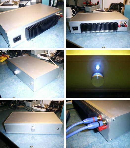

Almoste finished!!!
After some work on the amp the exteriors are now completely finished.
Since this is my first amp it's very simple, just volyme and an on-switch really. There are still some things I haven't figured out yet, for example where to install the fuses, before or after the transformers?
On the back you'll se the powerplug, signal and speaker contacts.
I'll post some pics of the interiors ASAP.
I'd really appreciaty comments and suggestions, so I at least know I'm heading in the right direction.

Must say that your mechanic work is good seen from the outside.
Good thing that you have mounted the cooling outside.
Can't wait to see the inside.

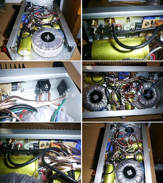

Put a slow blow fuse between the line cord and the transformer for fire safety reasons (at least). It's up to you whether or not to fuse the secondaries, I would recommend it, especially if your going to be poking around in there!

Looks like a nice enclosure, where did you get it (and what did it cost, if it's not too rude to ask)? Or did you machine it yourself?
The inputs and outputs are a little close for my liking, but you may not have had a choice with the length of the heatsinks there.
Yes, show us the insides once you have some...did you go with the single LM3886 design? Did you buy PCBs from ESP or what?

Inside pics
Finally got some pics of the inside,
As you can see I used two rather large torodial transformers, one/channel. Aparrantly thats better than sharing the same powersource for both channels.
I went with the one chip idea, and I think it sounds quite well, eventhough I can't say i had alot of experience with DIY amps.
I bought the enclosure from www.elfa.se
I'm still pussled where to aply the fuses. On + and - and ground, or just on + and - .
If anybody knows how to tweak it a little, (like putting som small caps here and there or something like that) I'm all ear.
I Used 2 filtercaps a powersource, rated at 6800 microF, is that enough?
