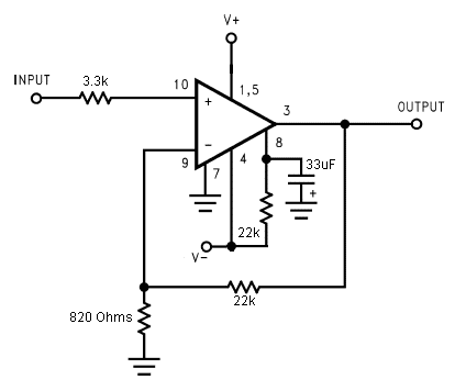

I made a simple amplifier today.. and for some reason when I have nothing connected to the input I get a positive voltage on the speaker output.. :hot: why ohh why??
heres the circuit.. something I missed?? something I don't need? thanx.. I am using +-24 volt rails BTW.. and 2 chips share a common transformer and 10,000uF per rail... no caps close to the chips, the closest are the 10,000uF which are only about 5cm of wire away anyway... any ideas about the voltage?? THANX!!!

Yes, there is something you have missed. Input offset voltage
and current.
A resistor to ground on the positive input will lower the DC
level when no source is connected.
The value must be a trade-off, since it will also lower
the input impedance of the amp.
You may still get problems with output DC both with and
without a source. I recommend a capacitor in series with
820 Ohm resistor. About 47uF should do, unless I miscalculated,
but let's make it 100uF.
Put a cap of maybe 100uf from the bottom of the 820R resistor to ground instead of to ground directly. This will reduce the dc gain of the cct to 1. Also, the input should have some resistance, say 47k, from input terminal to earth to stop it drifting when open cct.

LM3886

peranders said:
Is the input floating or have you tied it to ground? The IC must allways have DC-paths from the inputs to "somewhere" (ground). If you not have bias currents you will get a "undefinened condition".
and current.

li_gangyi said:
dude...did you put a resistor before testing for offset??

my concern is the fact that I want to use the computer to control the volume and if there is nothing connected I get the voltage rail on the output... the amp will not be able to be on without the computer... but I still don't know..
You should consider some sort of muting for power up/down of the computer and/or a blocking cap on the inputs.
I connected my computer directly to an amp and there are huge pops on startup, especially after it locks up. (sometimes an hourly occurrence). I have a Dell Inspiron 8200. Other computers/soundcards may behave better, but why risk your speakers?
You still ought to have that resistor to ground at the input.
You should also be aware that there is now nothing that
protects your speakers from DC in case of amp failure. If you
care a lot about you speakers you may wish to include some
form of DC protection circuitry or, in the worst case, a cap
at the output.

I meant when the computer powers up it sends some DC to the amp. The amp I use here (Hafler 500) has a speaker protection delay that includes DC offset protection. It is not fast enough to prevent the pops, it mutes after the noise then reconnects after a few seconds.
