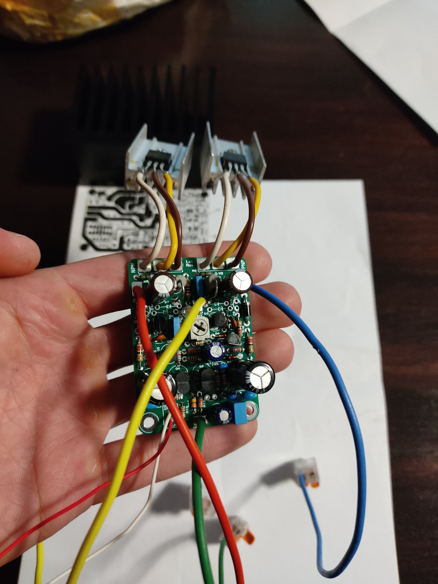

The Amp Camp Amp in the diyAudio Store, has a single transistor input stage. In fact it has a total of four transistors in each amplifier channel. I consider it simple.
I've built a few of these and they are inexpensive and sound fabulous. Well worth looking at. https://diyaudiostore.com/products/aca-mini-bundleOk, So I am looking around for a simple amp project as a fun build.
