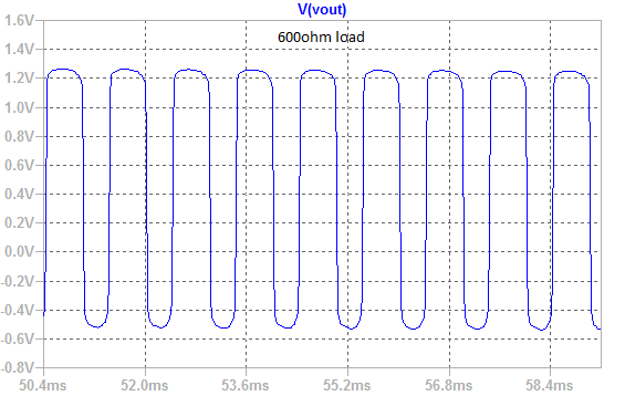

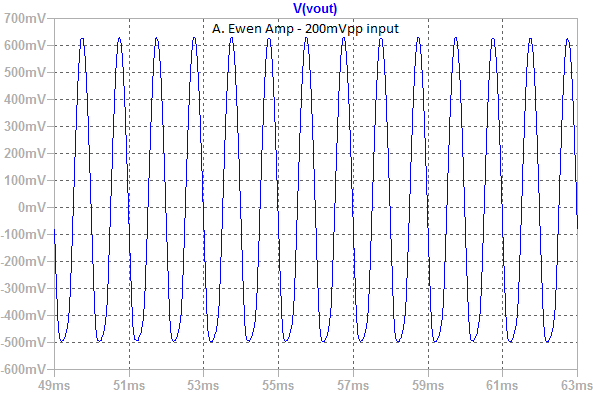

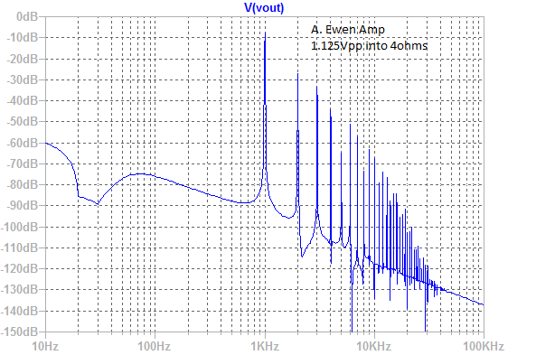

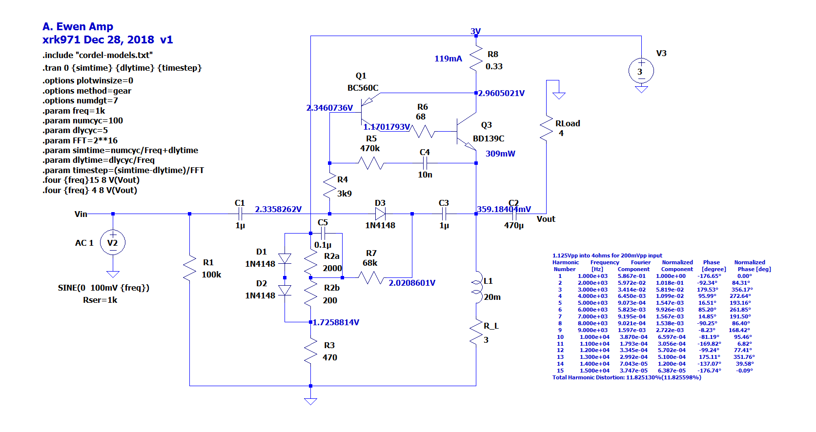

Perhaps I am not doing something right but I tweaked 2k2 pot to almost bottom of travel to get sufficient bias current. Amp has interesting property that high impedance load will give a quasi square wave output, that is distortion goes up with decreasing impedance! At 4R, it has about 12% THD and FFT looks like quite a mess. Hmm... is something off here? Playing with value of inductor had no effect on distortion. I connected load to GND, and connected as shown originally had same output. There was no benefit of connecting speaker to a hot battery lead other than potential for sparks and fire.
Schematic:
Simulated Oscope for 4ohm load:
FFT for 4ohm load:
Here is 600ohm load:
Schematic:
FFT for 4ohm load:
How about trying it with the specified diodes - 1N4002.Perhaps I am not doing something right but I tweaked 2k2 pot to almost bottom of travel to get sufficient bias current....

Looks i did something wrong in post #7.The missing part
Mona
This fails 2 of the initial requirements:
1. Power supply 3v.
2. Adaptive bias to minimise power consumption.
I doubt that the type of diode changes anything as long as it is a silicon diode. I put 1N4004 (higher voltage version on 1N4002), Made inductor 35mH, set bias to 25mA and still get a similar behavior.
Code:
Harmonic Frequency Fourier Normalized Phase Normalized
Number [Hz] Component Component [degree] Phase [deg]
1 1.000e+03 5.465e-01 1.000e+00 -177.98° 0.00°
2 2.000e+03 6.175e-02 1.130e-01 -91.14° 86.84°
3 3.000e+03 2.076e-02 3.799e-02 177.69° 355.67°
4 4.000e+03 5.712e-03 1.045e-02 83.99° 261.97°
5 5.000e+03 2.349e-04 4.298e-04 -52.07° 125.91°
6 6.000e+03 1.451e-03 2.655e-03 86.04° 264.02°
7 7.000e+03 1.204e-03 2.204e-03 -9.08° 168.90°
8 8.000e+03 4.297e-04 7.862e-04 -107.17° 70.81°
9 9.000e+03 1.447e-04 2.648e-04 7.75° 185.73°
10 1.000e+04 2.874e-04 5.260e-04 -98.95° 79.03°
11 1.100e+04 1.691e-04 3.094e-04 163.54° 341.52°
12 1.200e+04 2.107e-05 3.855e-05 4.40° 182.38°
13 1.300e+04 7.106e-05 1.300e-04 177.02° 355.00°
14 1.400e+04 5.702e-05 1.043e-04 75.11° 253.09°
15 1.500e+04 1.708e-05 3.126e-05 -50.00° 127.97°
Total Harmonic Distortion: 11.972628%(11.974771%)

xrk's simulation results look plausible... gain is going to be approximately Rload / 0R33 (so you'd need to dial down input amplitude or increase degeneration for higher-impedance loads), and bias needs to accomodate one diode at low current plus one B-E drop and change from B+, so its setting being near the low end makes sense. I imagine using a germanium or Schottky diode may give better results, as it typically does in AM detectors... which is pretty much what this autobias circuit is after all. I would also prefer attenuating diode detector output between the diode and the 3k9 instead of making the coupling capacitor as small as it is.
As for distortion, at these low voltages saturation becomes very important, which is going to vary a fair bit depending on transistor type, not to mention potential modelling inaccuracies. I'd double-check with something like 1N5087 and BC337 models. In general, the less complex a circuit, the more it is susceptible to component variation.
