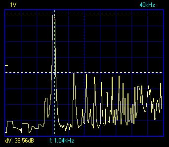

on request my measurement.....
The d2 is -59dB the d3 is not present. Just ignore all the HF rubbish, some of it is coming from my not so expensive digi scope... When you play with the DC adjustments, you see the d2 and d3 go up and down like a jojo, the other stuff stays almost the same, so no/little correlation with the audio
Will post at the next one a FFT from a sine wave with DC = 3,5Volt.... just watch

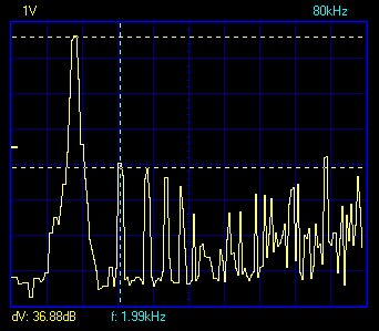

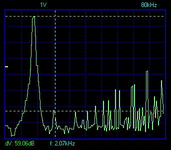

here is the FFT of a sine wave of 1kHz with a Rref of 1k5 and the Rload of 2k2.
The only difference with the above FFT is the Rref of 1k38
Huge difference, eh? I now put a 25 turn trimmer in place of the Rref, so you can trim the DAC to minimum distortion.
In this case you can actually hear it as well. Specially female voices are very clean, where at the 1k5 they sound somewhat harsher. Need to say: differences are relatively small but clearly audible...

Resistor at Vref
I am still on probation here I believe, it takes hours to get the reply in, so sorry for that
doede
Hi Doede,
If I understand you right you are saying there is a optimal value for the resistor at Vref ? Somewhere near 1k38?? Is this with +5V supply for the DAC?
After some time your posts are displayed immediately. Newcomers are first subjected to some kind of "filtering", taking some time in the process.....😉

Let's answer for Doede:
Doede uses the TDA in passive mode, with 2.2k I/V and 8V supply. In that configuration, the correct Vref setting is essential!!!
Theoretically the DC output level should be at 4.3 V, but Doede says he gets minimal distortion between 3.7 V-4.1V or so. Doede seems to use 1k38, I use 1k26 (4.25V).
