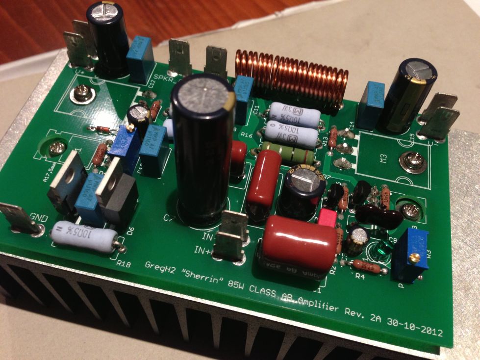

Mike, Kean,
Yes, I agree. And, I have found ouput chokes to actually be beneficial in some cases. They provide a rounding to the top end which with my speakers presents as refinement.

just noticed, is it ok to have outputs tight against the board ?
with just one output pair I expect they get quite hot when driven hard
Yeah, you're probably right. Having them clamped to the PCB probably is not the most thermally efficient.
However, the PCB acts like a big washer and ensures they make good contact with the sink. It's convenient for mounting the PCB and in reality I don't push the amp hard in normal listening.

Struth,
I agree completely that a choke you can hear is too big at least when it comes to objective measurements. However, if I was chasing objective perfection in my amplifiers I would not have sold my Doug Self Blameless amplifier on ebay. I like the sound of a fairly large choke. That's why I use them. I find it more natural sounding than applying excessive phase lag or lead compensation.
As for your comments on the devices being clamped under the PCB. I present the possibility that if your devices are getting that hot your heatsink is too small and your insulating washer too thick. I can point you in the direction of several successful commercial builders who use the same technique. Rod Elliot is one such example:
http://sound.westhost.com/p101-pic.jpg
Hi Guys
I never mount the output devices that way and neither do any builders I respect. The fact you see something done even by a mass producer does not mean it is good practice. Rather, it is just that they have decided that this compromise is one they accept.
Your choice to use an output choke as a treble control is valid for yourself. You can insert any type of EQ between the PA and speaker but you lose damping and introduce other distortions - all of which may alter the sound in a way you like. Personally, I prefer to eliminate as many things between the amp and speaker as possible, to the point of bi-amping and using active crossovers.

Struth,
At the end of the day if the devices are not getting overly hot I can't see why the mounting scheme matters. I would not write off a designer or builder just because they don't mount devices the way I do.
Mine are not getting overly hot and I am happy enough with my mounting scheme.

.......... I don't push the amp hard in normal listening.
you can expect it to be mounted on big heatsinks, and driven to the limit into 4ohm load 😀
but anyone can just lift the board a bit more, and mount a suiting washer between board and power fet
its no problem
