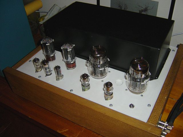

my latest project was the Trion MK2 SE EL 34 tube amp and this amplifier works without problems since a year now.
My wish is to build a new amplifier - also single ended with a bit more power.
Two years ago I built a pair of "Statements" loudspeakers from the Hobby Hifi magazine - 95db efficiency, two ways with a 15" PA Monacor speaker and a celestion cdx horn.
I'am interested in building a 6C33C SE amplifier and now I'am looking for a good and simple schematic.

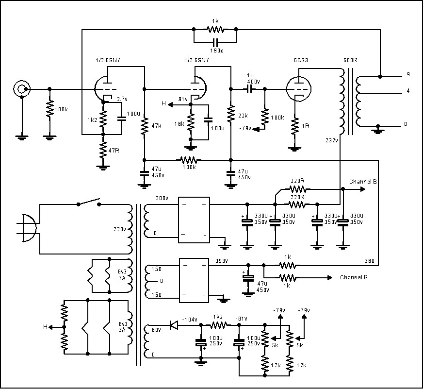

I found this after a long search in the forum:
attachment.php
but also different schematics with different driving stages and power supplies.

RE: The Schematic in Post # 1.
There are 3 inverting stages.
The global negative feedback is taken from the 8 Ohm Tap.
You have to swap the leads on the output transformer primary.
(make the plate signal versus output tap phase inverted).
Otherwise you have an Oscillator; you will not have an Amplifier.
Post # 2 schematic,
A high impedance D3A in pentode may have trouble driving the choke inductance at low frequencies.
A high impedance D3A in pentode may have trouble driving the choke distributed capacitance at high frequencies.
In order to get the inductance high enough, a very large number of turns are required (and lots of laminations). Otherwise, the limited inductance will rolloff the low frequencies.
But the turns will have to be in multiple sections, with very large spacings between each section (like specialized sectioned RF chokes). Otherwise the distributed capacitance will rolloff the high frequencies.

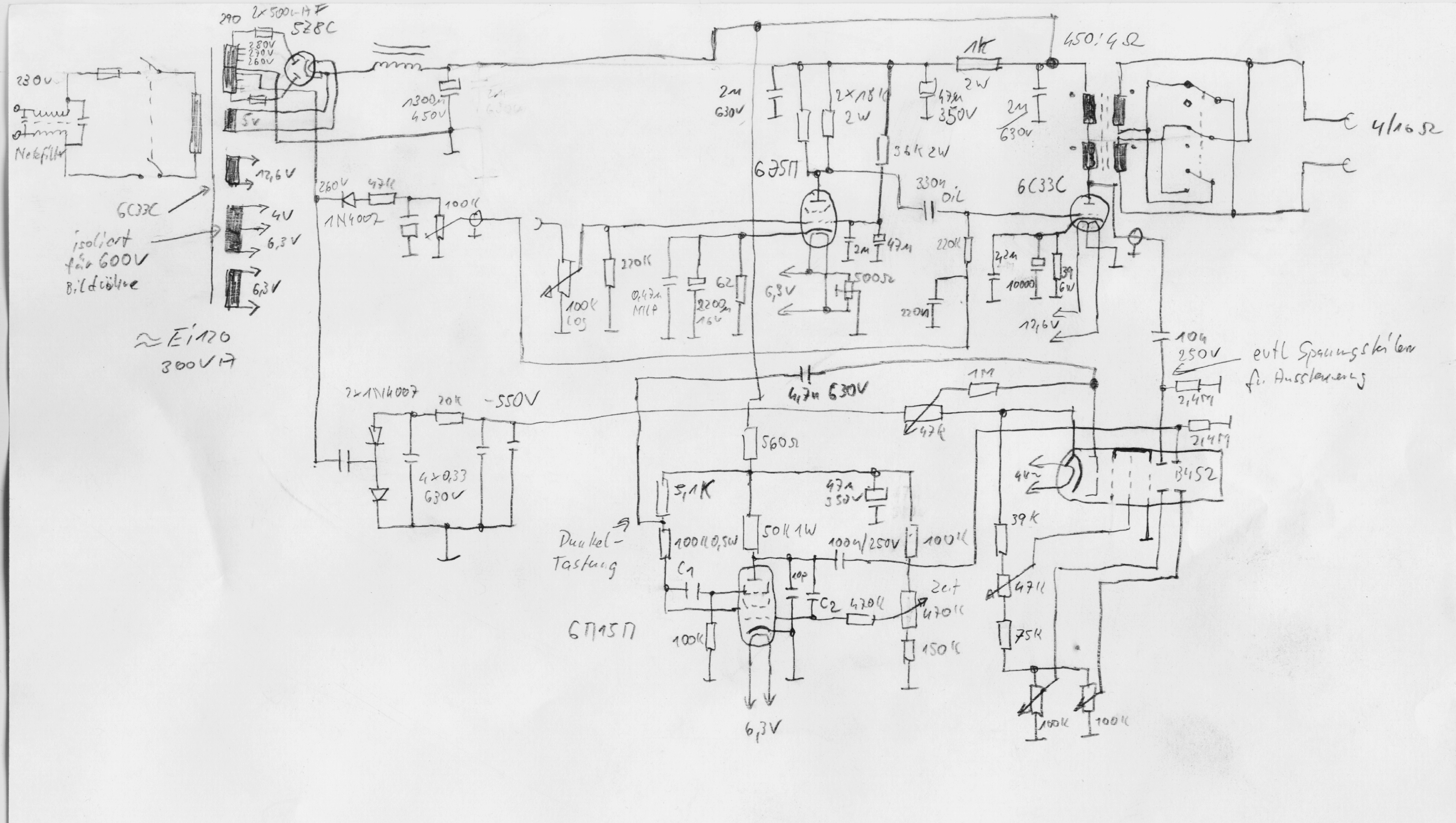

Schematic Post # 3 and Post # 5.
Drawing mistake:
The driver tube grid and screen are drawn to be one grid.
You can not apply signal, and resistor to B+ to the same grid, and expect it to work.
Does anybody actually check any of these schematics, before they post them? ? ?
Newbees beware!
Build it as drawn, and weep!

2. Now, look at the schematic of Post # 3.
That is the first time I have ever seen such a driver tube:
It has a filament, a cathode, a plate, Only One Grid, and Beam Formers.
A combination g1 / g2 grid? That does not work as drawn.
We 'probably' know what the draftsman meant, but only by assuming what he meant.
