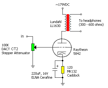

I have a regular 5842 => IT => 300B and it is time to make it better. I don't open a new thread because 45 or 300b is about the same challenge.
I know that the best operating point of the 5842 is B+ 150 volt and about 12 mA 😎
I also have a 5842 => lundahl LL1630 preamp (same topology as frontend of poweramp), so I first will use this as a guinea pig.
The thing I changed is that I used a 10M45S chip between B+ and the LL1630 and I took 1 choke/channel out of the preamp. PSU is now 0,1 uF => shared choke 10H =>47 uF => 430R => 47 uF.
I still have tot try a 0A2 regulator (150 volt) after the chip. But first I tried a 25 uF motorruncap between cathode and B+ (at that time there was a 180 ohm cathoderesistor without bypass of capacitor). That gave a great amount of (50Hz I suppose) hum. In fact I took the setup from Davitsk: http://www.ecp.cc/SSS.html
Question is, how is this possible ? I have two 100R carbon resistors parallel between hot side of the 100K pot and the two groups of gridpins on the 5842.
To get rid of the hum I took the 180R cathoderesistor out and changed it for a reddish LED. This gave 1,8 volt on the cathode and about 136 volt B+ if I remember well. The 25 uF motorruncap is now parallel on the 10M45S and not on the cathode anymore.
Hum is now tolerable and the sound of the preamp is much much better, I might say shocking better than in the old topology (cathode resistor bypassed with 220 uF cerafine and PSU with shared choke and after that CLC for each channel).

By the way, did you realize that you should not touch the small (isolated) bolt with which the 10M45S is tied to the chassis when the amp is on ? I did, a few seconds ago

I agree that for a first amp you better can try a cheaper tube than 300B/45 and I also agree that you should go PP if you do not have sensitive speakers.
For a first amp a ECL86 or ECL82 PP amp would be a good choice.
But that is not the question. I already have a IT coupled 300B amp that is not bad but perhaps could be bettered.
I am experimenting with 10M45S on top of interstage (or better, I try it first on preamp with LL1630 OPT). I would like to get rid of the cathode capacitor and have some trouble with the WE style capacitor from cathode to B+ (hummmmm).

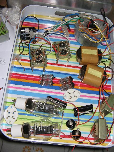

Just revisitin this design, I have completed a Decware SE84 kit since now, and consider this design to be something a little more than a 'first amp'.
I am now experimenting with different driver stages, and different methods of coupling. My current thoughts are interstage transformer, and with regards to the driver: 26, D3a, 5842/417a, C3g and C3m. With these tubes, would it be possible use still a CCS to feed the plate?
I presume my previous presumptions regarding the 45 is still valid, as I'd like to keep that. My PSU at this time is: 50R/4uF/15H(CM Choke)/50uF/20H(1 for each channel)/50uF. Perhaps a little over done, but I have all the parts.
