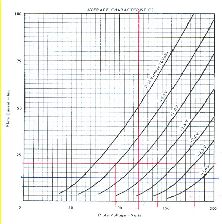

Here is my attempt to design a simple to build SET amp that uses 5842 as the front end, and a 45 to produce a 1 to 2W amp. Hopefully this does not require the use of a preamp. Please provide your thoughts and corrections to any of my assumptions/calculations.
Input Stage
- 5842 with 20mA CCS loading.
- Grid bias set at around -1.5V.
- Grid swing between -0.5V and -2.5V (equals swing of 1V)
- Plate voltage swing with the above settings 95V to 180V. (so a plate supply voltage of say 200V)
- Approximate plate swing of 41V.
- Approximate gain of 40 (rounding down).
- No idea to cathode resistor or capacitor value yet.

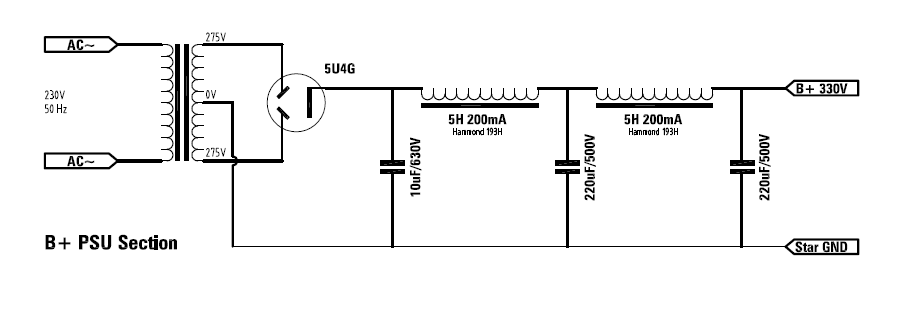

Thanks for the replies. I guess I should describe why I designed this amp. I wanted to put together a simple SE amp that used reasonable common and available parts. Wanted to use an output valve that was readily available NOS and new manufacturer, that wasn't too expensive (always relative). What I wanted also was to bring in a few newer ideas that have been around the mainstream for some years. I wanted to update and modernise the very well documented and built SE amps like the JE Labs SE, etc, etc... I also wanted to keep the costs relatively low and simple construction so that new comers (like myself) can build this amp easily and also learn about tube audio and be able to test and improve this over the years. The amp has to be integrated, so that no preamp was required. There are plenty of schematics and designs that have the 6SN7/6SL7/etc., and I didn't want to duplicate what was already done.
Power Supply
How about a bridge rectification with diodes and a 5U4G that is capacitor loaded, followed by two stages of LC filtering. Using some cheaper Hammond chokes, I think two 7H with 47uF or whatever you have capacitors could work nicely. I have a Elna Cerafine 220+220uF, which will do fine. I was thinking of having a 10uF Solen after the 5U4G, and then one 45uF Solen for each channel before the B+. Something simple and with good performance (at least modelled in PSU2D).
What about using a bleeder resistor to assist in discharging the the caps after power down. What is the best place to put it, and what value/ratings?

If your objectives for this project are: simplicity and low-cost, then probably it would be better to use capacitor as interstage. I believe that transformer on this place has to be of a high quality and I am not sure whether you can find them cheap. I really do not know ... I was using Lundahl here and it is definitely not cheap.
Where you can achieve cost reduction is a power supply. Instead of using tube you may use SS diodes and only one CLC filtering stage. Be aware that Elna is also not very cheap (and Elna Cerafine electrolytics are not produced any more) - so probably you will have to search here for a cheaper but good alternative. Maybe something from JJ or Nichicon ... I am using Jensen but they are also quite expencive.

Here is my proposed PSU. The chokes are pretty cheap, and the 5U4G is pretty easily obtainable. The cap values are not too high, and can be easily found. I think that this PSU should be able to be built for aroudn US$100~150.
Note this will serve both channels. Also, I live in Australia so the primary is indicated as 230V/50Hz.
