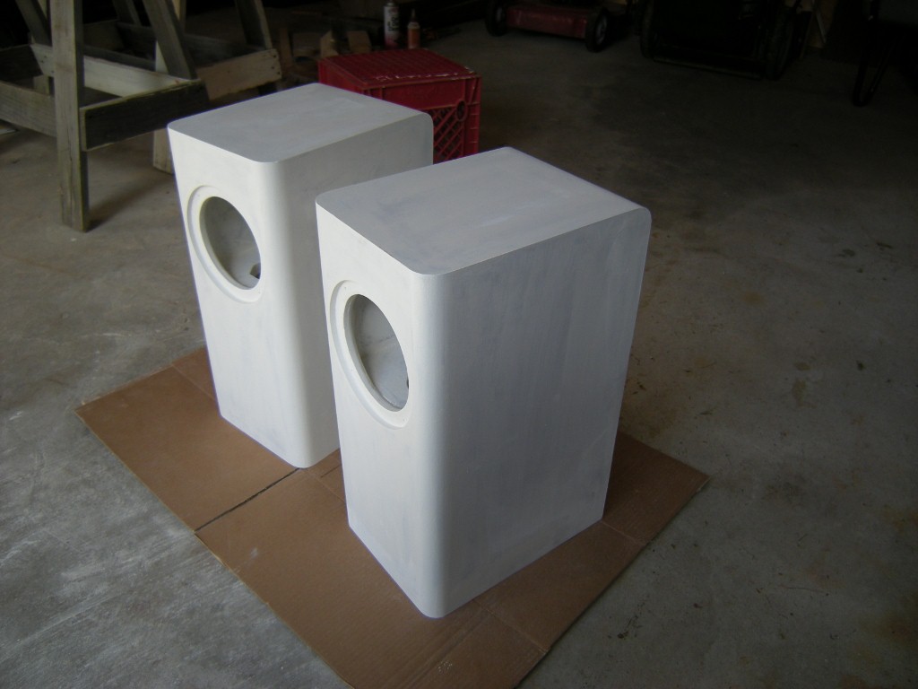

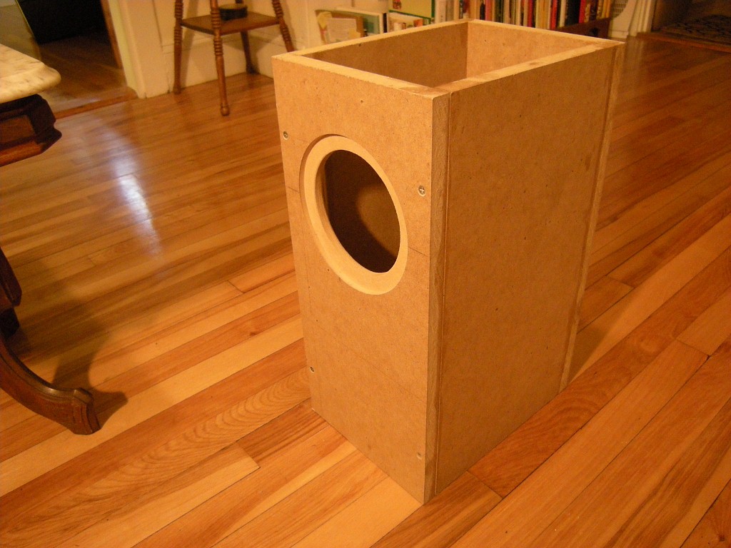

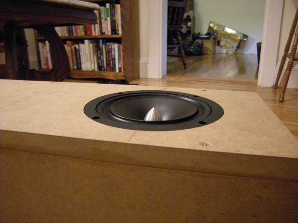

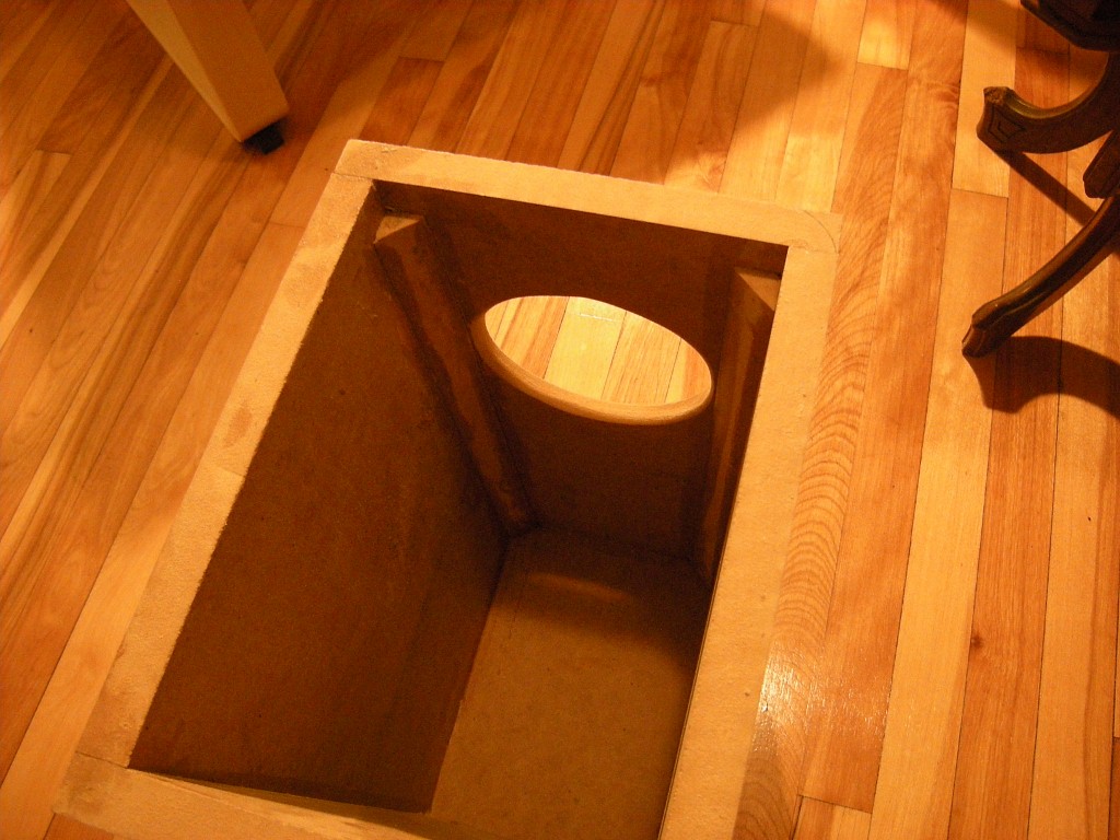

I finally got the skil-saw and knocked together a couple of 3/4" MDF boxes...the speakers are really smooth even without any real damping and teetering on some flimsy stands. Can't wait to veneer them and properly line the walls. I'm using a 2 inch precision port on the rear tuned to 50hz which I think gives me a little dip at 60 until I shorten it.
The detail especially in the bass and mid bass is pretty stunning. Imaging is very solid if you are in the sweet spot. Not sure if I can deal with how directional the highs are though. Might have to make these a two way setup at some point. Wondering how high I can cross a tweeter and still enjoy more dispersion?

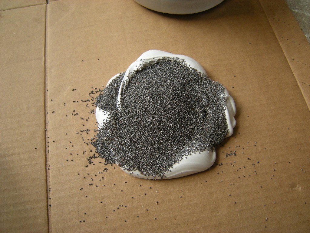

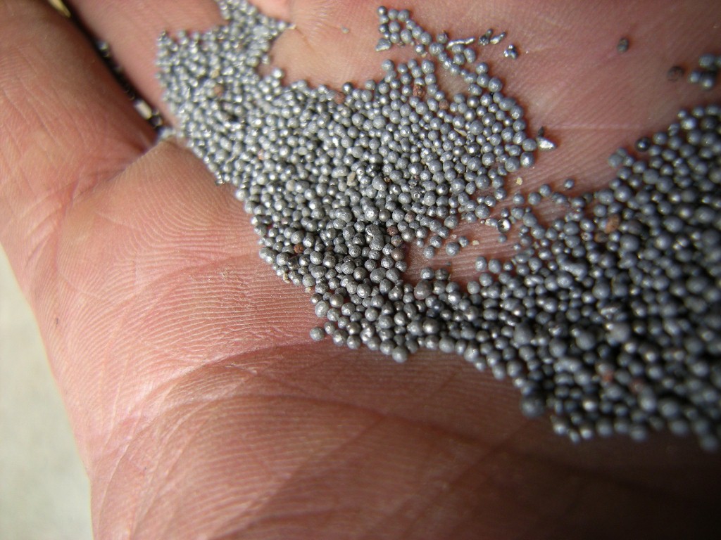

I mixed up some latex caulking and steel shot from a shot blaster to add some mass to the walls. Knuckle wrap test says "yes", not sure what it will sound like. The plan is to glue thin felt on the sides and some open cell ribbed foam to the back wall.
