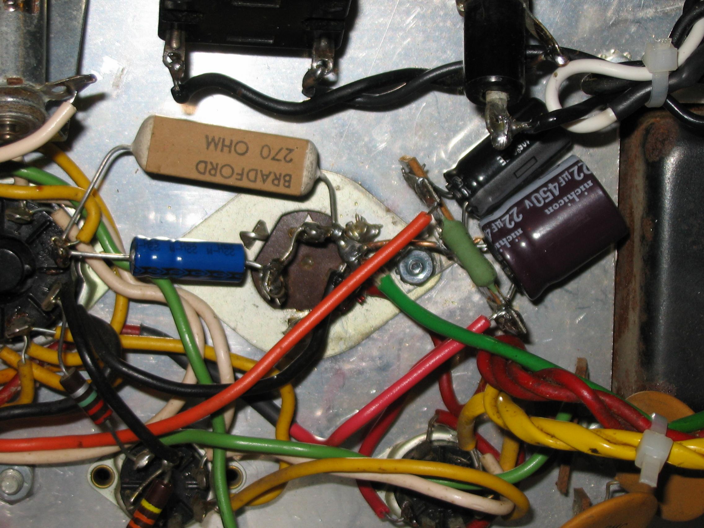

As the design uses a single point common ground for the capacitor, I would excavate the old capacitor and put a 22uF 450V cap inside and the other two should come from the 22uF ground point. Maybe there will be enough room for an extra cap in the old case?
I mounted a 22uF and 10uF cap for the B+ and screen supply on a 3 lug, center ground terminal strip, and put a 2.2k resistor between them. Drilled out one of the rivets on the old can cap and mounted the terminal strip there. The old can cap's positive terminals were wired together and connected to the ground lug of the new terminal strip, and this was used as a local ground bus for the output stage, including a new cathode bypass cap.

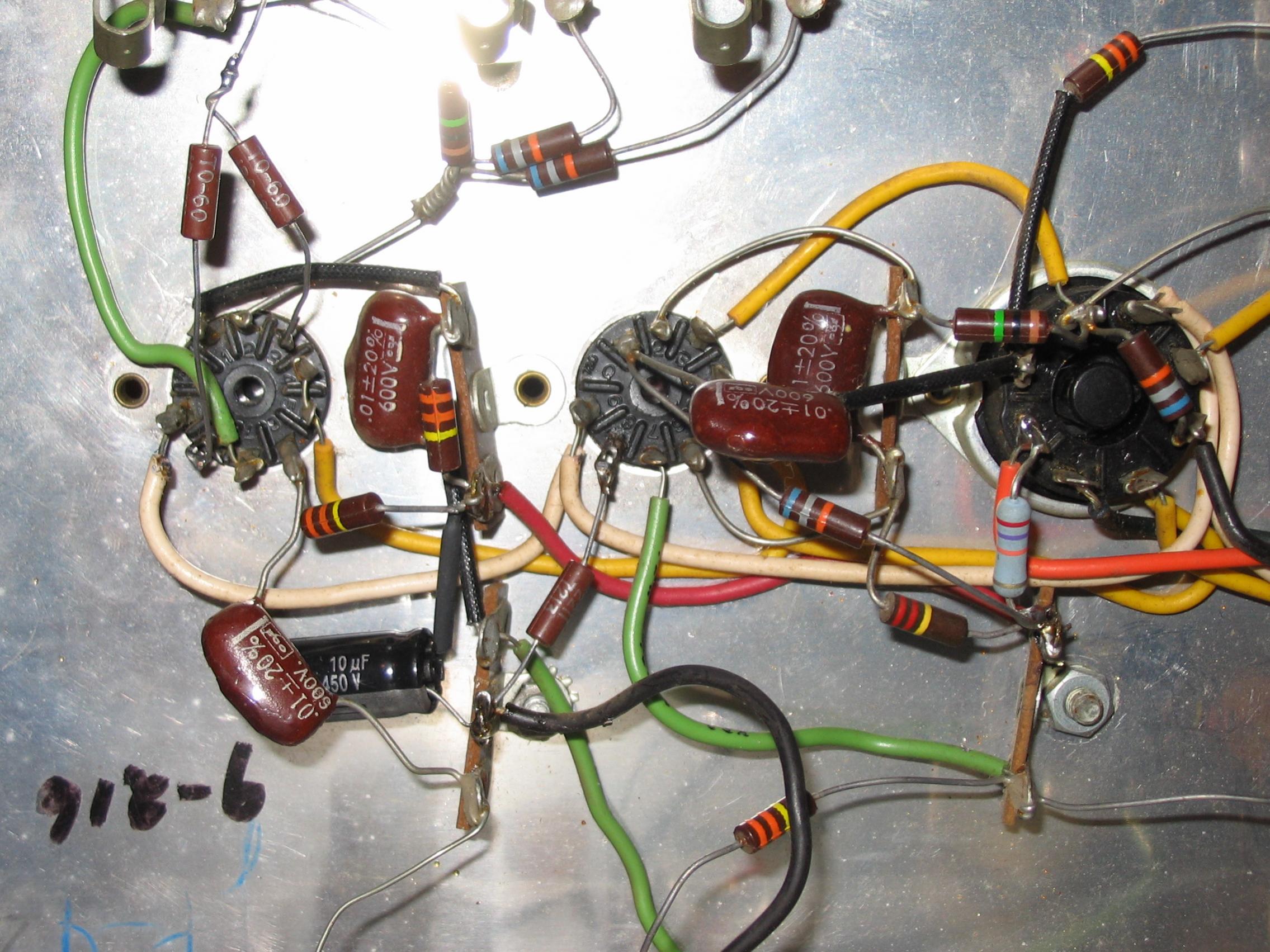

The R & C for the 12ax7's supply were placed near those stages using existing connection points. The 27k is the gray resistor from the octal socket to the nearby terminal strip, and a 10uF connected to the terminal strips between the two preamp tubes, with heat shrink insulating the positive lead.

jgf - Thanks for the photos, they are very helpful. It looks like radial style capacitors work better in this instance than axial type..
jonsnell - Is it important to ground all the filter caps in the same location?
mike60510 - You're welcome. The choice of caps was driven both by fit on the terminal strips, and by cheepnis.... an important trait in this amp. An axial cap of modern proportions could probably fit on the preamp terminal strips.
