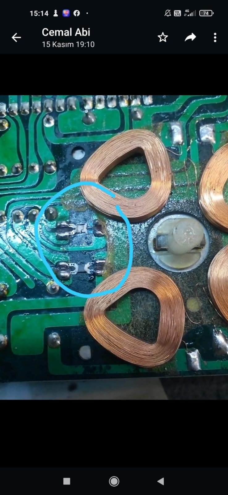

I recently purchased a defective Silver SL-5050 turntable.
The direct drive pickup was not running.
Last night, I opened the covers and started measurements to fix the problem.
The fault went all the way into the direct drive motor. When I took out the magnetic disk of the direct drive motor, I was shocked by what I saw.
What should I see?
Both magnetic sensors are broken and missing. It is not shown in the service diagram.
I didn't know which magnetic sensor to put here. I would be glad if you help.
