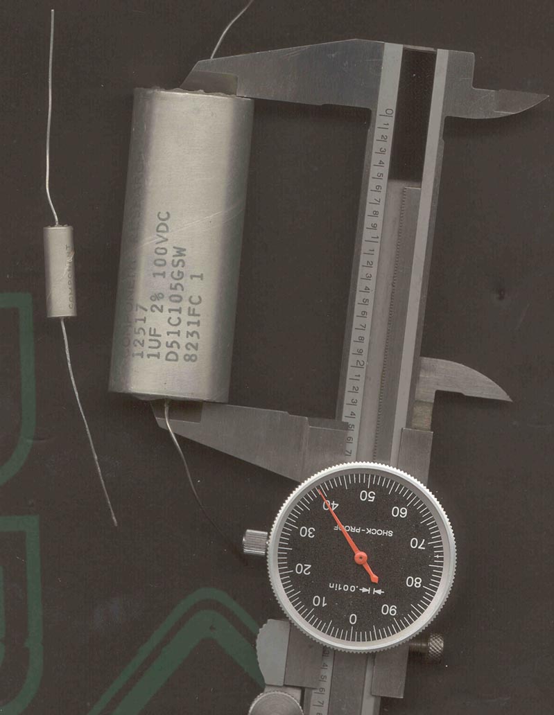

A couple of CRC Teflcon caps the small one is a .0012 and the larger one is a 1uf @100 volts. these are great caps for audio.

When I checked out CRC's website last night I noticed the small values we often need for RIAA correction networks in valve circuits aren't available in PTFE anyway.
By small I mean the range from say, 100pF to 47nF @ 400VDC.
So in most cases it's either silvered mica or polystyrenes (being fased out) or the new polypropylenes.
On paper at least the micas are closer to the ideal cap than any of the other types.
