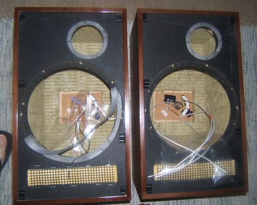

Hi there, just kicking an idea about and am curious about something. Say one takes an old Dynaco cabinet from some A25's (.85cf IIRC), and replaces the 10" woofer with an 8" Silver Flute woofer... would this work?

The recommended enclosure for the W20 is 0.8cf with porting, would an aperiodic enclosure work with such a driver? If so, is the Dynaco cab a suitable place to start experimenting?

No, an aperiodic enclosure is nothing more than a pressure relief vent, it's not a tuned port, and that driver has a low Qts that really needs a well implemented ported box design to get the most out of it. On top of the tuning issues, you would need to re-do the front baffle to accommodate the smaller driver diameter which would be difficult to do without hacking the box. Another possible issue could be the box depth might not be enough to allow a straight port tube, it may be necessary to use a port with a elbow to keep the internal end of the port away from the cabinet walls.
IMHO, if you are set on using that driver, I'd start with a clean slate and either build a box from scratch or find a pre-made box that is better suited.

I can't imagine how you are going to fit an 8" woofer in a cutout for a 10" really.

The A25 used a woofer with a natural rolloff around 2kHz and a higher Qts around 0.4, having very high inductance, which is like a bafflestep coil built in:

0.8 cu feet might suit a lot of 8 or 10" woofers, so something might be doable, but you will probably need to add a reflex tube, as mentioned. You'll also need a crossover circuit more sophisticated than the A25 style.

They are throwaway enclosures, I would be making another baffle for them, but it seems that the W20 wouldnt work in an aperiodic enclosure huh? I thought of porting them as well, but think the enclosure is too shallow.
Lacking the ability to make a quality enclosure with just a router and limited tools, but a baffle is no issue for me as I have played with OB speakers for some time. Was looking at trying a more traditional approach to something. Thanks all.
I'd put W20 into 14 litres (F10 50-), the dyna cabinet is 24 litres. A real droopy alignment could be done, a 1st approx, tuned to 43 Hz (F10 mid30s).

If you are fitting a new baffle to 24L (0.8cu foot?) Dynaco A25 boxes, I'd think you could get quite good results with any old 8" bass and a port.

Simple 0.5mH bass coil, 10uF and 16R shunt. Cheap entertainment. Probably work with the Dynaco Aperiodic port. What you need to know is that aperiodic or damped port is about halfway between Qts 0.38 reflex and Qts 0.5 closed box. Have a go. 😎
No. Its nowhere near either of them. Where did you get that idea ?
An aperiodic damped port does not phase invert like normal ports,
and represents a leak of cancelling output compared to a closed
box, and is only useful for drivers that are boomy in a sealed box.
It reduces the peak, but is very difficult to get right. Too low damping
its just a vented boom box, too high it is barely different from sealed.
Something IMO that cannot be designed on paper, needs measurements.
