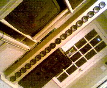

my line arrays
Oh yeah for sure. I built the most economic speakers ever. and i challenge anyone to second best me.
The line arrays have in each side:
16 4" full range pioneer drivers - 49 cents at parts express.
2 1 1/8 dayton silk dome tweeters.
the overall theoretical effeciency is 97 db. and the only speakers i've heard that have bettered theese were a 5000$ a pair B&W speaker.. but im sure a good filter and some better tweeters would fix that.
They peak real bad at around 8 khz. so a filter is almost nesesary. but theese things scream and after wood and crossovers it only cost me 100$ a pair.
thanks for your interest.!

I just tilted my monitor to see it properly!Bill Fitzpatrick said:Do you have a picture that isn't crooked?

jadenlinkletter said:sorry i forgot to attach the picture here it is
Hi-
The reason I was interested in the Pioneer 4" drivers is because I have a case of them in the garage also.
I was going to do an 8-12 driver line with a 4-tweeter line on the side.
I see your tweeters are in the center of a single line.
I hope to start with a 4 woofer 2 tweeter pair and continually add drivers until I either run out of drivers or room. 😀
the best way i found to do it was to put 16 of them. to keep the impeedence at 8 ohms. and maximize series connections instead of parralell.. because my 80X2 harmon kardon pushed them to hard wired the way they are. and then by parralelling the two daytons i gain sensitivity and drop them to 4 ohms to compensate. try my design... it cant be beat

WOW thanks RJ. thats just about the answer i was looking for. your help is very appreciated. i owe you one big time..... im sure this cusotmer will be happy with 117 db of bass in his truck... thats awesome. thanks again
would you mind posting information on your crossover for the line arrays, also the parts express number of the tweeter you used, i was plannign on doing the same thing but only using 12 drivers for each side... thanks alot
I had a friend build my a 3000 high pass 12 db crossover
the tweeter is the only 1 1/8 silk dome that dayton makes.. SILK DOME, it is by far the best tweeter for the money... even up to 30 dollars more.. this design is awesome, hard to beat for 100 bucks. but i would use 16 full ranges if i were you.
did you let the pioneers run full range then? or put a zobel on them to tame them? seems like they would be near 98db and the tweeters around 92db.. thanks for the help
yeah. kinda
the full ranges will be 98 db efficient,
the tweeters should be 96 wired in parralell. leave them at 4 ohms to conpensate for the ineficiency.
leave the full ranges full range (pretty simple haha)
