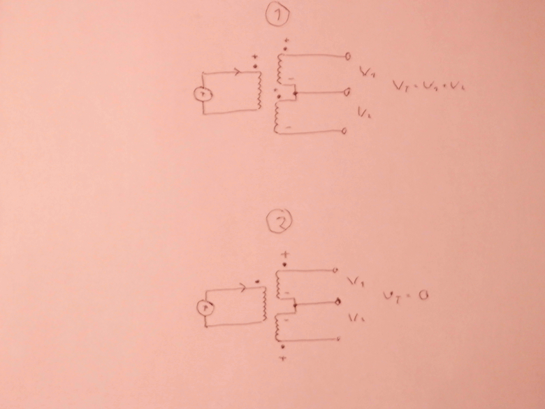

but i just had a thought... what if i wired my primaries in series...out of phase, then didnt bother with the phase inverter at all? so both tubes are in phase?
#1 is the usual PP connection. For Class A PP, this is a balanced, two-phase system that works as you'd expect. Phase voltages add (by KVL) and there is no differential current in the common (which is the case for all balanced polyphase connections). DC in the neutral will result in differential magnetization, and therefore cancellation of DC magnetization, and no need for an air gap to prevent saturation.
#2 will yield no output voltage, as the phase voltages cancel. If that side is driven with voltages of equal magnitude in phase, you have essentially a single-ended parallel connection. Any DC in the common will cause cumulative magnetic fields, and as for any other single-ended connection, you'll have a DC mag problem that will be needing an air gap in the core.

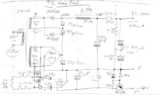

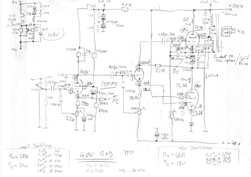

The OPT's primary is split in 2 halfes. The upper output tube only works into the lower half of the OPT while the lower output only works into the upper half. The electrolytic shown between both outputs is not a coupling cap for the OPT. Both half primaries are directly connected to their respective tube and DC cancels. AC wise however both halves of the OPT work in parallel, both single ended.
Of course I prototyped this as well, took me a while though ...
Tubes are 1xPCF80 and 2xPL36 per channel.
OPT is a cheap Indel SE which happens to have a CT brought out. The primary is cut at the CT and is now split into two parallel primaries.
