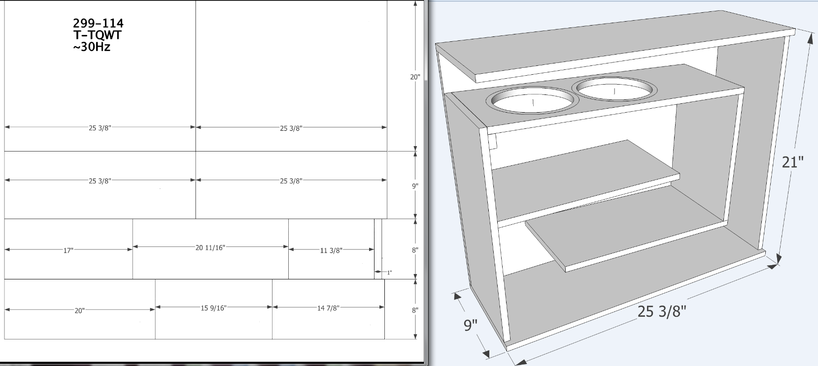

I need to pipe in with my one and only speaker idea today.....
Von, need to build this box with 1/2" bb plywood.
1/2" mdf is over $30 now, the 1/2" bb is only $40; could easily build one out of a 5' x 5' sheet.
You'll have a box that will really chug along and it wont weight much at all.
(Plans/design by NeoDan)
