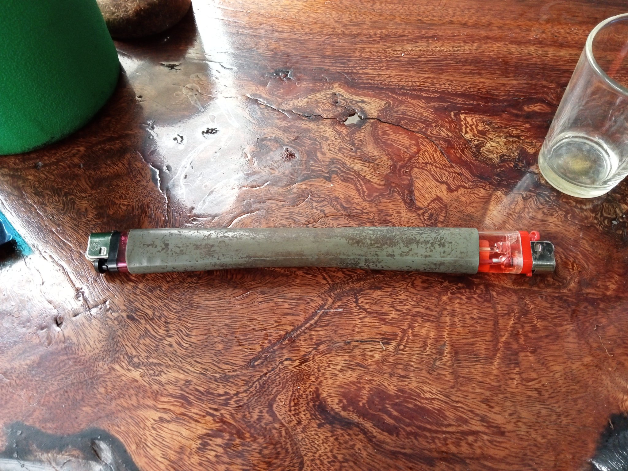

If you modify your lighter like this it will be easier to find.
Ooh , can still repair it
