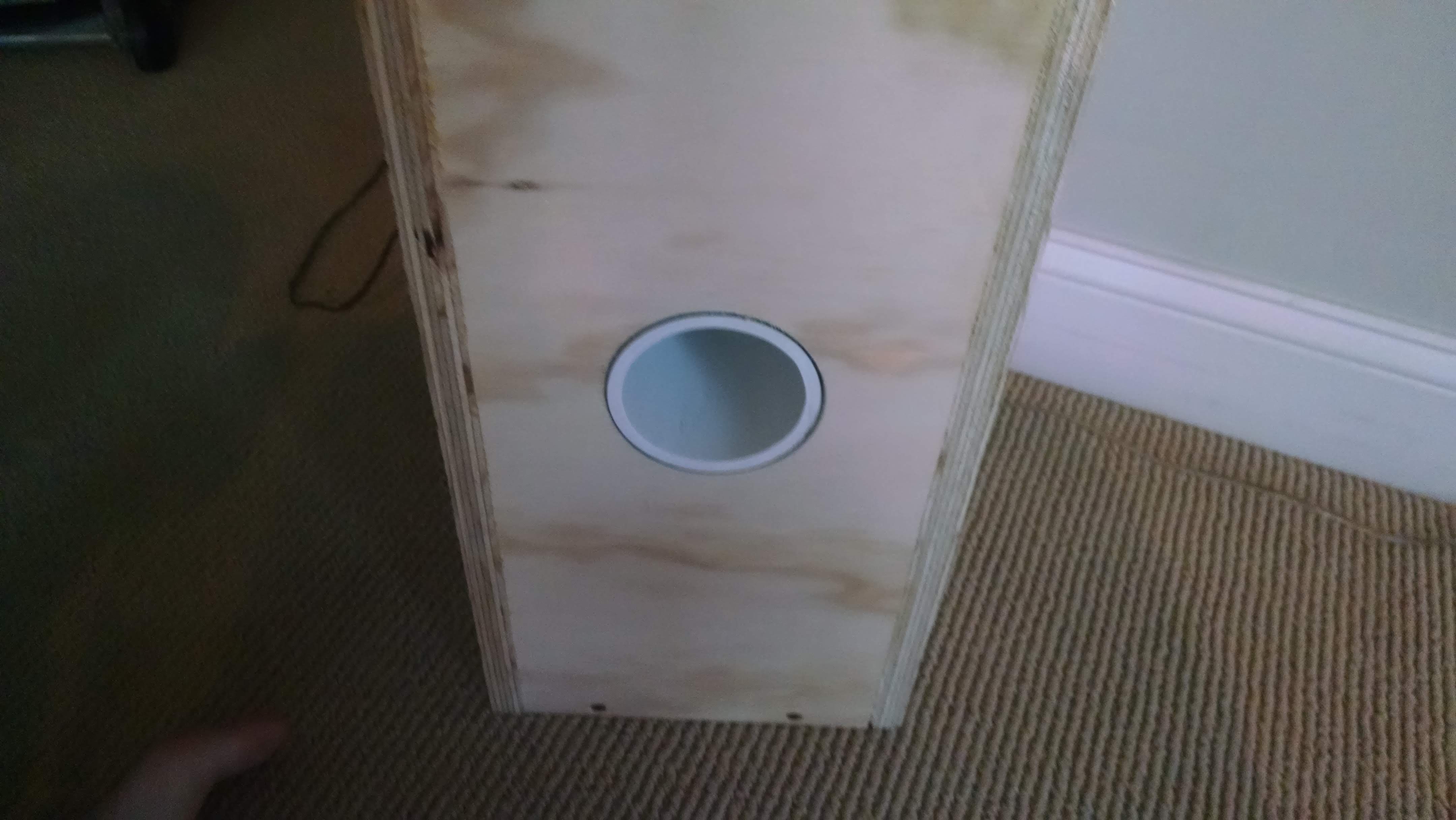

added the ports, low end is better, but I think room nodes where I am testing are making it appear less good than it is. I also am not sure about testing 3 ft from the tweeter when the port is then 2.5 ft lower than the tweeter.. It sounds much better 15 ft away in listening area. Graph is as similar measuring setup as possible in my master bedroom, tons of furniture and even me sitting right behind the mic lol. Comparison you can see the low freq gains but the whole rest is all over the place up and down. I need to measure outside in open air and then try the DSP with the REQ settings applied into it.
That may be the biggest problem we all face. Getting a decent measurement.
Even at 1m you should be seeing more bass, its omnidirectional. What does your sim model predict ? Possible causes: your enclosure might be leaking or tuning is off or narrow baffle causing loss (baffle step).

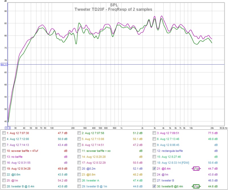

Design comparisons

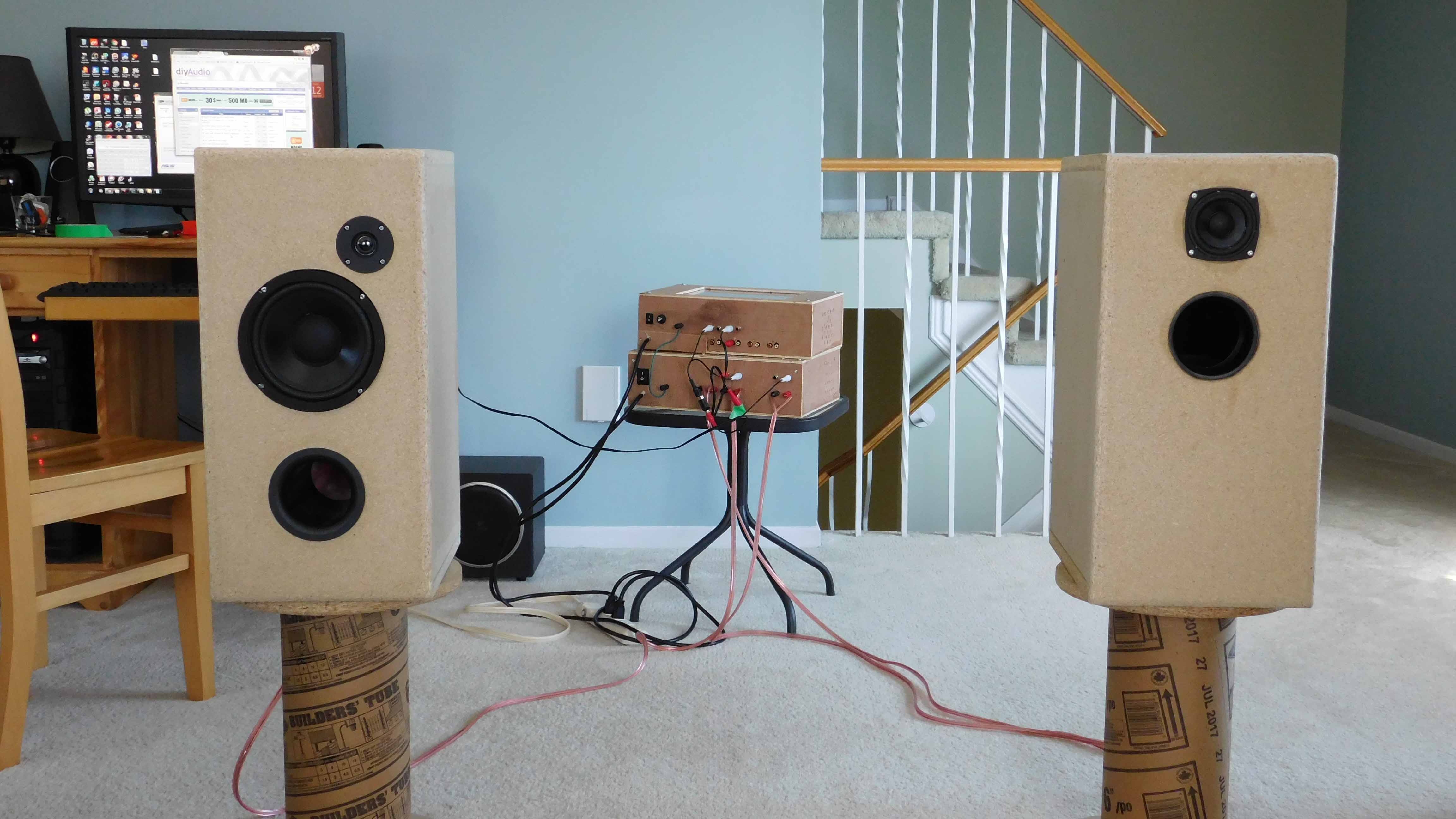

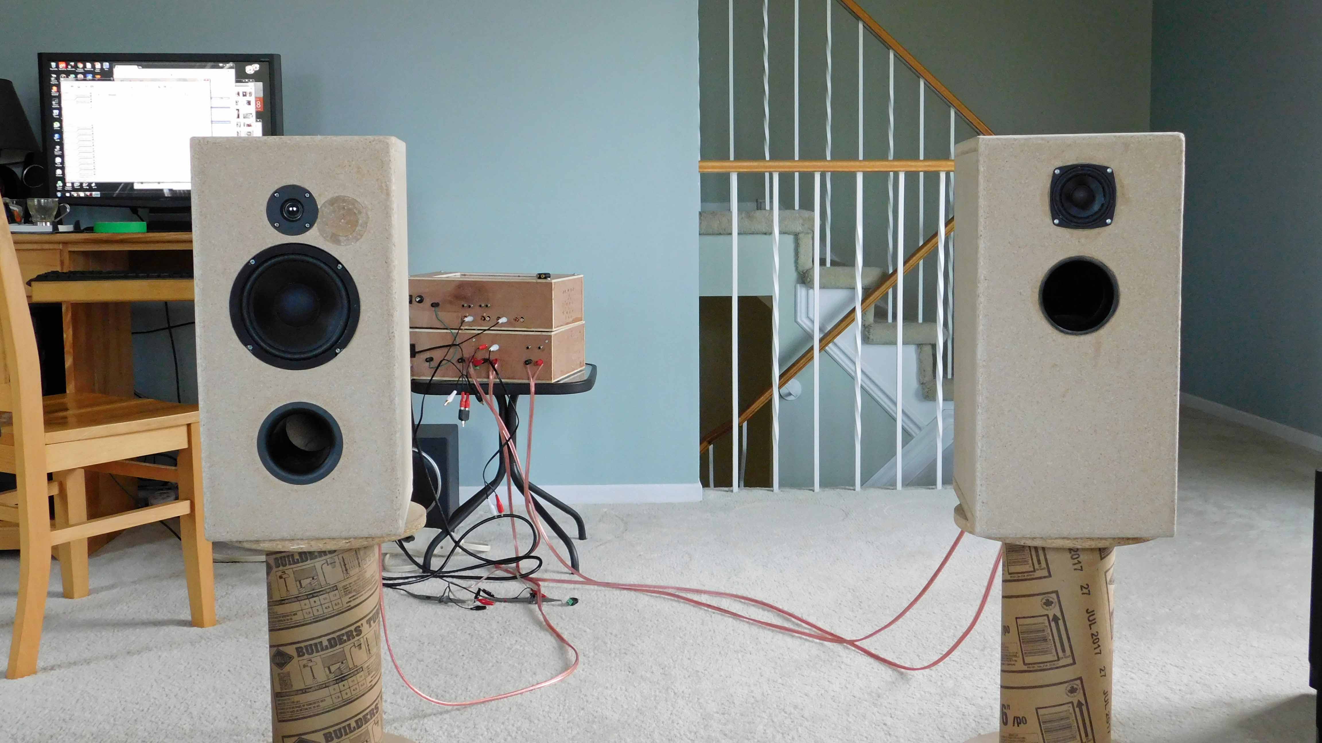

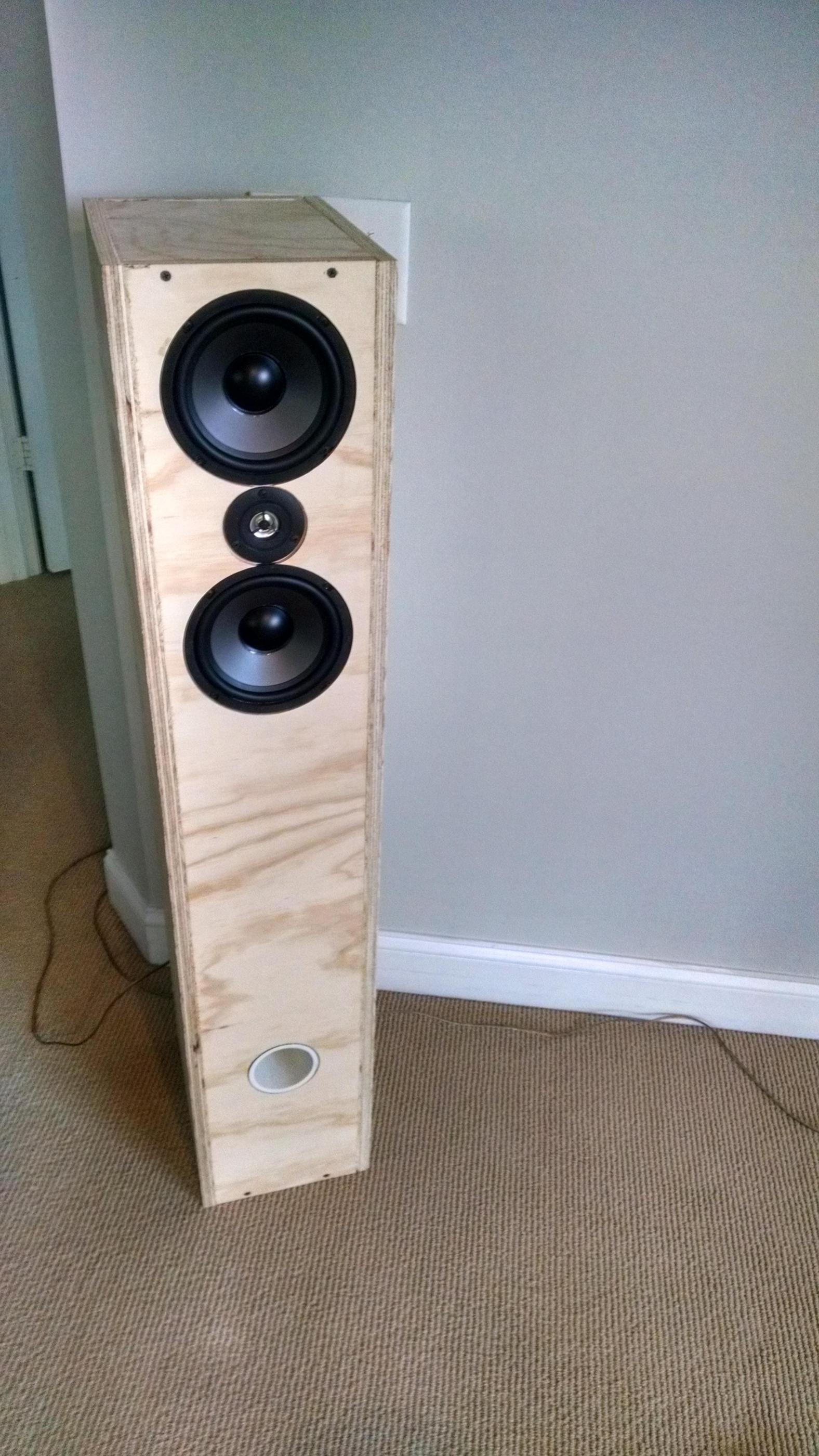

I have my two designs setup (pic#1) and compensated for the differences in sensitivity. I noticed the 2-way (left side) did not sound clean, or at least less so than the full range (right side) and starting looking into it.
I should point out that both these drivers are capable of -50db THD when connected straight to an amp. The distortion rise from the budget XO can be noticed in the woofer LF+MF bands as well.

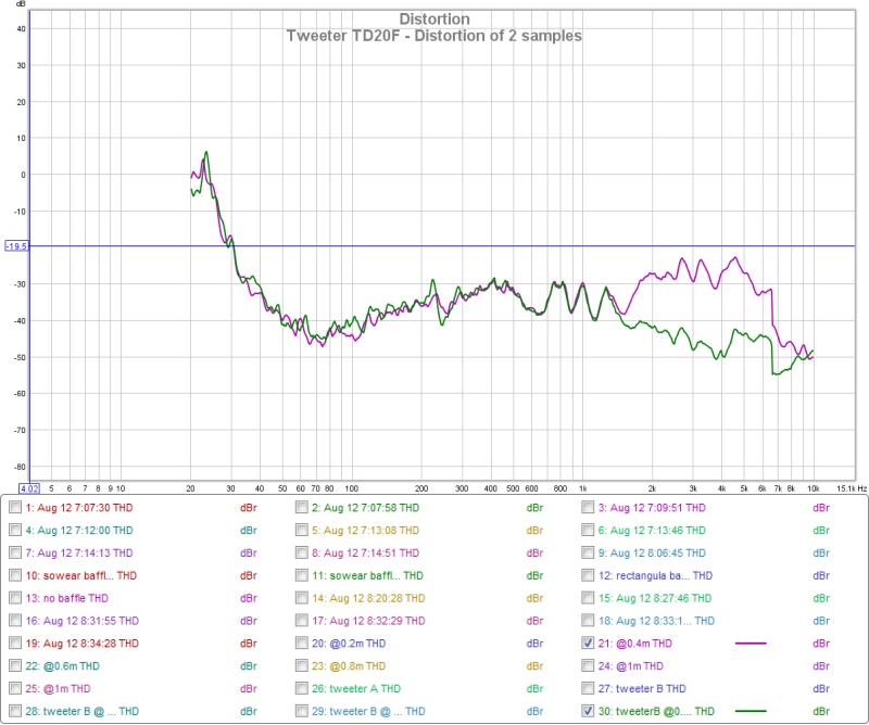

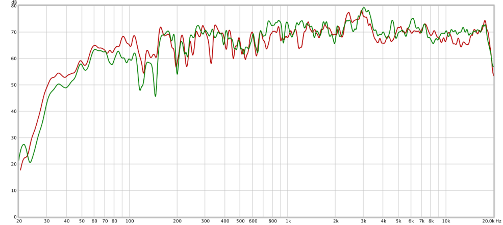

Notice the FR for the 2 tweeter samples (graph#1) is virtually the same and you would never suspect a problem. If you look at the distortion (graph#2) you can see one of the 2 samples is not working properly. I marked the good tweeter and swapped several times to be sure.

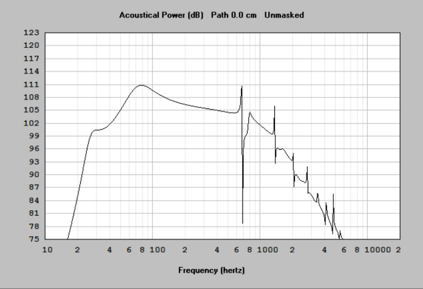

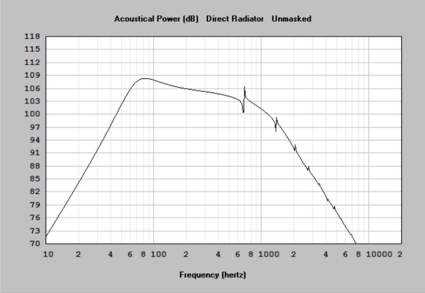

My sims are attached.

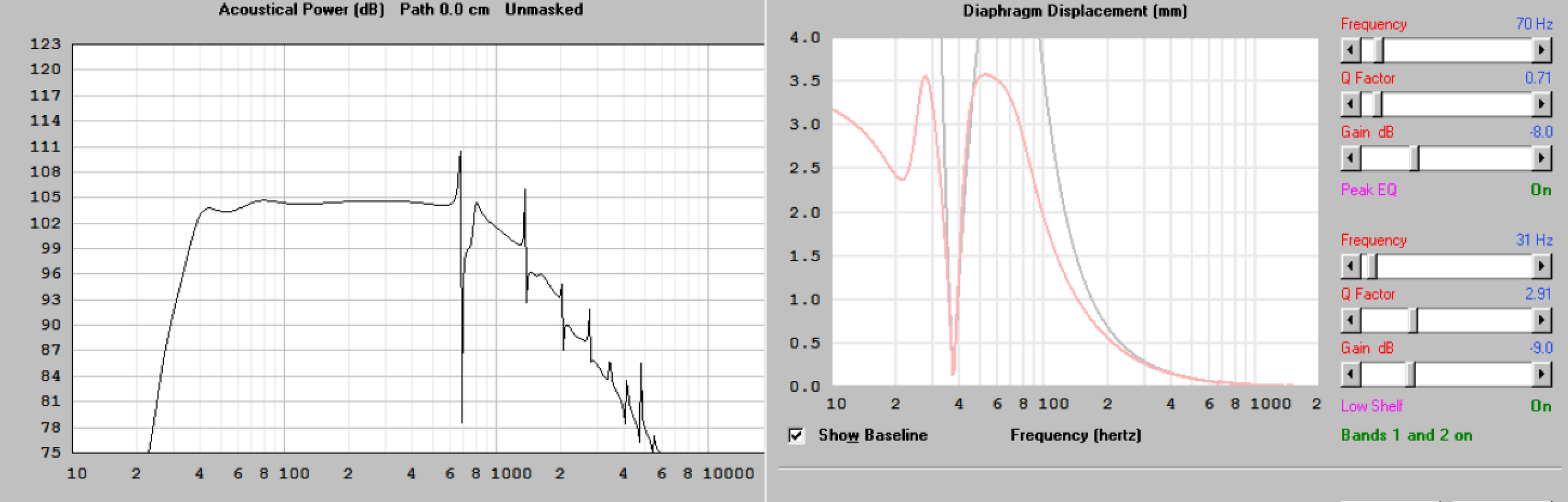

Sealed ( before I put the port in)
Ported (with the designed weird curve to work well with EQ)
Target after EQ
I planned to rely heavily on EQ to get the response flattened. I had forgotten how close the curve still is to the sealed box... They do have a lot of bass, in fact, an astonishing amount for a $30 pair of speakers! I am shocked excursion is not an issue as the simulation shows it getting pretty out of hand below 40 hz. For the EQ sim I was targeting the rated 3.5mm but maybe that is too conservative?
I will not be able to hit my EQ targets in budget, but I might be able to get at least the pam8403 5w amp and DSP within budget to flatten things. unsure how to get the EQ points though as from my understanding the DSP can do hundreds of points but room EQ only seems to do 20...
Target after EQ

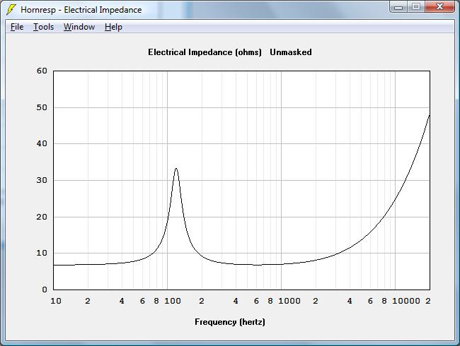

If you do a limited (20Hz-200hz) near field FR measurement of the port and then the lower driver you should be able to tell if its working properly (ie. no leaks). There should be a defined FR dip at the driver that corresponds to a defined FR peak at the port. If you add them in REW you should see the same response as HornResp.
Alternatively, if you're setup to measure the impedance of the speaker you will see 2 peaks and the box tuning is midway between them.

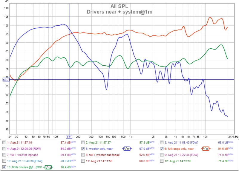

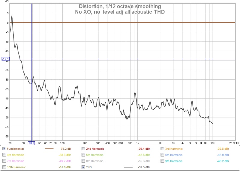

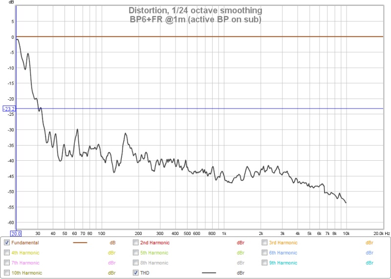

BP6 + FR
I've been listening to both designs and focusing on the BP6 (right side, pic#1). The BP6 has some mid band residue from the port that could have been reduced if I put the port and fullrange driver on opposite sides. The problem could also be fixed (checked in Xsim) with a 1st or 2nd order LP filter on the BP6 @600Hz. Instead I'm temporarily using an active bandpass to eliminate the midband residue and balance the driver sensitivity differences for testing.
The speaker FR and THD are shown in the graphs. The bass is excellent, but I am biased, and like the sound from series tuned BP6. The full range is another issue. There is nothing wrong with the swept sine measurement or the THD measurements. The peak at 13Khz-17Khz could be notched down to make the FR flatter but it doesn't bother me.
The problem occurs when the fullrange is moving alot (> +/-2mm) during music content with bass. It seems to go muddy, loose clarity and detail. I was listening at moderate levels (90dBc @1m measured) and every time there was significant LF, you could see the driver flapping, and hear the detail fade. I should try a superposition signal test [0db@80Hz plus -10db@1Khz plus-20db@5Khz] to see if it can reproduce the detail when following higher amplitude LF.

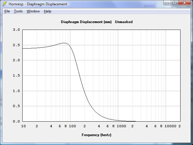

The fullrange displacement is the fundamental problem in the design and its inherent. You can change the chamber volume but you'll still get the excess LF displacement. I've added a few pics for what's happening at 90dB (4watts@PC83), the hornresp displacement measure is peak (mm).

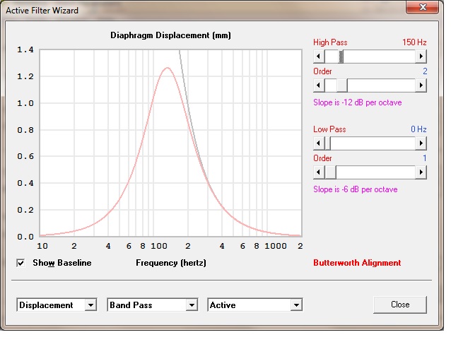

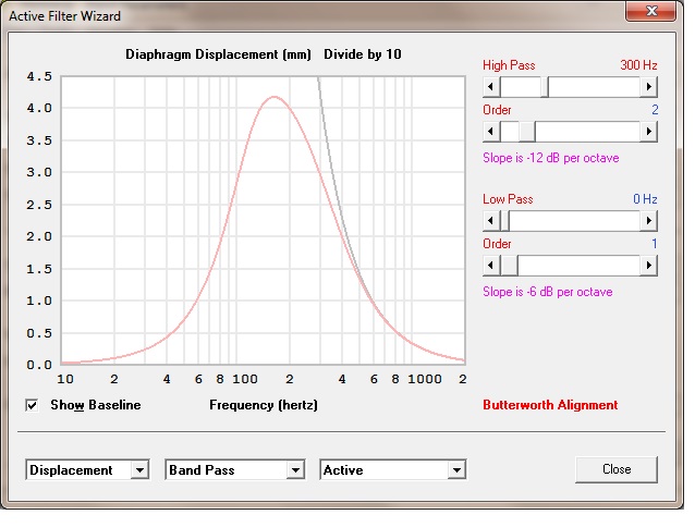

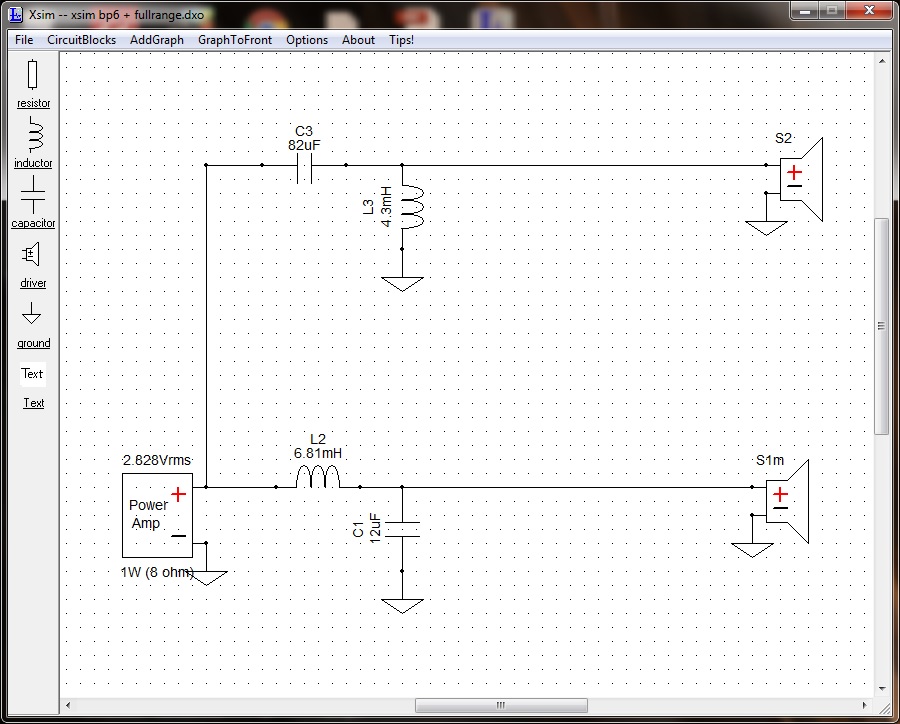

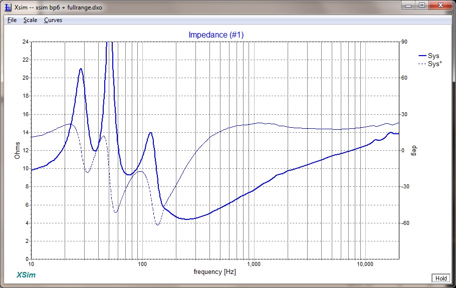

BP6 with filters
Originally when started this design I wanted to see if I could get away no electronic XO and do it all acoustically. It does work but there are some SQ issues. Out of curiosity, I tried playing around with XO filters to see if it's possible to fix some of these SQ issues.

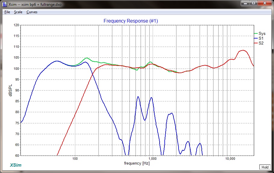

Below are the Xsim pics for a filter and their response. Good news: there is a way and the final response looks close to what I have already. Bad news: it requires passive components that are way too large and expensive, so it's not happening.
Ideally (as suggested @drewmc) if I crossed at the higher freq (>200Hz) the driver displacement will be reduced (pic#5 xo@300Hz). Unfortunately, I can't shrink the full range's chamber volume that small and I can't convince the BP6 to go that high. The pics (#1-#4) are for 90db (4watt), with XO=150Hz. Still looking for an acoustic solution.

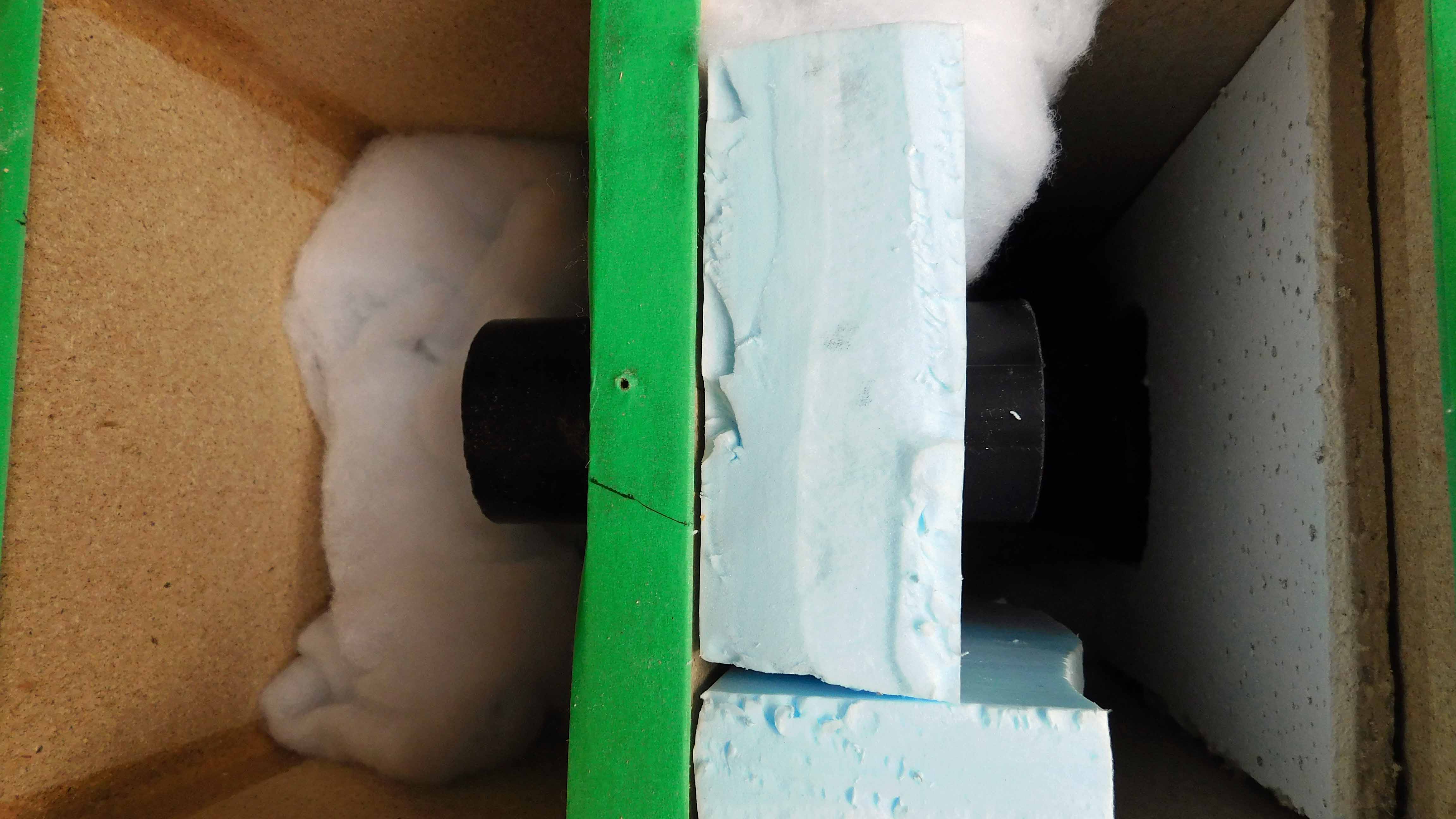

BP6 + fullrange, all acoustic no XO
I've been thinking some more about the suggestions from @drewmc.
The fullrange chamber has been reduced to approx 0.3L. The chamber was completely filled with polystyrene blocks and polyester fill. The rolloff starts at nearly 180Hz now.
The BP6 front chamber was reduced by approx 4L using polystyrene blocks. The wall in front of the TC6028 driver has acoustic tile to absorb MF. The front chamber has approx 30% poly fill and the rear chamber has 80% poly fill. The front port elbow was rotated to point away from the driver to reduced MF coupling. All of these changes attenuate the MF residue, raises the upper rolloff point causing a hump, and softens the lower rolloff edge. The LF level is still slightly (2-3dB) higher than the full range so it "appears" to meet (cross) at a higher frequency.

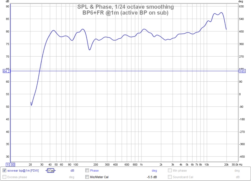

At my listening level (+90dBc @1m) the full range driver is only moving +/-1mm during content with LF bass. It's no longer flapping about, and the detail is back. I'm sure the problem would return at 96dB, but then that's probably unrealistic from a 3" full range driver. I still have some BP6 residue at 800Hz, which could be solved by putting the port and driver on opposite or perpendicular sides. Both drivers are driven at the same electrical level straight from an amp, there is no XO, there is no level adjustment, its all acoustic. It sounds good.
