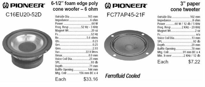

Can we try this again? I've looked around, and I've identified the 2 Pioneer drivers, at least close if not exact. I've attached their specs.
I also bought some surplus NHT 3-way crossovers (for their HDP2 speakers, 2 tw, 2 mid, 1 wf) to use. The crossovers are 200 & 2800 Hz xover, 12 db rolloff, 2 tw push-pull, 2 mid push-pull, 1 wf. Good quality, and I've got no problem desoldering them for components, or cutting traces to make a 2-way.
Any advice? Could I possible find a good midrange to match these 2 drivers?

Just thought I'd close off the thread with the final results.
The setup: the 6.5" woofer straight up, and the horn tweeter with 6 uF and 24 R in series.
Not a silk purse, but better than either of the donor speakers.
