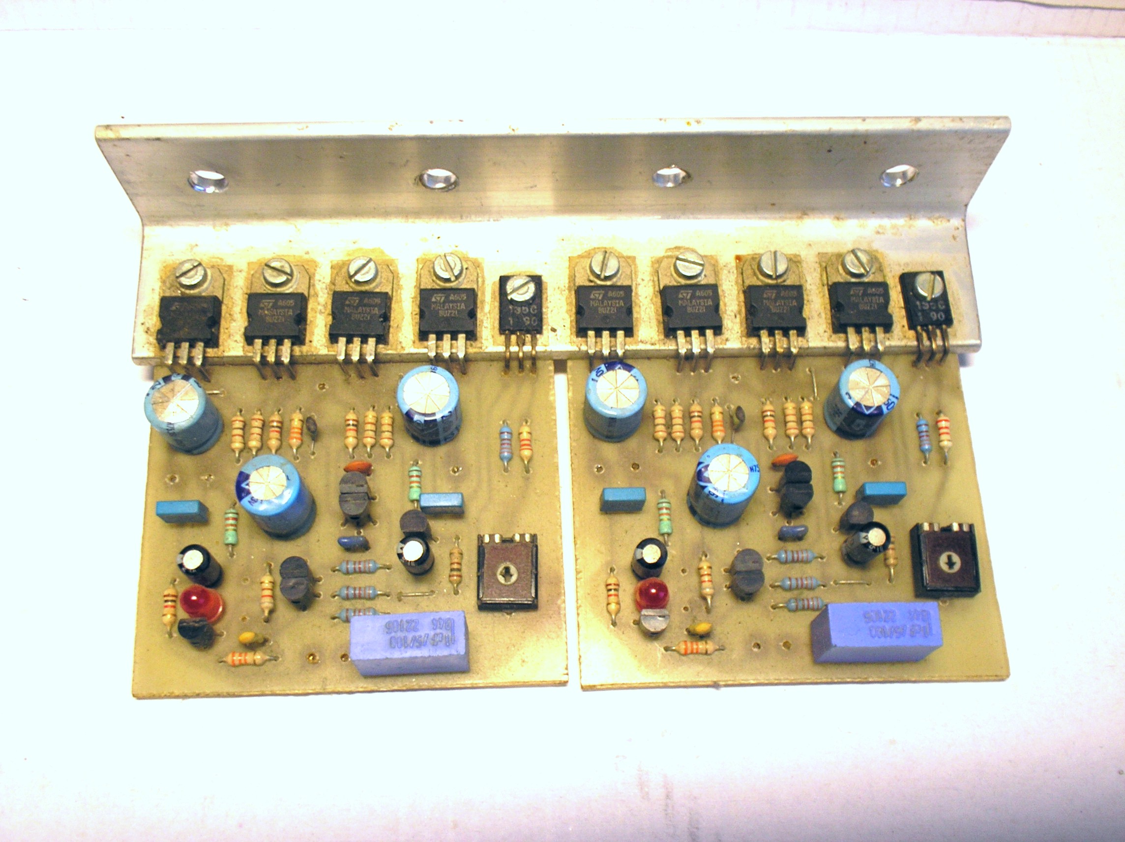

apexaudio, in another thread you have reported the existence of another BUZamp implementation, with a picture.
http://www.diyaudio.com/forums/solid-state/163159-150w-mosfet-amplifier-irfp250x2.html
I have taken the liberty to attach your picture here, in my post. Please see no offence. Can you provide us more info about this very interesting implementation :
- what is the thermal management ?
- how the two NMOS get put in parallel ?
- no source resistors anymore ?
- any over-current protection ?

3 - the one that got reported by apexaudio (see picture showing 4 x BUZ21) (no schematic)

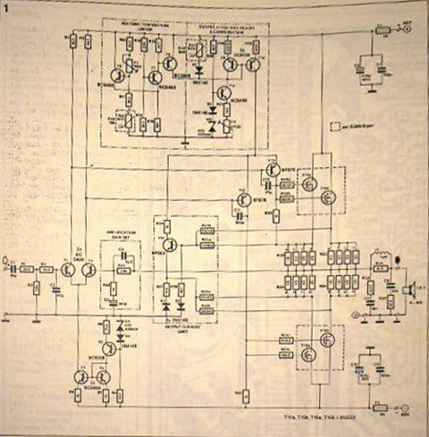

from apexaudio, here is the Elektor BUZamp, more or less readable. As expected, this is a bloated version of Etienne Lemery - Siemens BUZ20 amp, here with four NMOS. One can see the two thermistors in the 2nd differential pair current source. One must be for Iq regulation, and the other must be for thermal shut-down. One can also see an over-current protection, measuring the voltage drop on the low-value output resistors.

In Elektor was four different aplication with BUZ21 and BUZ23, try to find original.
Yes, (only three different) but by the use of the same PCB board. There are places for TO-220 outline (BUZ20) and TO3 (BUZ23) on the PCB:
1) 2x60W/4 ohms (+/-33V, 2xBUZ20)
2) 2x80W/4 ohms (+/-36V, 2x BUZ23)
3) 2x120W/4ohms (+/-40V, 4xBUZ20)

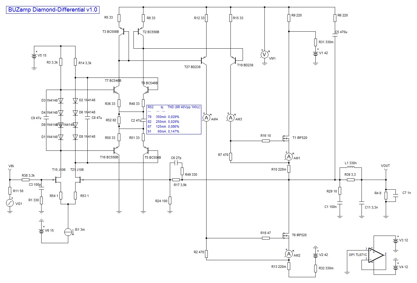

let me now introduce a BUZamp variant, free form the inherent current limitation discussed in the previous post.
The trick is to rely on a sort of "current-feedback" topology, enabling the correction current to be an order of magnitude greater than the nominal operating current.
Some won't understand why this scheme can be called "current-feedback". I won't argue here. They will argue that the output voltage gets sampled and returned to the input, also in a voltage form, so why bothering people with "current feedback" stuff ?
Other people may say that the internals of the amp are not anymore Class A, becoming Class AB. This is true, also.
What really matters is to understand that massive current can now be pushed from the collectors of the 2nd stage (that now becomes the 3rd stage). The last stage is operating at about 8mA rest current, but in case of need, the collectors will push currents in excess of 30 mA. When this current meets the 470 ohm, a voltage of more than 12 V can appear, putting the MOS in total conduction, with a resisdual Rds that is no more than 0,1 ohm.
Voilà ! Magnifique !
I order to to this, we need to add 6 low current transistors on the native BUZamp implementation. Those 6 extra-transistors are arranged in a compact and symmetric way. Some educated people will recognize the Sansui Diamond-Differential arrangement.
Special attention must be paid to the resistor joining the two halves of the diamond. The value of this resistor defines the quiescent current of both NMOS at the output.
A value of 91 ohm gives 60mA Iq.
A value of 79 ohm gives 350mA Iq.
The amp that gets described here, has now a moderate open-loop gain.
Therefore, the 1Khz distorsion figure depends on the Iq that's chosen.
A low Iq of 60mA gives a THD of 0,147% 8 ohm load, 40Vpp 1 KHz
A high Iq of 350mA gives a THD of 0,029% 8 ohm load, 40Vpp 1 KHz
That's decent but not fantastic.
There is a boostrap scheme allowing the output to swing within 3V of the supply rails.
The 10 Khz square wave is very nicely reproduced with a slew-rate defined by the input low-pass filter (3,3K and 100p).
Actually, if one puts very sharp edges at the input, without a low-pass filter, the circuit is so rapid at turn-on, that it throws 15V spikes on the NMOS gates, that take a while to discharge along the 470 ohm gate resistor. This causes very brief but very high NMOS crossover currents in the order of 20 Amp, quickly destroying any normal power supply and any normal decoupling capacitor.
This very fast circuit NEEDS a low-pass at the input, in order to protect himself, and to protect the power supply and decoupling capacitors, from very harsh crossing spikes.
I repeat : those crossing spikes do occur because the 470 ohm on the gate cannot actively discharge the gate-source capacitance. One of the NMOS thus stays conducting for a while (say, half a microisecond), while the other NMOS already enters very rapid conduction. That's quite bad ... but is not likely to happen if a low-pass is put at the input.
Something to be tried is to add an active gate discharge circuit. The most simple one consists on a diode + NPN transistor.
The attached .zip file contains the Tina 7 T.I. schematic ready for simulation.
Comments and questions welcome,
Steph
