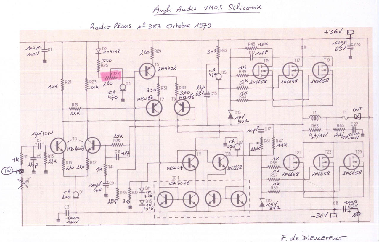

Here is the Siliconix audio amplifier (published in October 1979, when VMOS hit the mass market).

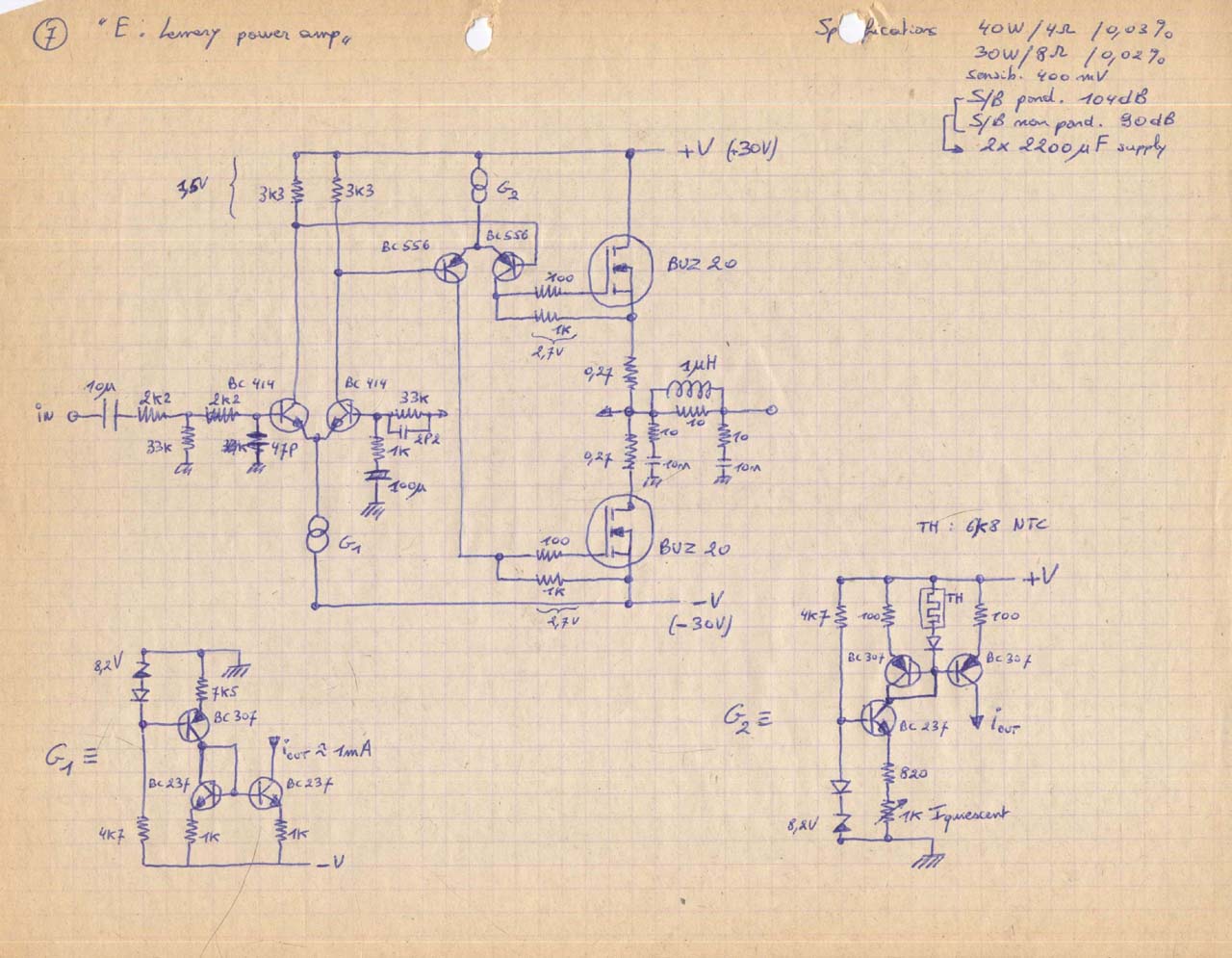

Here is the Siemens BUZ20 application-note audio amplifier (published in 1982 maybe, when SIPMOS hit the mass market).
See attached files.
I guess audio freaks will love them, as they are non symetric, non complementary. If global feedback doesn't ruin everything, one can expect a smooth harmonic content with H2, H3, H4 and H5 showing in a nice undisturbed parabolic profile.
But, what about dV/dt ?
But, what about Class-B crossover distorsion ?
But, what about thermal stability ?
The Siliconix audio amplifier may not work, as F. de Dieuleveult (French Journalist) was known for making mistakes (distraction mainly) upon publishing articles. A proof of this is that the bias setting procedure he is describing, is completely nuts, referring to non-existing components. No doubt he re-numbered the components on the schematic, after he finished writing the article !
If somebody can provide a link to the genuine Siliconix application note entitled "DA76-1 - The VMOS Power FET Audio Amplifier", it would be fantastic.
What do you think about the Siemens BUZ20 application-note audio amplifier ?
I'm quite sure this worked, as it got published as a DIY mini-amplifier by the magazine Le Haut-Parleur (France and Belgium), authored by Etienne Lemery, who was (is still !) one of the best audio journalists here in France, always in serach for excellence.
If my memory is good, Dieuleveult s amp was published in the french
review Radio Plans.
A refined schematic, as often with him despite some mistakes
as his 2 X 150W amp that did blow the output devices automatically.
Hey, he did use a single pair of 2N5631/2N6031 in his first try.
A month later ,he upgraded to four pairs..
He published in the same review a preamp using discrete op amps
that was truly wonderfull.
The Spice simulation shows that the Siemens - Etienne Lemery amplifier delivers clean results with excellent bandwidth and slew-rate.
See attached .zip file. It is containing two Tina 7 Texas Instruments files ready to be simulated.

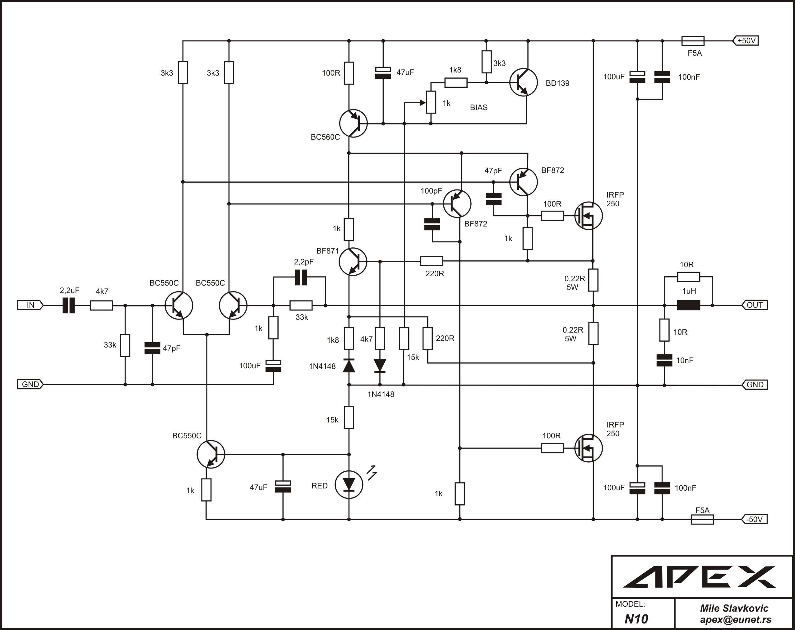

I am sorry Steph, I was made some simplier version in 80', and I share that. In a future, anything about this amp I will post on this thread.
Regards Mile
Regards Mile
Hello Mile, seems a good idea as the other thread has drifted, and is not concentrating anymore on the lovely simple Siemens BUZamp. I'm definitely sure there is a future for the Siemens BUZamp. Shall we design an add-on for getting a Class AB Soft Non-Switching Siemens BUZamp, following kenpeter research ?In a future, anything about this amp I will post on this thread. Regards Mile
Their is a mistake in the right hand drawing the resistor is shown in the drain of the bottom buz20 instead of the source!
regards Trevor
regards Trevor
What makes you saying this ? If you are basing on another Siemens BUZamp implementation, it would be nice to share the schematic.There is a mistake ... the resistor is shown in the drain of the bottom buz20 instead of the source.
The function of the resistor is to assist in bias stability wth a v fet however if the resistor is in the drain it has no function !
regards Trevor
regards Trevor
lol 😀 I agree that it'd help more with bias stability connected from the source to negative rail.The function of the resistor is to assist in bias stability wth a v fet however if the resistor is in the drain it has no function !
regards Trevor
No idea what it's doing there on the drain other than looking like it makes things look symetrical at the output, it's just an illusion 😉
Not your amp Mile, we are refering to the Siemens BUZ20 amp schematic 😉Resistors are there for current limit.
Yours looks pretty interesting btw & i already sussed out it's modus operandi.

My amp is based on BUZAMP, Steph just not draw complete schematics.Not your amp Mile, we are refering to the Siemens BUZ20 amp schematic 😉
Aha, so what you are possibly saying is that the drain resistor probably has a use for current limiting & we haven't got the full schematic 😀My amp is based on BUZAMP, Steph just not draw complete schematics.
Ok, fair enough. But the resistor is useless where it is unless it does something & right now with the circuit as drawn it does nothing other than lower the efficiency 😉
About the 0.27 ohm resistor in the lower NMOS drain,
seems some of you are forgetting that the bias current is defined by the voltage drop that's developing on the 1K resistor.
Look the top NMOS. Clearly, from what is stated above, the 0.27 ohm resistor doesn't affect the bias, the 1K resistor being returned to the source, and not encompassing the voltage drop on the 0.27 ohm resistor.
Look the bottom NMOS. Knowing that the bias, over there, is also defined by the voltage drop that's developing on the 1K resistor, one gets the choice where to place the 0.27 ohm resistor. I guess Etienne Lemery wanted to deliver something conventional, looking symetric. Therefore he put the 0.27 ohm resistor in the drain of the bottom NMOS.
I agree that the real symetry, once the topology is understood, was to place the bottom NMOS 0.27 ohm in the source, same layout as the upper NMOS.
But I repeat, this doesn't affect the bias, in such circuit.
One may simulate and test a different circuit, putting the bottom NMOS 0.27 ohm resistor in the source, and returning both 1K resistors not to the sources, but to the output for the upper NMOS, and to the negative rail for the bottom NMOS.
This different circuit will exhibit some degree of quiescent current negative feedback.
That's easy to understand : if the 0.27 ohm is developing a voltage (strong quiescent current), this voltage gets substracted from the actual NMOS drive voltage (voltage developing across the 1K resistor, less voltage developing across the 0.27 ohm resistor).
But wait a minute. When the current is about 5 amp, the voltage on the 0.27 ohm will be 1.35 V. The NMOS drive will get significantly decreased. This makes the output stage not working as voltage source anymore, but working as a controlled current source. Don't know if this is a good idea. The open-loop gain of the amp will need to battle against this kind of current drive mode.
Am I right ?

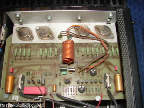

hi tiefbassuebertr,
thanks for your fantastic post. Nice contribution. There is a mass of information inside, I still need to process.
From your post, I grabbed one of the pictures on eBay. It would be nice to read the schematic of Elektor BUZamp ! From the picture, I see :
- 4 x BUZ23 NMOS
- one differential pair at the input
- 6 small signal transistors in the right side (two current sources ?)
- 2 medium power transistors (2nd differential pair ?)
- two temperature sensors on the heatsink (linked to the current sources ?)
- left side maybe protection circuit (4 small signal diodes, 3 small signal transistors, 1 medium power transistor)
Looks like a bloated Etienne Lemery - Siemens BUZ 20 amp.
I am nearly sure that in the links you provided, we'll find some people trying to reach a Class AB Soft Non-Switching operation.
This amplifier structure should not be confused with others NMOS amplifiers, that we may call semi-complementary. Here, we are concentrating on an amplifier's structure that's definitively turning away from the semi-complementary concept. It is a pure non-complementary concept. And I like it, and I think there is a future for it.
Steph
