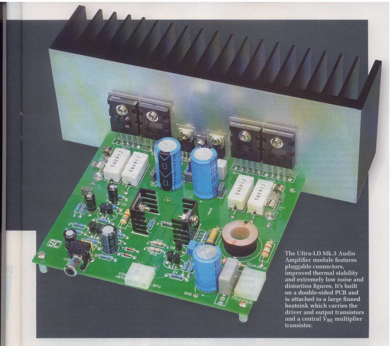

The version I built worked well, I followed all the instructions that came with the K5151 kit, but in my opinion it is the least of my many-amps, in terms of listener satisfaction.
I only have a few criticisms of these ThermalTrak kits and the instructions that come with them. I do not mean to insult the designer, but think the whole idea was rushed into production at a time when it should have still been on the workbench at silicon chip.
From an enthusiast kit builders viewpoint I would like to say the following:

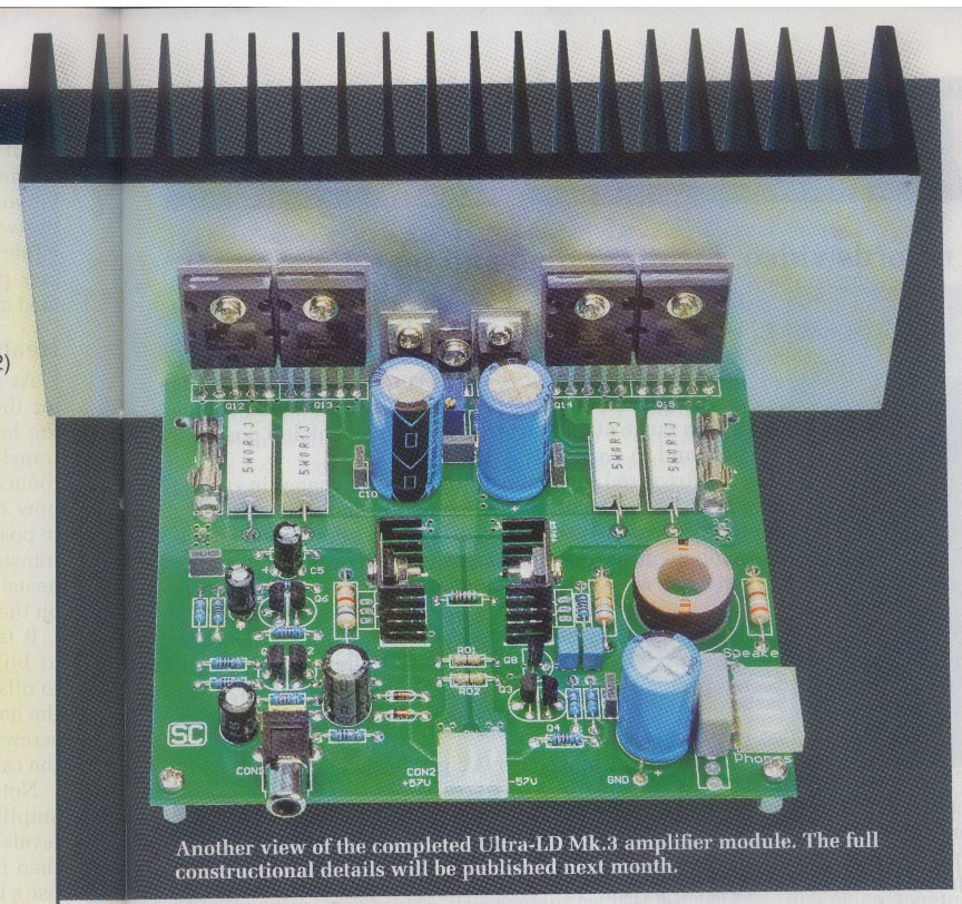

The instructions are essentially photocopies of the relevant Silicon Chip Magazine articles, some of the printing is illegible and of course there is no coloured ink, this is a BIG issue when it comes to tracing tracks through the two layers and apparently, unlinked vias. - In the magazine, it is still difficult, but there are many colours and shades to help you find what you are looking for.
Whilst on the subject of the K5151pcb, I can see no real need for two layers. Secondly, I am very disappointed that the pcb designer placed one huge cluster of vias directly under the output resistors on the LHS of the board when you are looking at the heatsink's shiny side, a location where we attach the multimeter (to measure Iq). These vias are part of the positive rail - short the resister to the via and watch your dream go up in smoke. That smoke really stinks and the soot from the plastic shoots out and scorches those giant 85 degree 1000uF rail caps that sit next to the heatsink.
Whilst on the subject of Iq adjustment my particular board was upgraded to MK3 standard using the instructions set out in silicon chip sept 2011 (exactly). The 1k trimmer on the vbe multiplier had no effect on Iq whatsoever - which left me wondering why I went to the trouble of etching the pcb which hangs like a penis from the top of the heat-sink. The wires of which attach to various pads across the length and breadth of the pcb and look like the type of antenna used for a ham radio base station. Luckily for me the Iq was spot on 60mA for all four output transistors on each board - that is 6mA across each of the 0.1r output resistors.
ThermalTrak transistors have five legs: so when you smoke all four of them whilst doing the Iq adjustment, you are going to have a bit of trouble getting them out of two layers of track-work. OK you might get away with smoking the two pnp's but you cant get the npn's out to test them, without cutting the 5 legs on each device and removing the stubs singularly. They are very expensive to buy, and if you are using the Vbe of a BD139 then the ThermalTrak device is obsolete.
Finally, If any of you are as careless as me when you do your Iq adjustment, don't expect the Silicon Chip K5124a1 speaker protection module to do anything until at least 500mS after the ThermalTraks have vented and the 5A fuse has blown. Silicon Chip recommended a 6.5A but I used a 5A. Although I believe the fuse blew & the relay tripped simultaneously after the event and it seemed like a second or more later.
Alright I was having a bad hair day yesterday! The 1k trimpot in the Vbe multiplier does actually work, but I only discovered this yesterday. For some reason or other my amp(s) both ran at 6mV/0.1 resistor at the get-go, I wound the pots up and up and up to what seemed to be 20 1/2 turns and dared to go no further, assuming I had made a blue when drilling out the pcb track joining the NJL's diodes.
I put the safety resistors back into the fuse holders this morning and tried once more - to find (much to my surprise) that the pot finally increases the voltage between the drivers on the last turn before it starts to click click, where it becomes very peaky and a gentle hand is required. I now have 100mA through all the output transistors.
Farmer,
you could instead have measured the bias voltage. This changes progressively as you adjust the VR in the multiplier.
Try it now.
You will see that as the Vbe of the output device approaches 500mVbe that the outputs turn on
Most of the VR adjustment is in bringing that Vbe up from 0mVbe to 500mVbe.
