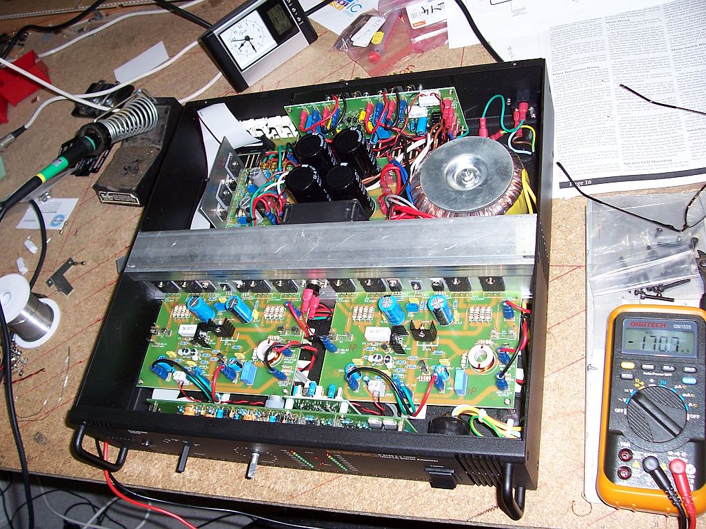

Hey, I just made one.
Matter of fact I just powered it up about 2 hours ago. Bought as a kit and it has a 5-star difficulty rating and they weren't kidding. I really didn't enjoy making this amp. It is to replace my old 50+50 watt 53 kilogram mosfet class A lump. In the 7 or so years since made that thing I have lost a lot of interest in hifi and also my ears have a bit of tinnitus. Turned on the new amp, played a single track to see that it worked and then went off to do something else. If I had realised how much work it would take to put this new amp together I think I would have paid someone else to do it.

A few comments fly in the face of the ULD Mk1 design brief in this thread. The ULD amp is an "8 ohm only" design, and yes, you would expect it to have problems supplying high current into 4 or even 6 ohm loads. That's an unfortunate choice and even the 300VA toroid, is only just enough for that.
The unusual design choices, I expect, were as much to avoid plagiarism as try other variants from Self's list of options. The design first appeared in 1999 as an electronic hobbyist's project, mounted in a mid-tower PC case for cost reasons. The concept was not what we now commonly seek in amps. As Greg referred to the later Altronics makeover kit, you can see how tight things are in Circlotron's kit build. At the special price, I think you still have a great amp and there's little stopping a retrofit of the newer ULD II EF thermaltrak modules and removing the regulated input stage PS, if the CF topology offends you.
There has been a huge amount of discussion and development since DIYAudio went online and popularised High-end design at budget prices. Commercial kits like this one are virtually as costly as a retail product so the price will reflect a lot of economies we may not, in our enthusiasm, wish to make. To supply a 100 W kit to current standards with the features of the ULD kit would cost more like $1,000 AU now.
I reckon you did well for the money there Circlotron, I hope it runs like a dream. I'm very happy with my "A" class choice for all the hassle the kit saved me. Now, we just need a few worthwhile simple mods to tweak it. If Sandyk is about, I'm sure he'd be willing to share.... .
That's interesting and cetainly a real bargain, Agisthos. I guess you have the Altronics kit which was based on the first, rather complex, design. 'Nice kit though and many say it sounds better than version II with the simplified Thermaltrack output stage or even the newest, MKIII version.
I think there may have been some hasty conclusions drawn there since you can't simply swap the amplifier boards for fair comparison. There are separate. regulated supplies to the input and cascoded VAS stages for starters.
