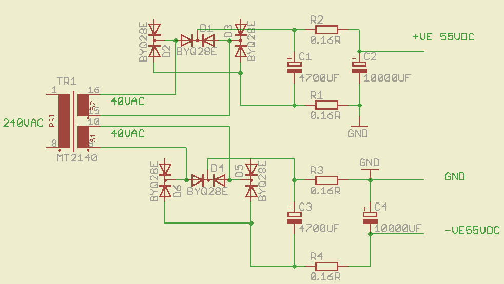

Possible PSU
The Power Supply
After much viewing of the Robert Cordell Power Supply thread on this site I came up with the following circuit
Using the Jaycar torroid MT2140
4700uf 63v caps from WES were $2 each
10,000 100v caps from WES $12.75 each
BYQ28E RS 594 4629 Diode recommended by Hugh Dean AKSA Site
The theory goes towards decoupling the DC output ground from the noisy diodes and transformer secondary, we may need the toys from the boys in order to verify this, the 25ns diodes definitly make a difference.

OK, I got that far successfully! 🙂 I ran it for a couple of hours and all went well.alfredrofe said:It may be best to make the standard kit up then start modifying, this is get it working first.
A suggestion for those like me who don't have much space or equipment - I got the drill-press attachment for my Dremel, plus a small set of drill bits that can fit the Dremel's various collets. Using this plus WD-40 as lubricant I got the holes done in no time. I didn't use a tap, so I simply used tweezers to stick the nut through between the heat-sink blades. I've never drilled metal before, so it was a bit intimidating, bit by the time I did the 2nd heat-sink the whole process only took a few minutes.The kit does not come with enough screws for the complete mounting, using a cast heat-sink you may need to invest in a 3mm tap and a 2.5 mm drill to thread holes, through holes a a little difficult with the suggested heat-sink.A I have a rather extensive workshop with both sheet-metal and turning capacity I make most of my own boxes etc, but for those with limited resources seeking some help may be required or finding someone with the tools and even grater someone who will lend them to you. A challenge in deed.
OK this is where things fell apart for me... 🙁 I put in the trimpot (having set the resistance to 8Ohm), fired up the power again, and after 30 secs one of the 100R emittor resistors flared. I replaced it, checked for short circuits, and tried again. Now the other one flared! I haven't tried anything further yet. To cut the track, I just drilled through it using a bit wider than the track. I then scraped back the track covering on each side, and soldered directly to that (the solder didn't seem to 'stick' to it very well however). Any thought about what I may have stuffed up, or suggestions for how to do it next time?A 100R trim pot is soldered to the top track (runs diagonally towards the 1000uf cap) on the board in front of Q13 collector after cutting the track and remove the solder mask for soldering, this allows setting the bias within the better 100ma Class AB setting
Is it OK to leave the heatsink off whilst doing these tests and modifications? The transistors didn't warm up at all in the 30 secs it took for my resistors to blow...
Have you got a diagram or something you could possibly email me? I'm still stuck on what this is meant to look like.Remove the two 100R emitter resistors on Q10 + Q11 replace with one 220R resistor and 1uf capacitor, the 1uf cap is a standard in this position and as OStripper points out you can tune the circuit to you liking. I drilled two holes in front of the transistors Q10/11, on the under side I bent the wires to join to the emitters of Q10/11 and piggy backed the cap on top of the resistor.
Many thanks Alfred!
Well, I tried undoing the change by removing the trimpot and adding a jumper over the break in the track. I also followed the advice in the SC article and replaced the fuses with 5W resistors for testing. No luck - more burnt out 100Ohm resistors!Any thought about what I may have stuffed up, or suggestions for how to do it next time?
I think I'll chuck out this kit and get another one - at least I can still keep the PSU, bridge rectifier, and heatsink, so it's not too much money wasted. Since I bought 2 for stereo, I've already got a spare I can try again with...
