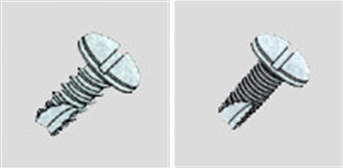

Do you suggest using a manual tap, or a drill?
I clearly need to buy a bunch of taps for testing. I'll keep my dead heat sink for practising on in the future.
Cordless drill for drilling hole
and a manual "t-piece" for the tap.
A drill for tapping a thread?
will either strip or break tap.
On the M3 tap package, it recommends a 2.5mm drill bit.

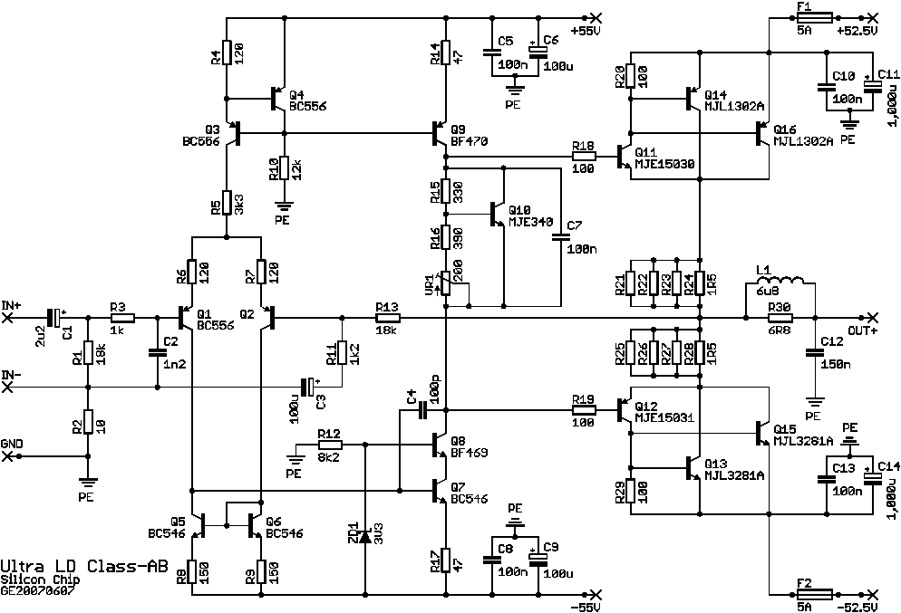

Remmber changing the Re's from 0.22 to 0.1 with change the bias, ie lower resistance, more current.
Yeeessss.... weeelllll...... I admit it, I've already been bitten by this once - the source of one more flaming SCULD. :hot: So I hopefully won't make the same mistake again!
Master Hugh told me that creating an amplifier graveyard is a necessary step in the learning process. So does that mean the amplifier massacre I've been engaged in over the last week mean I must be very educated by now? 😉

Taps? NOT!
I use thread cutting screws. Just drill the right size hole and drive them in.
FWIW:
British Standard tap drill size for a 3.0mm coarse thread is 2.5mm, or 2.55 with less radial engagement. I guess if you use 2.7mm, the likelihood of tap breakage is much less, but so is the engagement.
I find the easiest way to ensure full, square threads this small is to fit the tap into the bench drill chuck, and the work on the table, in a vise if necessary. Don’t power on; rotate the chuck by hand while gently pulling on the lever. I usually carry on this way until the required thread depth is achieved, but once the thread is well started, you could of course release the tap from the chuck with the tap still in the material, and carry on with the tap wrench.
For aluminium, my cutting lubricant is common or garden white spirit.
Buy a plug tap to get the thread all the way down the hole, or grind away the taper on a normal taper tap (same thing but shorter).
And I don’t often use 3mm screws; I’ve still got hundreds of 6BA. 🙂

Today's update: replaced the emitter R's with 0R1's this morning (from 0R22's). I can't hear a difference, but the voltages are now less well matched and less stable. I've commented on this further in the 'ULD extreme' thread.
Since that didn't do anything much, this arvo I did the current mirror stuff - put in bc550c's with HFE>500, fixed the trannie matching in my 2nd amp using the extra trannies I bought yesterday, and adjusted the trimpot as described by Alex to get 0mV across the collectors (actually, 0.2mV, but that'll do I guess...)
I haven't done enough listening tests to comment on the result yet. Lots of listening to do tomorrow!
In case anyone's interested: I found quite an efficient way to do the transistor matching. I had 25 transistors of each type, so I put a 5x5 grid on a piece of foam - one piece per transistor type. I wrote the numbers 1-25 in the grid cells. I then opened a spreadsheet and put the numbers 1-25 down the first column. Then I put on my headset, and used voice recognition (e.g. Dragon Naturally Speaking, Vista speech recognition, or MS Office recognition) to speak the relevant measurements of each device as I tested them. After testing, I pressed the trannie into the foam in the next grid position. This saved lots of time, because I never had to move from my test equipment to write down the values - the process was just: grab trannie, test, speak, stick in foam. When I was done for one trannie type, I simply used the 'sort' command in the spreadsheet to sort by whatever I wanted to match on, and used the item numbers (1-25) in the first column to grab a pair from the foam. The foam pieces seem to be a good way to keep the remaining transistors safely; I've pasted the measurements to each one (with the removed trannies crossed out) so for the next project I'll be ready to go.
When replacing some transistors in the PCB, I must have used too much heat, because 2 of the pads became unstuck. 😡 What's the right way to fix this, after it's happened? In my case, I tried to get the best join I could, and then scraped back the track to show the copper underneath, and finally used a 'circuit writer' pen to draw over the copper and the component's lead. I'm not sure how reliable this will be in the long term. It seems to be working OK for now however...
When testing changes at Hugh's, life was made a lot easier by the fact that he has a variable autotransformer (i.e. like a Variac - but of his own design). It's probably not a viable option for me - big, expensive, and hard to find.
In looking around for alternatives, the only thing I've found is the 'dim bulb tester'. This is simply a regular household bulb in series before the transformer, with a switch to bypass it as required. Different wattage globes can be inserted to change the power to the circuit.
Is this a good method to test an amp without letting the smoke out? If so - does anyone have any tips on a suitable design (or is it just as simple as I described)? If not, are there any other alternatives? (The SC article suggests removing the fuses and sticking 0R68's there instead for testing, but that gets rather tiresome, and in my experience it's not enough to keep the smoke bottled up all the time).

jp_howard said:
I haven't seen something like that before - there's 2 separate windings attached to different bits of the circuit, is there? What does that do? How does it work?
Does the JLH add-on go on both rails? Are there 2 separate power supplies?
The separate front end psu was used in the earlier version "ULD100W" were there wasn't the ccs circuit for power supply ripple rejection.
The transformer had 2*35Vac secondary windings and an extra 2*15Vac 500mA windings.
the SC100Watt circuit is from there
http://www.diyaudio.com/forums/showthread.php?s=&threadid=103157&highlight=
The 35vac and 15vac and run in series to get 50vac then reg'd back to +/-55Vdc for the front end.
The outputs are not reg'd, just use the 35vac >bridge >caps to get the 52Vdc
Yes i modded the JLH for this too.
