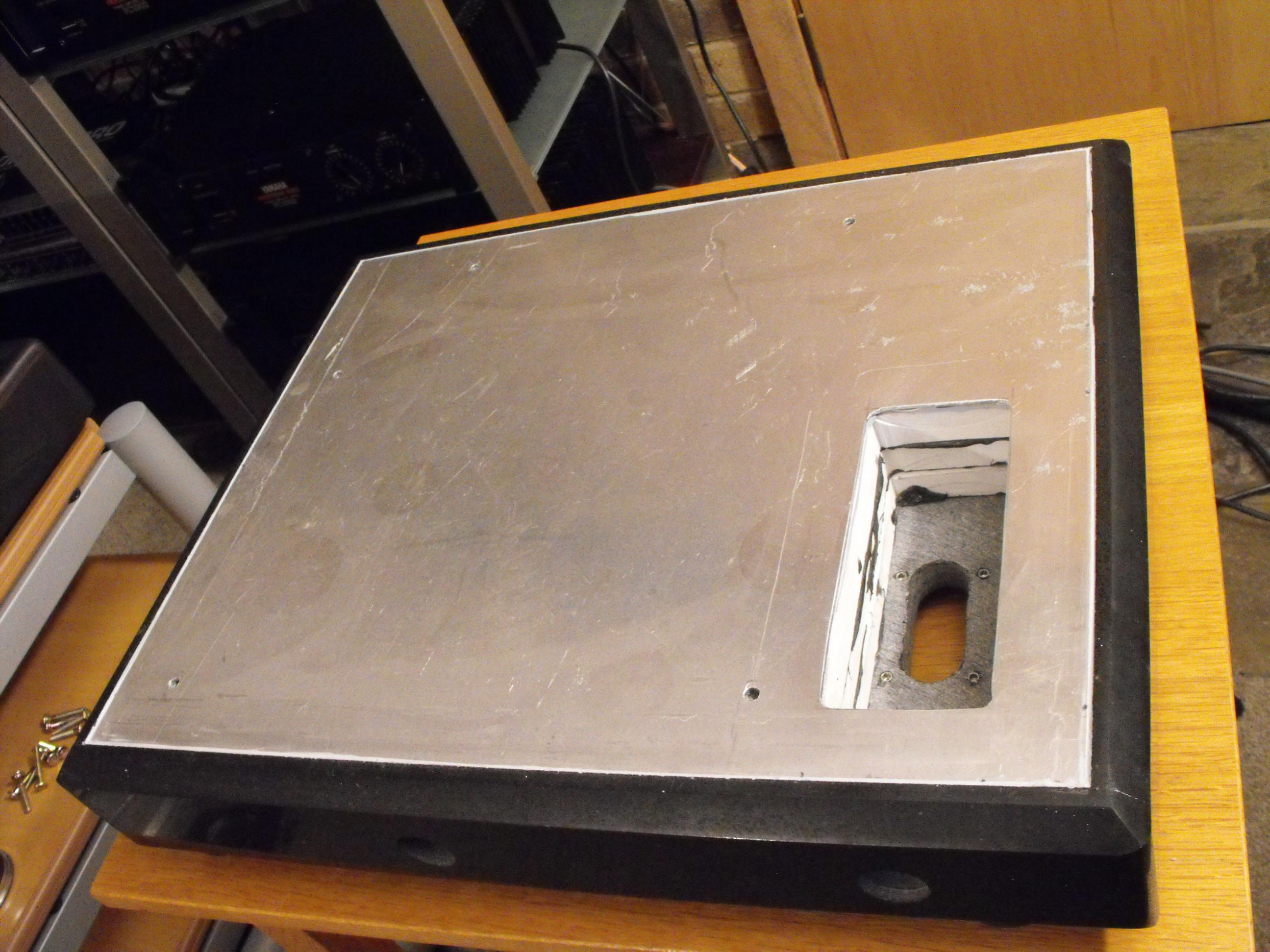

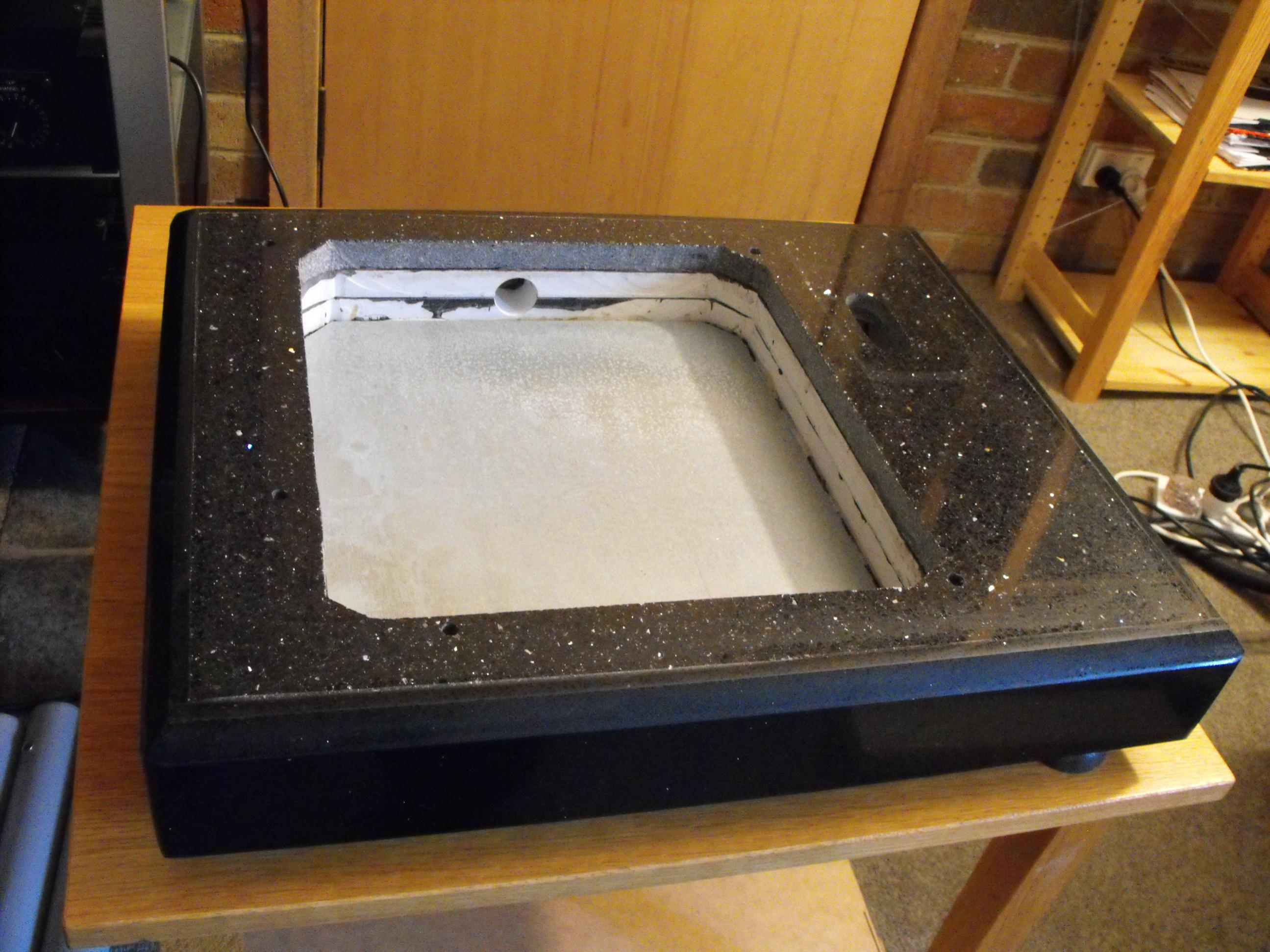

I have used a similar engineered stone, caesarstone, for turntable plinths. It was not an unqualified success. The requirements are similar to those of a speaker enclosure: stiffness and damping. The resulting construction was very stiff but poorly damped. The undamped engineered stone produced a ringing colouration. It was suppressed by a damping layer of silicone between the stone and aluminium sheet.
