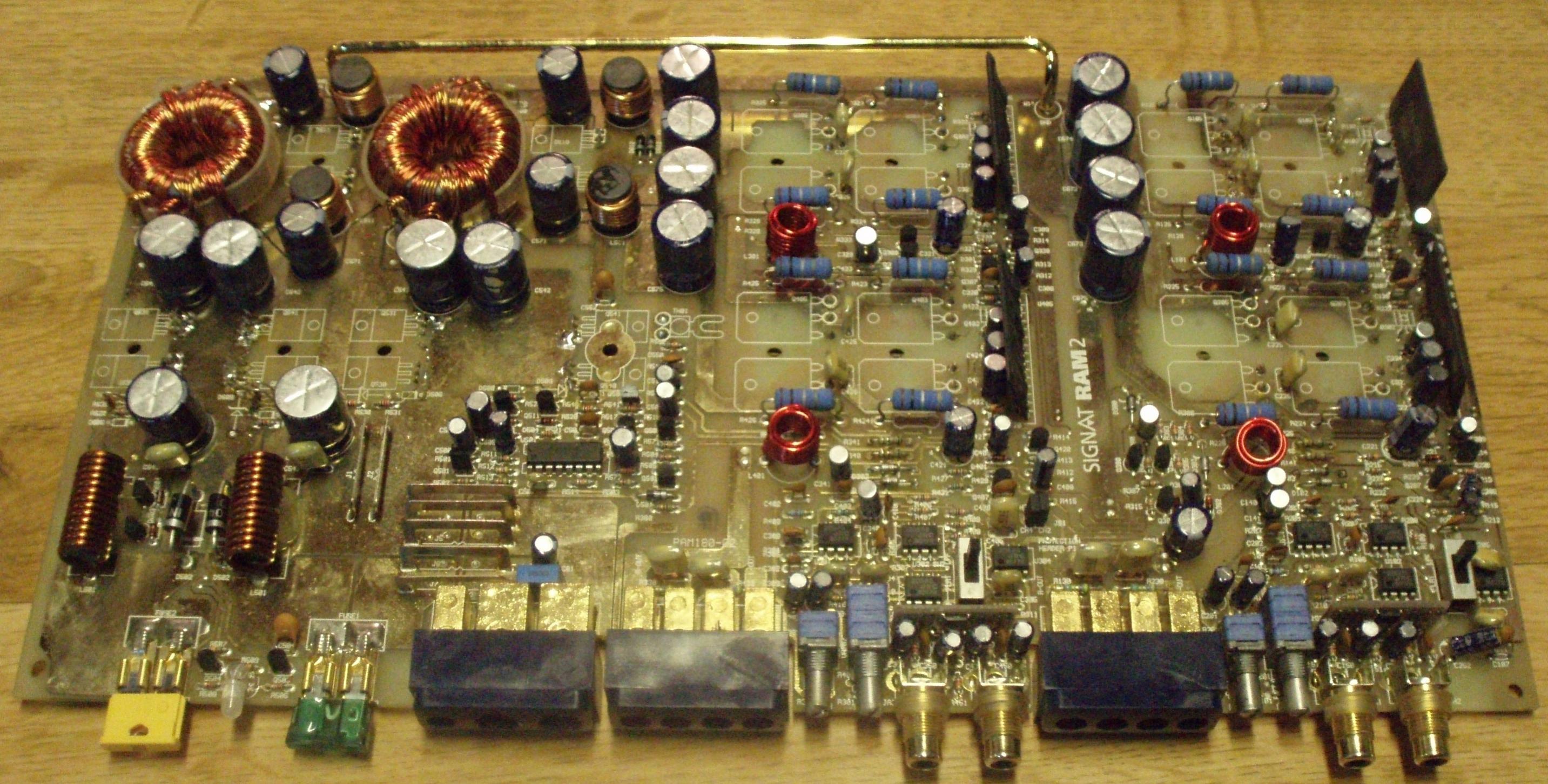

I have looked at these Signat amps and finally got the courage to buy a broken one. But now I do not know what to do with it.
I have narrowed the search down to one of four channels, when I remove outputs from it amp powers up and does not go into protect.
Outputs dont seem to be the fault, they test out fine out of the board, after installing new ones, amp still goes into protect.

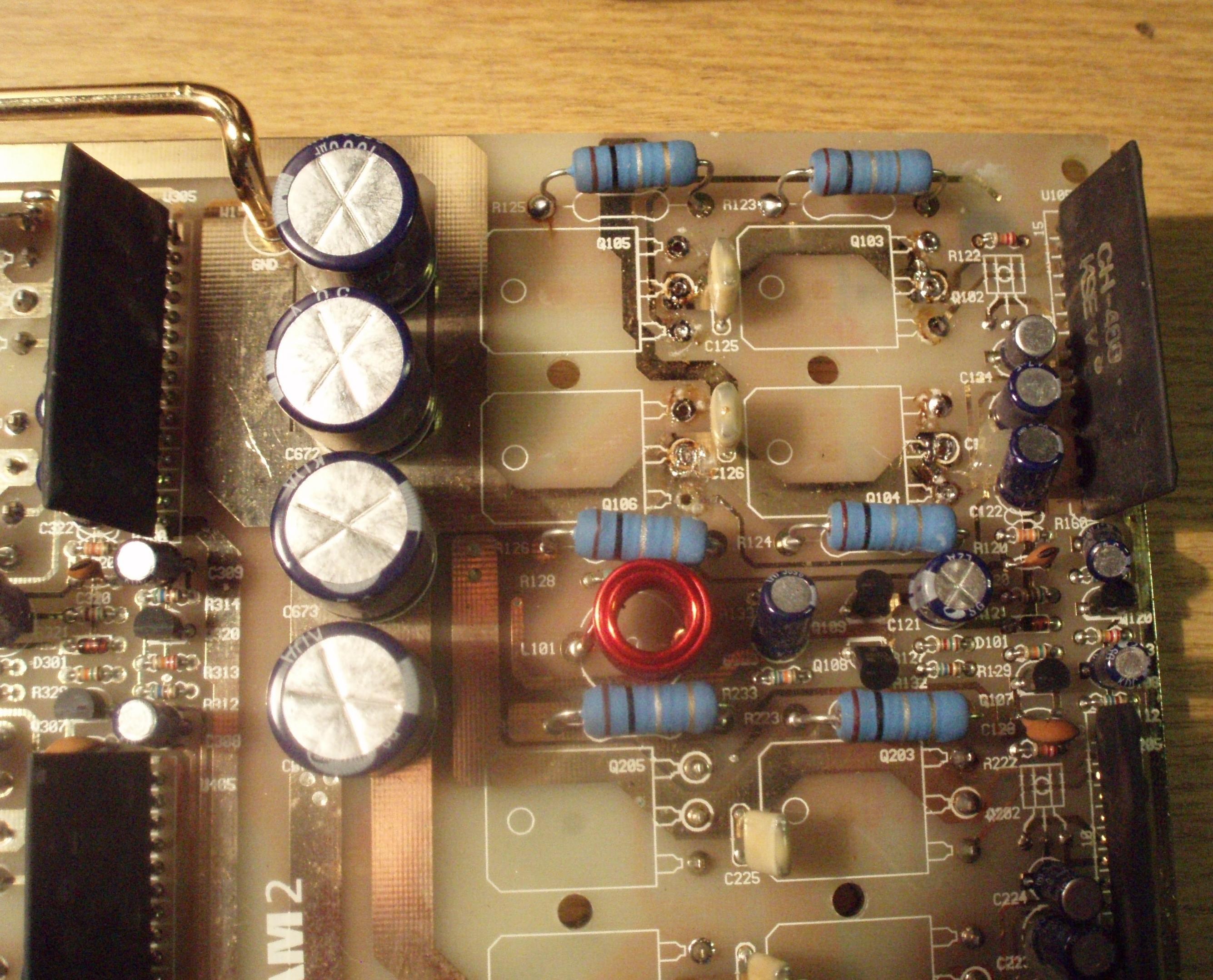

Protection on this amp works like in periods, it tries to power itself up in every 10 seconds. Measuring DC current on speaker terminals of the problematic channel shows that during this attempt to power up rail voltage appears on them and all three legs of all 4 outputs in that channel.
With outputs out of the circuit there is rail voltage on center solder pad for output transistors, no voltage on 1st and 3rd pad.
That would indicate that outputs were shorted but none of the 8 transistors I tried are shorted.
This amp uses custom driver chips/boards, could it be toast?

I have no experience with these but it's possible that the driver module is defective. You could swap the one from the defective channel to one of the good channel to see if the fault follows the module. Before you do that, you should confirm that the module drives the outputs directly. If it drives the outputs through driver transistors, check the driver transistors before swapping the modules.

There are only a few transistors per channel besides outputs, I did not find any shorted transistors.
But I guess I have to try and swap the modules because there is not much else I can do.

This time I managed without it and yes, moving the module to another channel made the symptoms go to another channel. So the module is defective.
