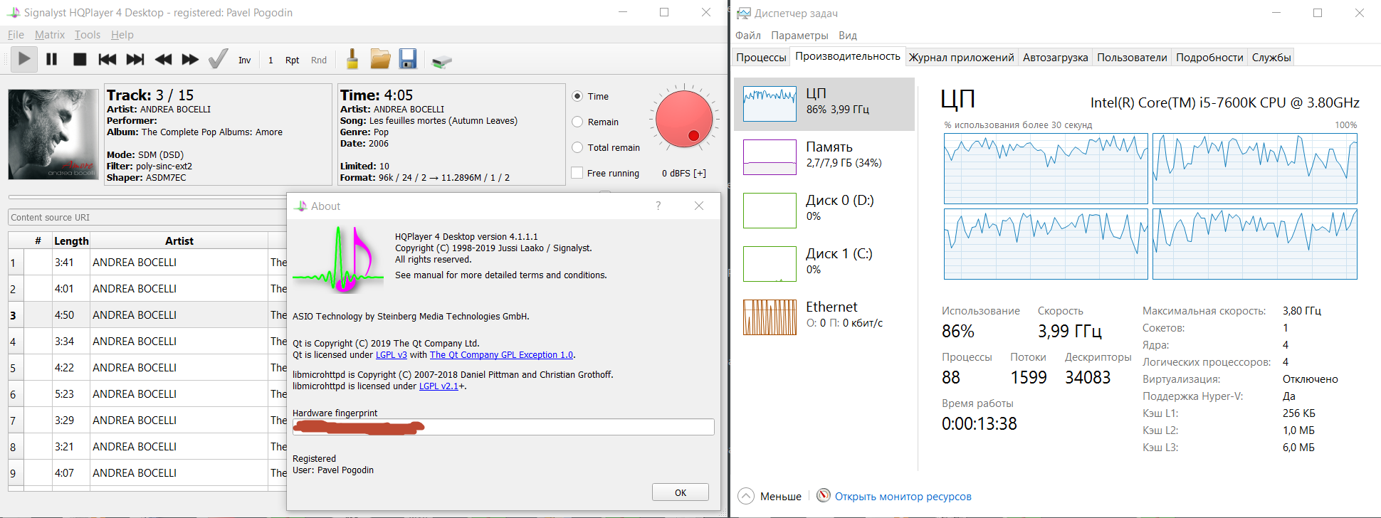

I5-7600K works fine for me without CUDA for ASDM7EC/poly-sinc-ext2/DSD256

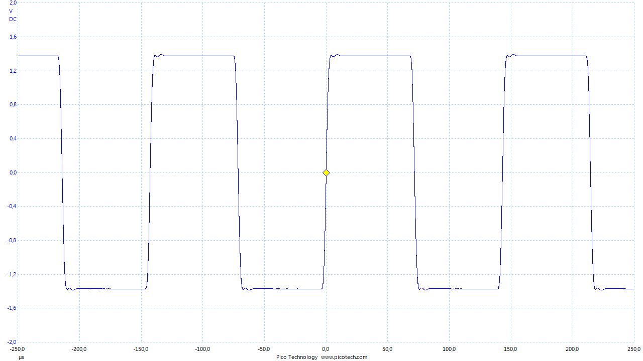

I chose to use bus termination resistor arrays because those are designed for exactly type of signal used here and accuracy is unimportant unless grossly off. I designed the 4th order analog post-filter to have minimum amount of overshoot on square waves. So 7 kHz square wave looks pretty decent compared to many typical DACs that you can commonly find on the market:
Which was one of my goals.
